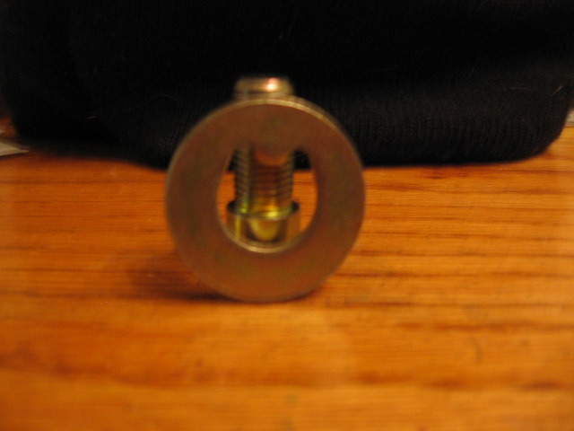

> 311.405.661, Thrust washer for the Front Suspension
A&PGirl
post Feb 26 2011, 11:23 AM
Posts: 1,019
Joined: 4-January 06
From: Oklahoma
Member No.: 5,367
PET 402-00 Pos. 34
Qty. 2
Special thrust washer for the front suspension. This goes under the nut that you have break loose when you remove the brake rotor or do any suspension work. It is cad/yellow plated. Appears to be available through Aircooled Volkswagen shops.
