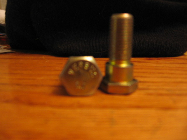

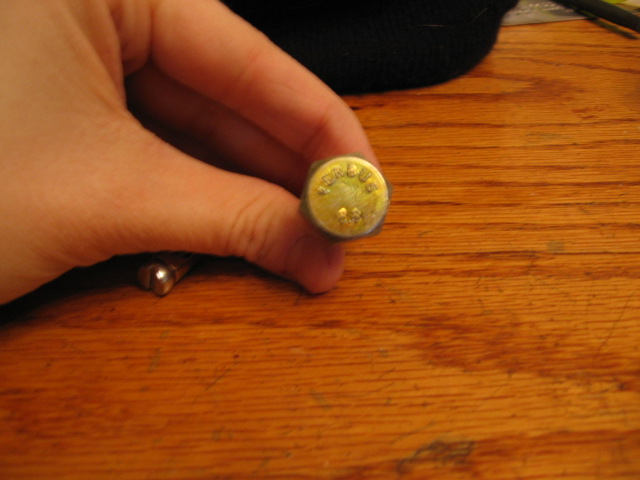

PET 812-00 Pos. 6, Pos. 9
Qty. Pos. 6: 2(Late 1974-1976), Pos. 9: 2(Late 1974-1976)
note: The PET catalog describes them as 'fastening screws'
note2: Early has a different part number
These are the bolts that connect the seatbelt into the sail panel and the long. They are only for cars 1974-1976. Original bolts have 'VERBUS' raised on the heads. Bolts are cad/yellow plated.
