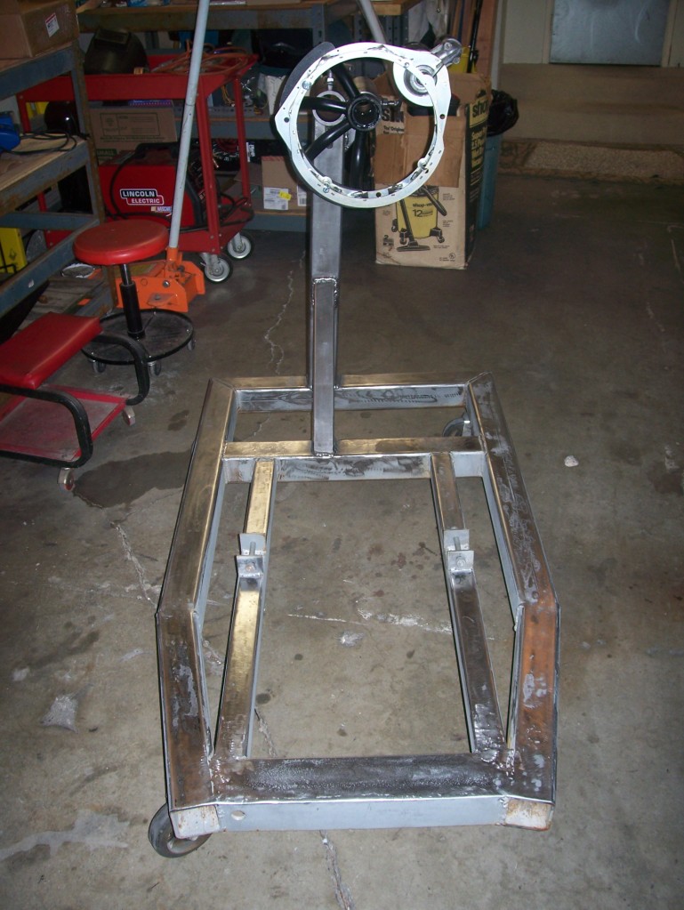

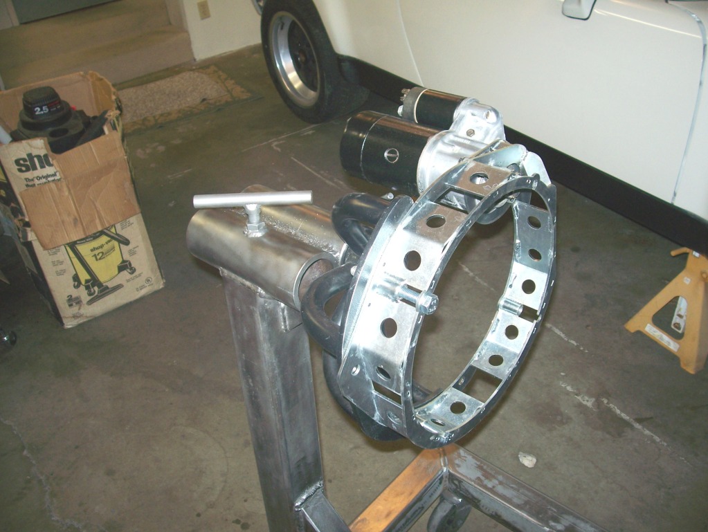

I ended up using one of these 4 bar yokes - good value!
adapter yoke
Then I added one of these adapter rings so I could start the engine on the stand. The ring allows you to connect a stock starter to the engine while it is on the stand.
adapter ring
It looks like this assembled:
(IMG:http://www.914world.com/bbs2/uploads_offsite/i954.photobucket.com-11663-1301368589.1.jpg)
(IMG:http://www.914world.com/bbs2/uploads_offsite/i954.photobucket.com-11663-1301368590.2.jpg)
(IMG:http://www.914world.com/bbs2/uploads_offsite/i954.photobucket.com-11663-1301368590.3.jpg)
I ended up not using that setup, so if you are interested in the ring (cost $199 plus tax) I would be willing to sell it for $125 plus $15 shipping.
Rob
PM me if interested.
