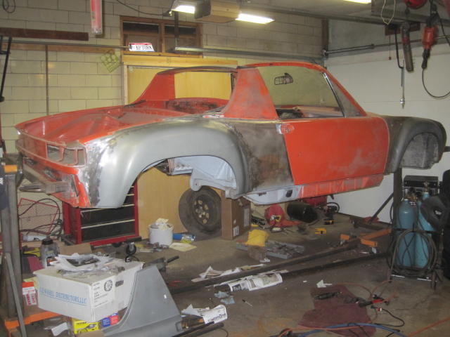

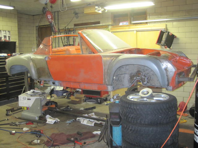

I am working on restoring a 1973 914 and converting it to a GT clone with the flares and chassis stiffening. Here is a picture of where I am on it.

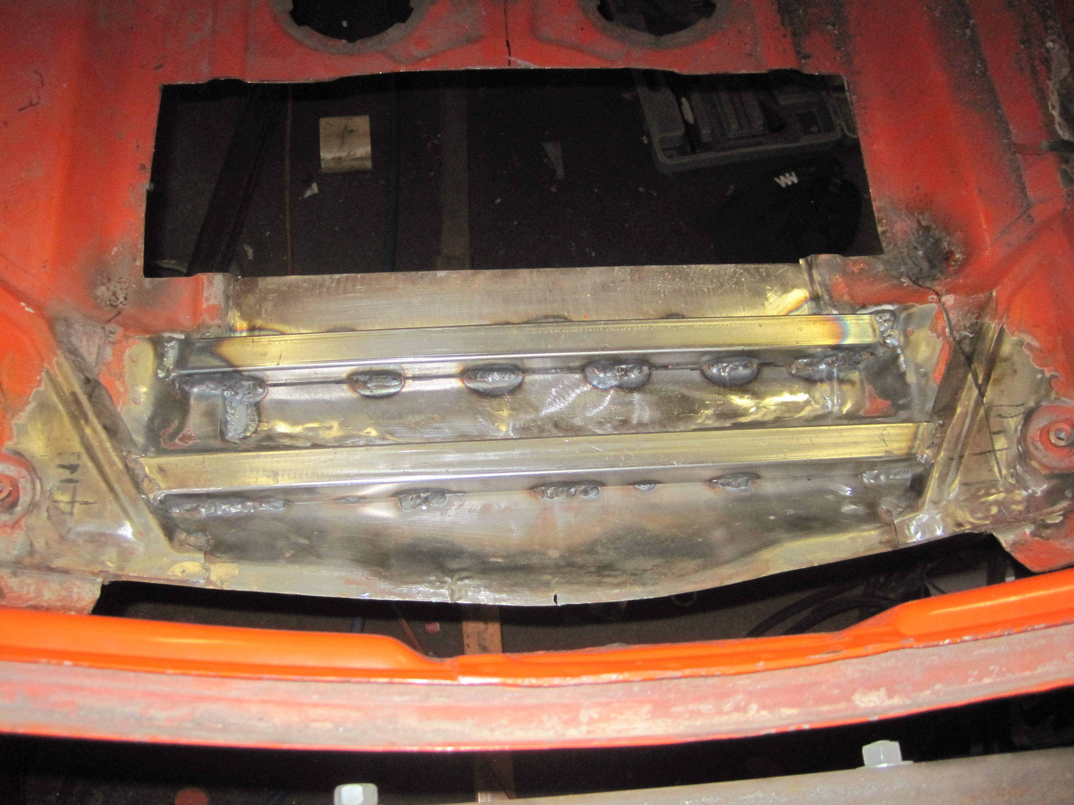

I have been working on the front of the car where the oil cooler will be going. I have studied all of the photos on Armando Serrano’s web site for many hours. This site is an amazing resource for GT info.
I cut open the front trunk area to get access to add the reinforcement bars and marked the area that needed to be opened up.
Then I custom fit the first reinforcement bar in.
Next I fit the filler panel and the second reinforcement bar in. Then I welded the filler panel in place.
Next I have to fabricate the oil cooler shroud which I am not looking forward to doing. I may move to the back of the car to do some more work there.
Jeff B
