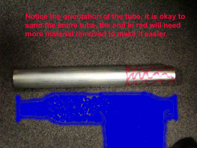

I was looking to press my bearing housings into the trailing arm this afternoon, but one end of the housing is machined down a little bit, and I can't find a mention of it in the directions. I'm assuming that it is cut down to help get it started in the arm easier, but don't want to screw it up if that's not why it's there. Anyone know what the deal is?

Sorry about that, here is a really bad description (IMG:style_emoticons/default/smile.gif)
