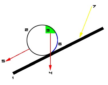

ok, time to dig out my physics degree and explain how the tire thing works. (Alfred (or jeff k. as he calls himself these days) will love this!).
1. is the ramp
2. is the tire
3. is the weight inside the tire. important, the weight has to be more or eaqual to the weight of the tire itself. i'll come back to that in just a sec.
4. the force vector for the weight, going straight down.
5. the force vector for the tire. trying to roll down the ramp. (also tries to go down, but we don't want to make it too complicated, do we)
6. the lenght of which the tire is going to move "uphill"
7. the point where it will come to rest
and here is how it works:
first, you need to get away from the obvious, a tire moving up a ramp on his own. you need to look behind that and "visualize" what is actually going on. (Alfred, still with me?).
to prefectly balance the tire on the ramp, the weight has to be placed with an offset to the tire's TDC that is eaqual to the angle of the ramp. (actually, not exactly because we also have some friction of the tire to the ramp). this will hold the tire in place. if the weight was less than the weight of the tire, the tire would be able to "spin" the weight around the TDC and the tire would roll down or the placement of the weight would have to be so far to the right that the amount traveled upwards would be insignificant.
now any additional force (like something hitting from the left) will make the setup unstable. the weight will start moving STRAIGHT DOWN. but because it is attached to the tire, this will result in a clockwise rotation of the tire. the weight actually still goes down, while the tire moves up on the ramp. the tire will stop moving when the weight comes as close to the ramp as possible (point 7). by then the tire will have traveled the distance of 6. up the ramp.
everybody still with me?
Andy
