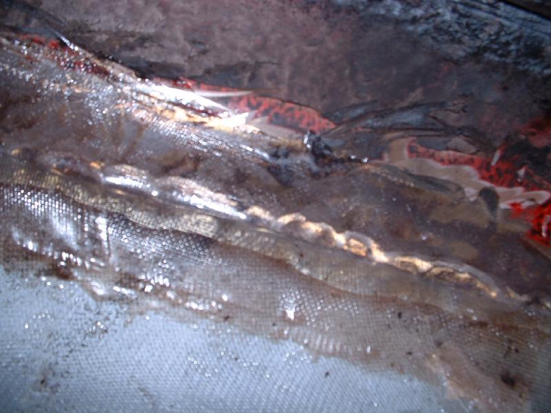

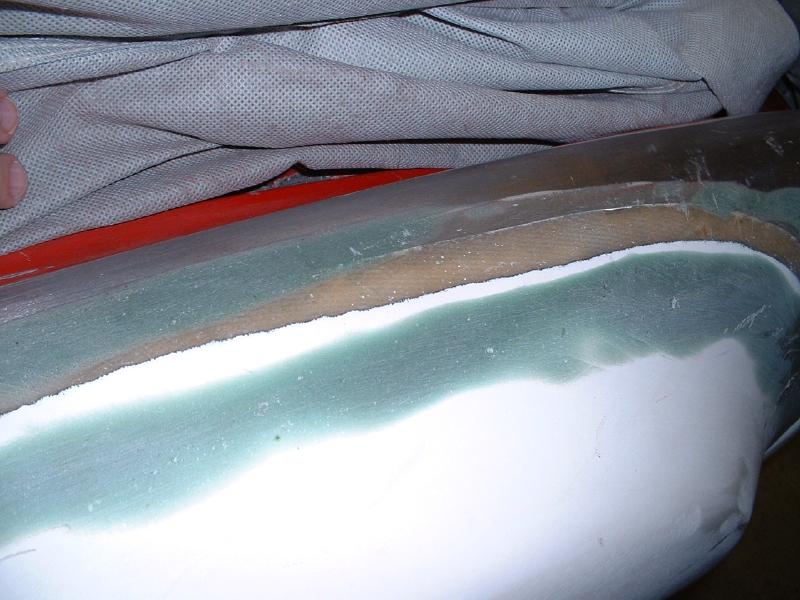

Front flare with bonding agent. You should be able to see the glass/bond/metal layers.

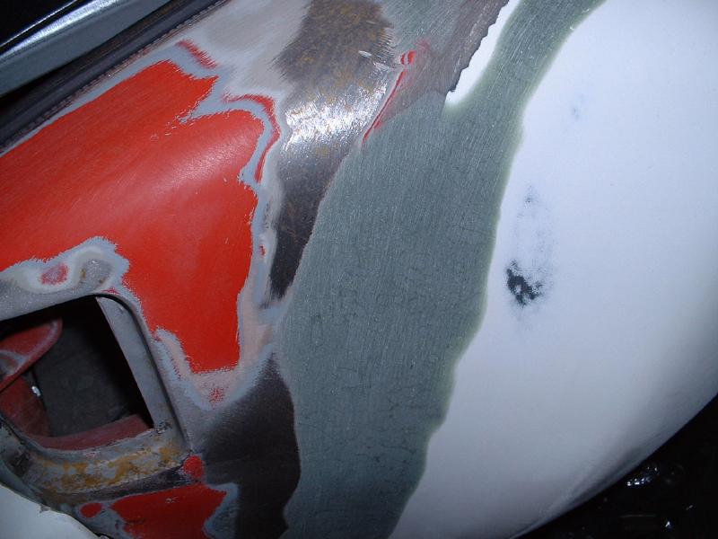

Here's the other front with a little MarGlass on it.

Here's an Andy shot of the inside of the front fender...

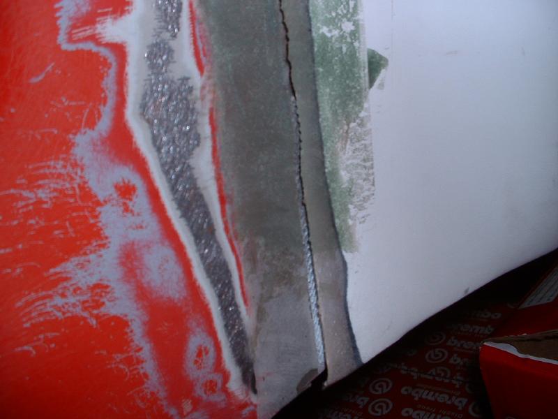

I didn't glass the backside of the rears and I started working at the base with a GT rocker. The GT rocker caught the flare and you can see what will happen if you fail to glass the backsides.

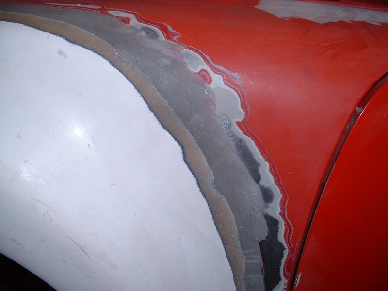

Here's a rear blended in fairly well with MarGlass

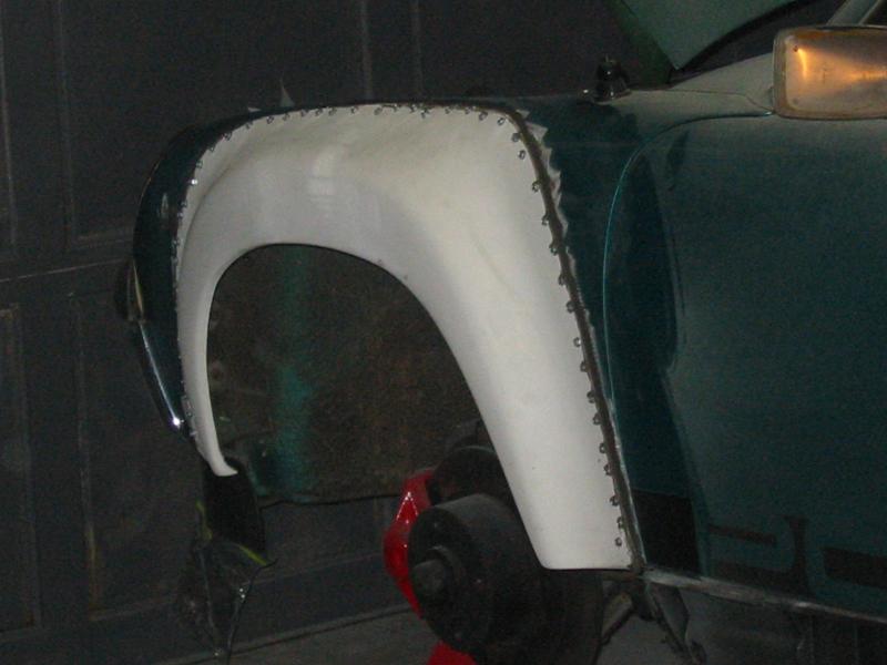

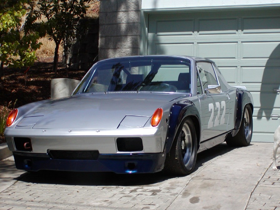

Fiber glass with rivets:
ein 6er

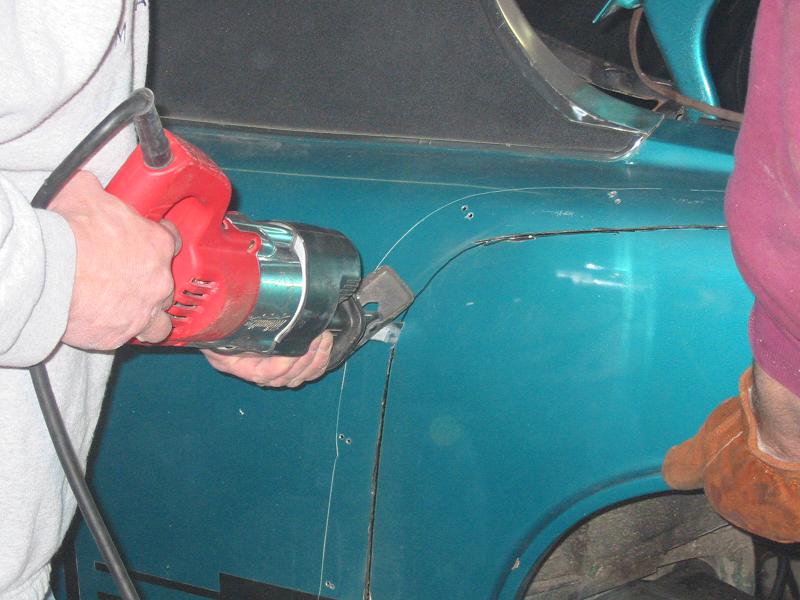

The sawsall.

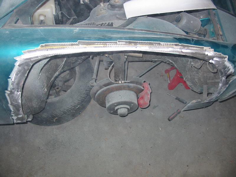

the hole
lmcchesney
post May 26 2004, 07:14 PM
Posts: 488
Joined: 24-November 03
From: Ocala, Fl.
Member No.: 1,381

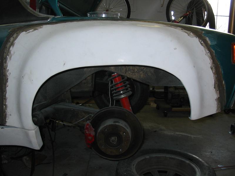

rear flare. Don't forget to fill in the inner wheel well between the fiberglass flare and the steel fender. Use fiberglass resin or bondo depending on desired weight.

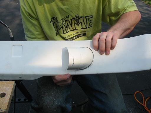

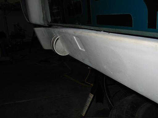

Might consider adding a cold air scoup in the rocker panels like my Andrew has done.
lmcchesney
post May 26 2004, 07:18 PM
Posts: 488
From: Ocala, Fl.
Member No.: 1,381
Scoup in place. We tested it prior to placement. It really does capture significant air. The air is directed to an oil cooler on one side and hosed into the engine compartment on the other side.
