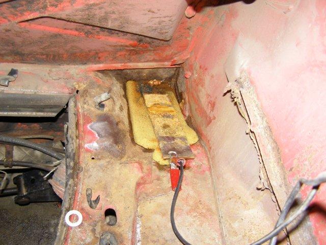

Before, I've seen much worse:
(IMG:http://www.914world.com/bbs2/uploads_offsite/oh1xza.bay.livefilestore.com-9685-1305733262.1.jpg)
Grabbed some sponges from the local hardware store (tile section) and cut them into about 1/2" strips:
(IMG:http://www.914world.com/bbs2/uploads_offsite/oh1xza.bay.livefilestore.com-9685-1305733263.2.jpg)

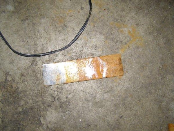

Throw a strap of 2" 14 gauge steel on it (it was a scrap from the tranny mounts I'm working on) and hook it up to electricicals:
(IMG:http://www.914world.com/bbs2/uploads_offsite/oh1xza.bay.livefilestore.com-9685-1305733263.3.jpg)

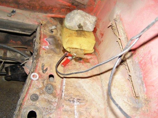

Cover it up with a full sized sponge, wet the whole mess with washing soda mix and stick a rock on it to compress away any gaps:
(IMG:http://www.914world.com/bbs2/uploads_offsite/oh1xza.bay.livefilestore.com-9685-1305733263.4.jpg)

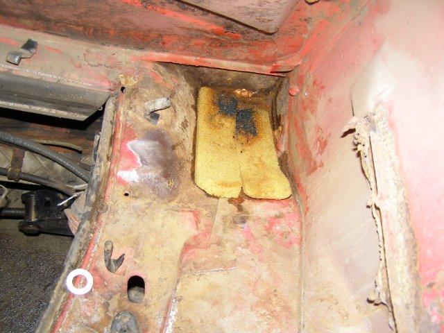

15 minutes worth of cooking:
(IMG:http://www.914world.com/bbs2/uploads_offsite/oh1xza.bay.livefilestore.com-9685-1305733264.5.jpg)

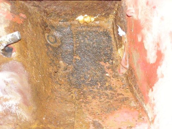

After cooking about 4 total hours. I have maybe 10 minutes actual work into this:
(IMG:http://www.914world.com/bbs2/uploads_offsite/oh1xza.bay.livefilestore.com-9685-1305745009.1.jpg)
It's pitted to all get out and I'll have to address that, but that big blackish spot in the middle isn't rust (IMG:style_emoticons/default/wink.gif)

Actuallly, if you do it long enough, the black turns to slime that can be brushed off with a wire brush. I like the copper bristle brushes as they seem just about right. You need a lot more time with that sponge or you need to fill the drain hole, fill it with solution and float the positive electrode over that hell hole on a foam block.
With the big tanks, foam floats can float the positive anode over the part. Was able to clean my 48 inch mower deck that way by moving the float. Took about a week.
When you are done, the metal is bare and gray, and you can actually see the rust pits are conical. It's those conical pits that prevent sandblasted sand from getting all the way in to the root of the rust cell.
