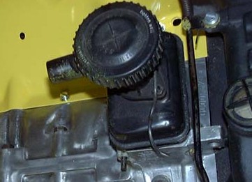

skline
post May 30 2004, 06:42 AM
Born to Drive
Posts: 7,910
Joined: 26-December 02
From: Costa Mesa, CA
Member No.: 17

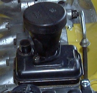

Here is a picture of a 1.8 liter oil filler box, notive the hose connection on the spout and not on the body of the filler box itself. The 1.7 and 2 liter had different injection and had it on the body of the box and not the filler spout. The next picture is the one from a 2 liter or 1.7 liter engine.
skline
post May 30 2004, 06:43 AM
Born to Drive
Posts: 7,910
Member No.: 17
2.0 liter box

QUOTE(Levi @ May 29 2004, 11:10 PM)
Well I'm not sure what your trying to tell me.
what i am trying to tell you is that there are two versions of what skline calls the "2.0L Filler Box".
see picture below ...
you have to take the whole box off (snap on spring) and look at the underside.
where the red arrow is pointed you'll either see :
1. one or more holes with very visible metal mesh behind
2. a PCV valve
if you have the PCV valve AND the hose is connected to the TB AND it's only running good when you remove the cap, your PCV valve is STUCK!
Bleyseng
post May 30 2004, 08:38 AM
Aircooled Baby!
Posts: 13,036
Joined: 27-December 02
Member No.: 24
That is a oil filler off a 75-76 Djet car. They also had the smog stuff.
On 73-74 2.0l cars the small tube welded to next to the filler is where the PCV is.
Geoff

QUOTE(skline @ May 30 2004, 04:42 AM)
Yup this is mine..... its still the 74 1.8 L-Jet.. (IMG:style_emoticons/default/laugh.gif)
