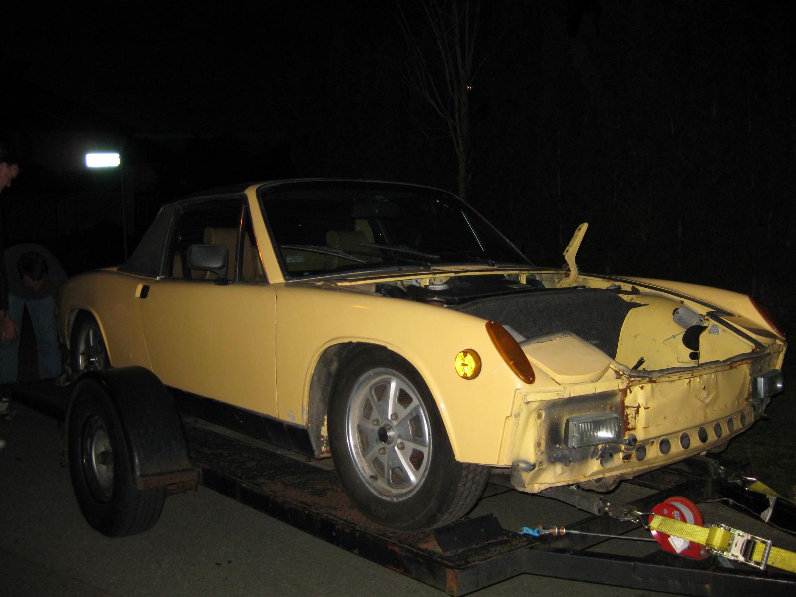

The story on the car is that it was from Washington and the PO had bought it with the intension of making it his next project. He already had one but had the bug bad. He ran into a little storage problem so, we made a deal and I drove up to pick it up.
Had it on the trailer before checking the VIN against the title and Houston, we have a problem! the VIN's on the car didn't match the title. Freaking great!

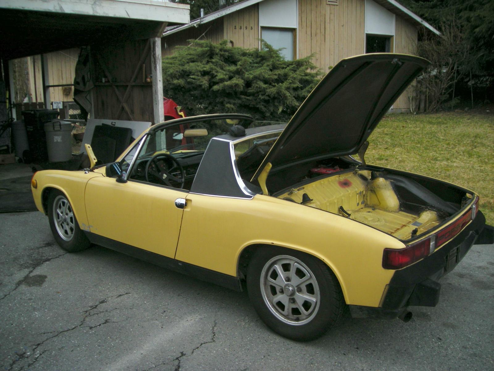

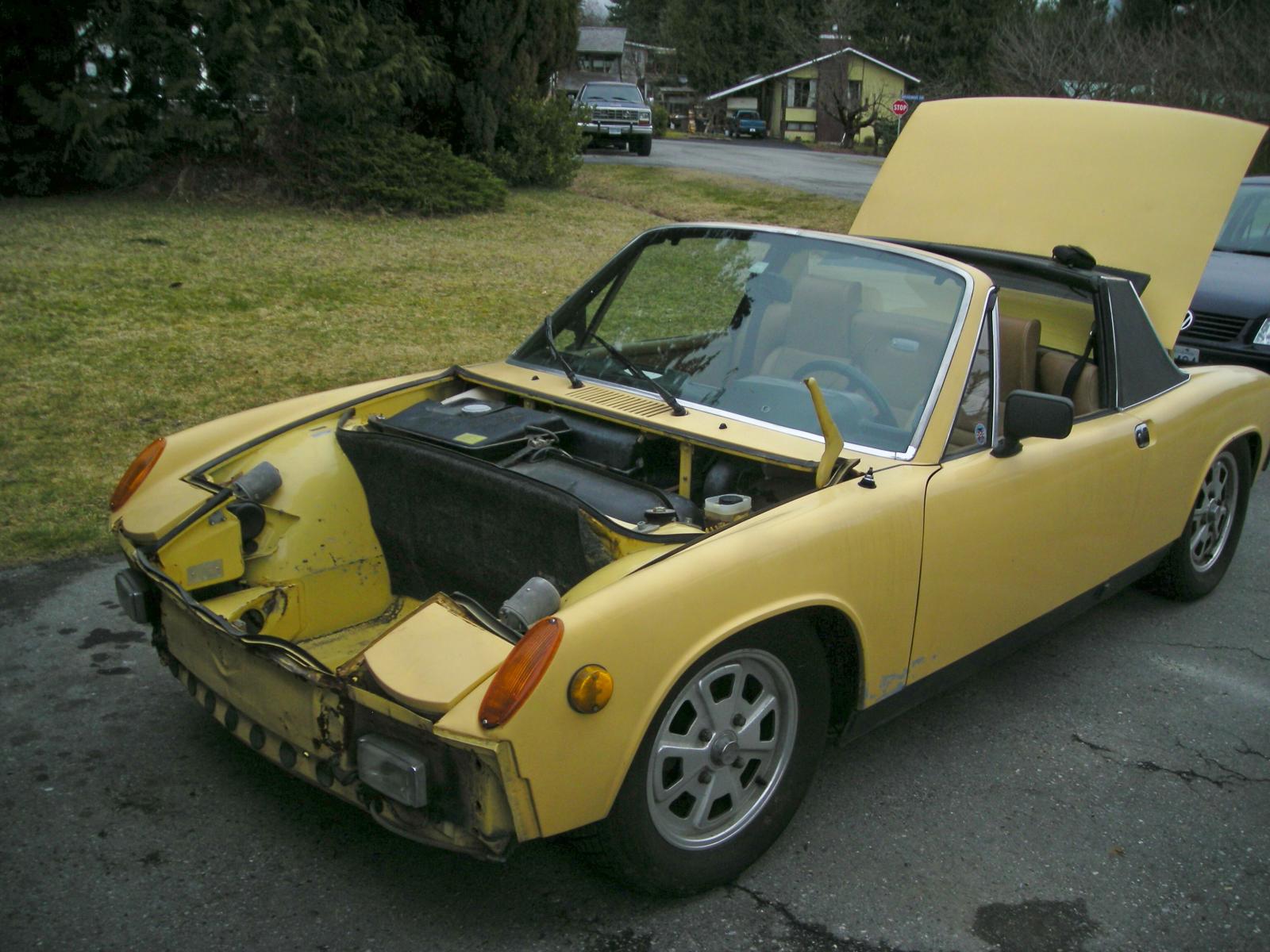

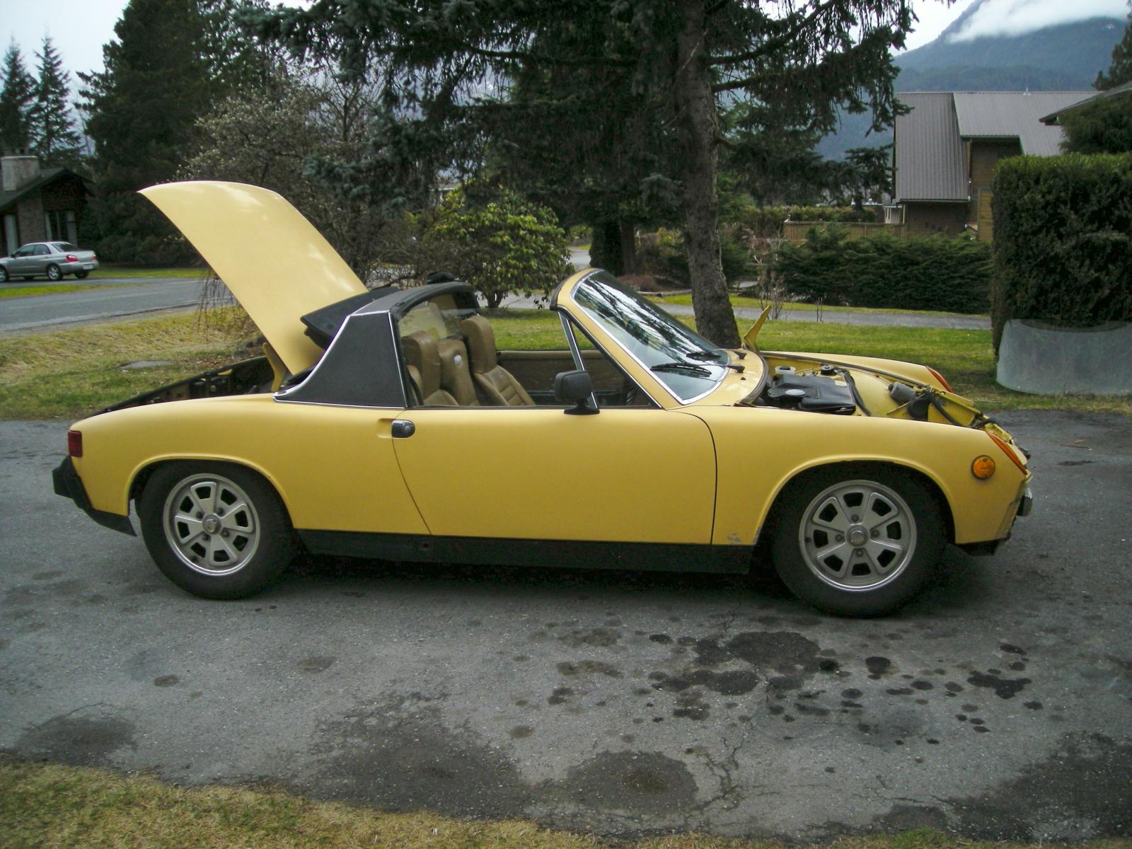

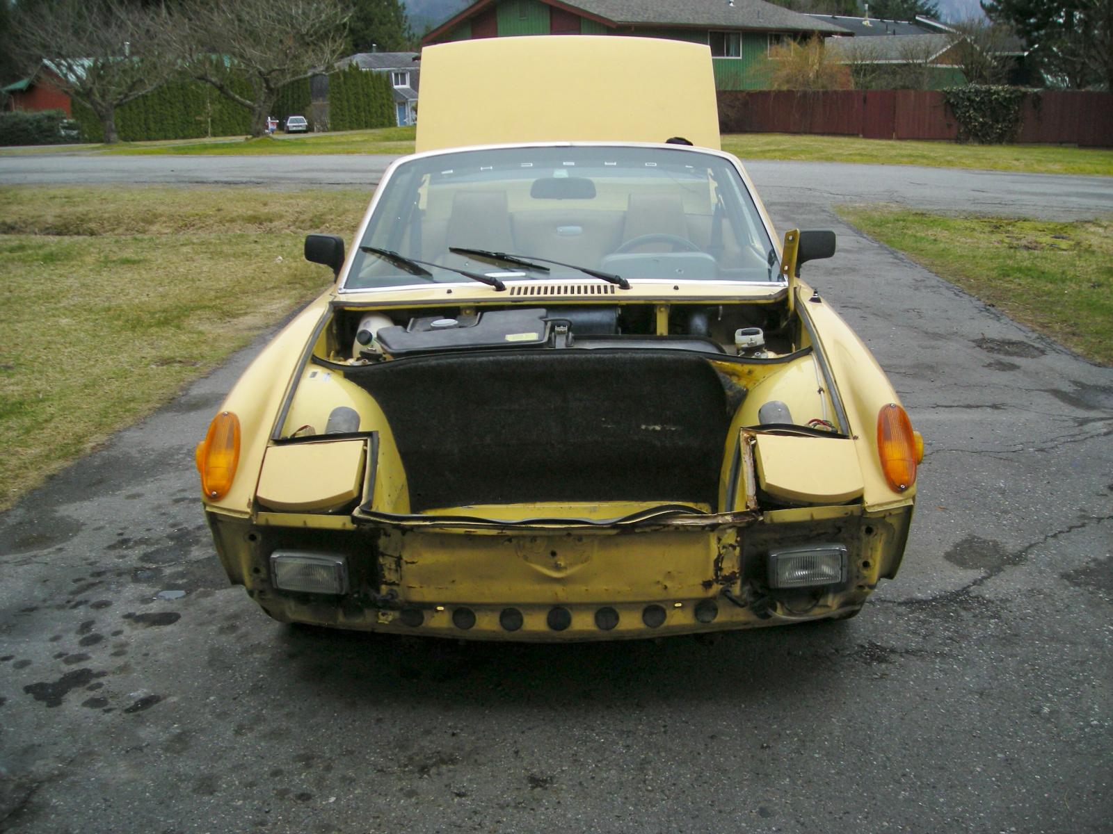

The details on the car are: 74' 2.0 Tan interior but sporting a 98 colour code and with some investigation was found to be Porsche 516 Sahara Beige. Frankly a Blaaa colour that the 74' Carerra's used.
The body was amazingly solid in all the spots I had been warned about. It was obvious that it had been in an MVA and rear ended someone. the front bulkhead was toast and the light boxes where bent. It was missing a hood and the seal channel by the windshield was damaged by the hinges in the accident.
The issue with the VIN was just beginning!

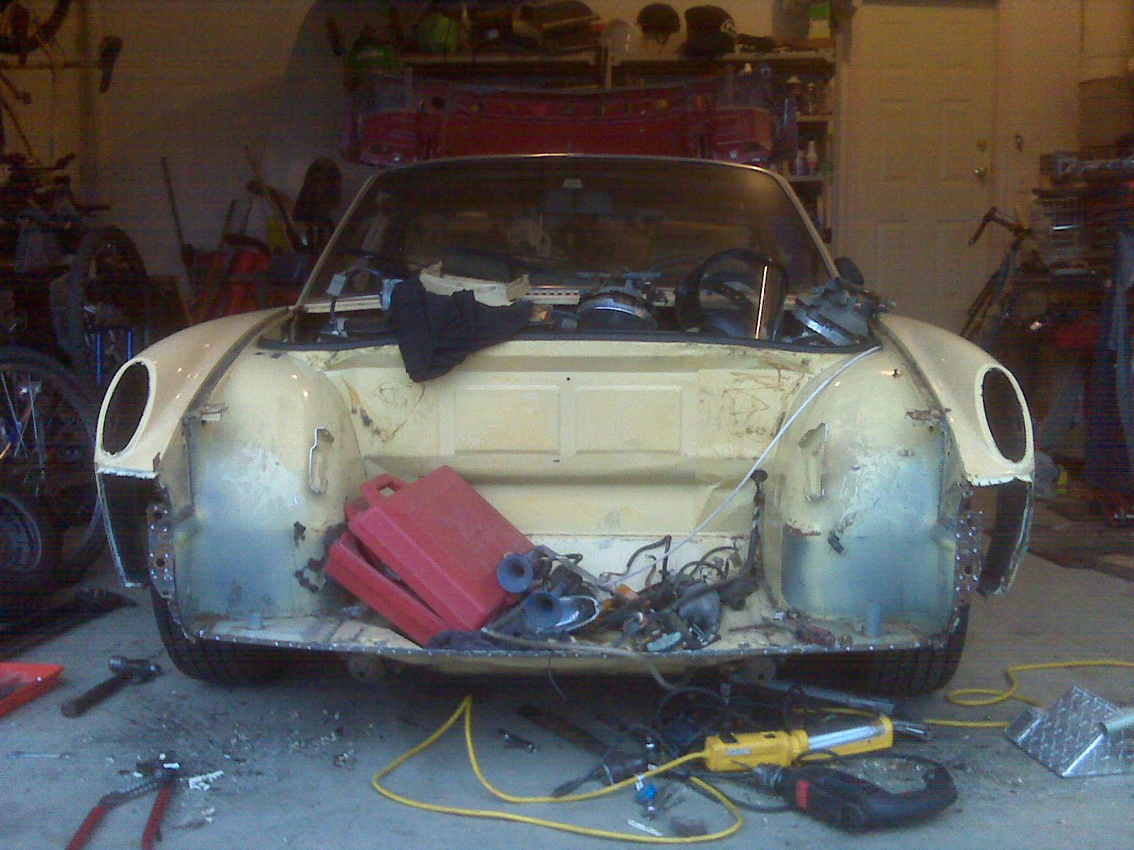

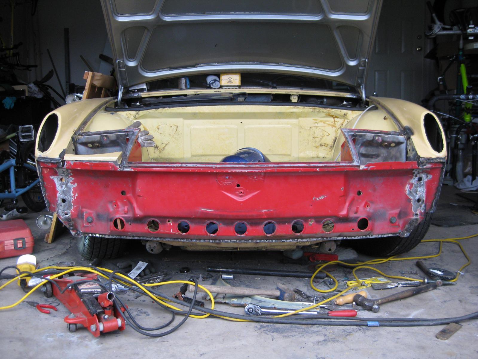

First order of business, New bulkhead and my first experience with drilling out spot welds and what seemed like hundreds
The tricky part was making sure the hood would line up when everything was welded together. I spent hours looking for pictures of bulkhead/hood alignment.
When It was done, it was close to perfect.

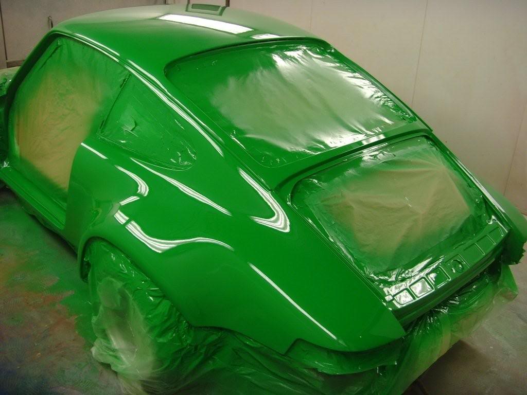

Just so the purist aren't too shocked...I can't live with the original colour. It's just not me! I've owned alot of cars but none are "Beige" She's going to be Viper/Emerald Green.

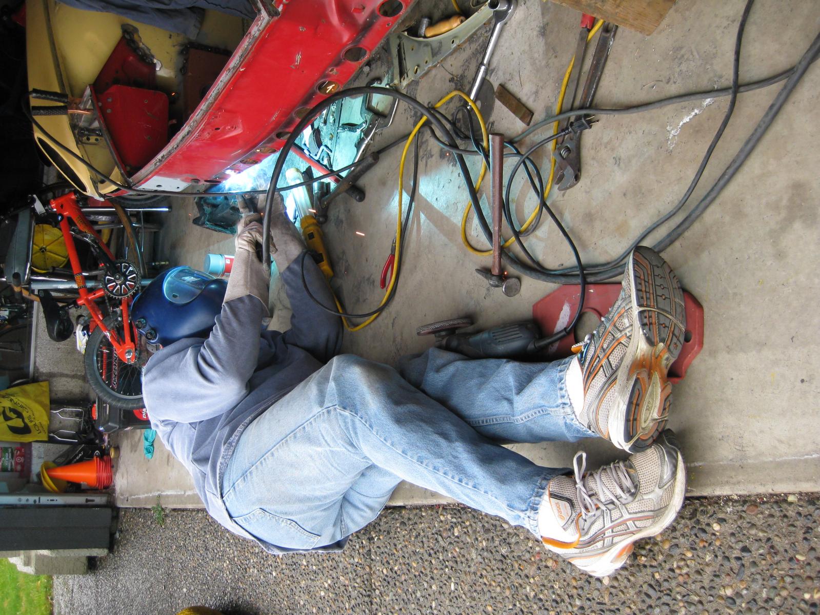

Just in case you wondered if I was having fun.... here's me laying on the cold cement making sparks... that smell is burning flesh
