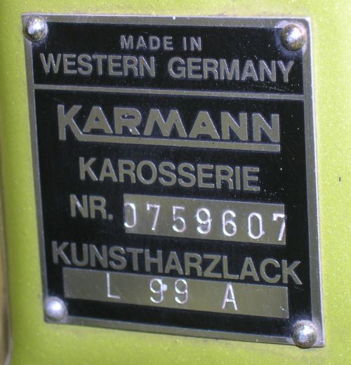

  • For '70 - '74 914-4 cars the Chassis Number is stamped on the "Karmann" plate that is attached to the drivers-side front door jamb. It's a small black plate that also has your paint code on it. In the example below, the Chassis Number is 0759607.

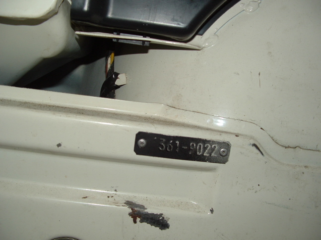

  • For '75 - '76 914-4 cars the Chassis Number is also on a small tag riveted to the passenger side headlight support. In the example below, the Chassis Number is 361-9022.

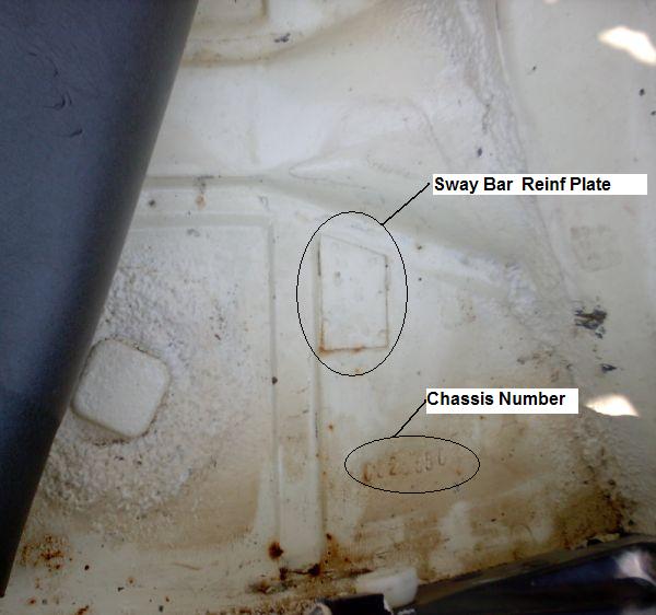

  • The Chassis Number is stamped into your rear trunk floor, either in front of the rear trunk lock (early cars) or to the right of it (later models), in front of the passenger side tail-light.

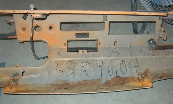

  • The Chassis Number is handwritten on the backside of your dashboard subframe.

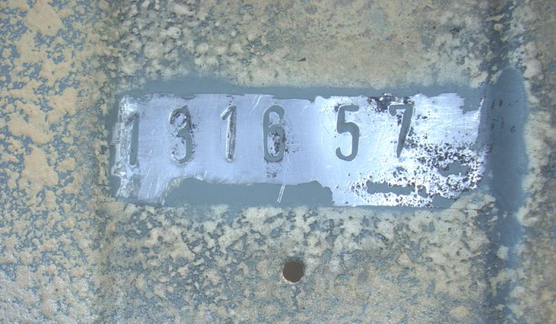

Yes it's a 70 914-6 the porsche number is 9140431617 heres a shot of the Karman number [131657] and it's located in the center of the trunk floor. I remember reading a post about decodeg it and it had something to do with the month and day the body was made, but I can't find that post again. .

Yeah, I found a very long post late last night that Dave did on this subject. . In essence, he was compiling numbers to try and figure it out. . . the post went on for a long period but the end was that the last four digits were always close [within 50 numbers ] of the Porsche Vin. . . nothing about what the first 2 digits '13' meant,
I found my transmission number was 1656, one from the Karman 1657 number and wonder if other sixes are that close ??
