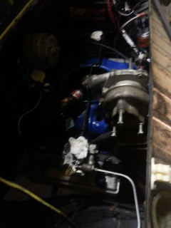

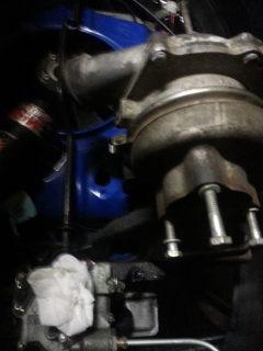

Update....
Engine mount is complete. (IMG:style_emoticons/default/piratenanner.gif)
Shift linkage installed. (IMG:style_emoticons/default/piratenanner.gif) (IMG:style_emoticons/default/piratenanner.gif)
Get all gears. (IMG:style_emoticons/default/piratenanner.gif) (IMG:style_emoticons/default/piratenanner.gif) (IMG:style_emoticons/default/piratenanner.gif)
Clutch works and is adjusted. (IMG:style_emoticons/default/piratenanner.gif) (IMG:style_emoticons/default/piratenanner.gif) (IMG:style_emoticons/default/piratenanner.gif) (IMG:style_emoticons/default/piratenanner.gif)
Speedometer hooked up and working. (IMG:style_emoticons/default/piratenanner.gif) (IMG:style_emoticons/default/piratenanner.gif) (IMG:style_emoticons/default/piratenanner.gif) (IMG:style_emoticons/default/piratenanner.gif) (IMG:style_emoticons/default/piratenanner.gif)
Accelerator hooked up. (IMG:style_emoticons/default/piratenanner.gif) (IMG:style_emoticons/default/piratenanner.gif) (IMG:style_emoticons/default/piratenanner.gif) (IMG:style_emoticons/default/piratenanner.gif) (IMG:style_emoticons/default/piratenanner.gif) (IMG:style_emoticons/default/piratenanner.gif)
Axles and CV joints in and safety wired. (IMG:style_emoticons/default/piratenanner.gif) (IMG:style_emoticons/default/piratenanner.gif) (IMG:style_emoticons/default/piratenanner.gif) (IMG:style_emoticons/default/piratenanner.gif) (IMG:style_emoticons/default/piratenanner.gif) (IMG:style_emoticons/default/piratenanner.gif)
Turbo is fitted and installed. (IMG:style_emoticons/default/piratenanner.gif) (IMG:style_emoticons/default/piratenanner.gif) (IMG:style_emoticons/default/piratenanner.gif) (IMG:style_emoticons/default/piratenanner.gif) (IMG:style_emoticons/default/piratenanner.gif) (IMG:style_emoticons/default/piratenanner.gif) (IMG:style_emoticons/default/piratenanner.gif) (IMG:style_emoticons/default/piratenanner.gif)
(IMG:http://www.914world.com/bbs2/uploads_offsite/i384.photobucket.com-9514-1363408803.1.jpg)
(IMG:http://www.914world.com/bbs2/uploads_offsite/i384.photobucket.com-9514-1363408803.2.jpg)
Car can move under its own power now! Have not tested it fully yet as it keeps snowing here. (IMG:style_emoticons/default/dry.gif) Engine tin and exhaust are next. Then some clean up of wires and then the interior. I can see the light at the end of the tunnel. (IMG:style_emoticons/default/cheer.gif) (hopefully its not a train. (IMG:style_emoticons/default/biggrin.gif) )
