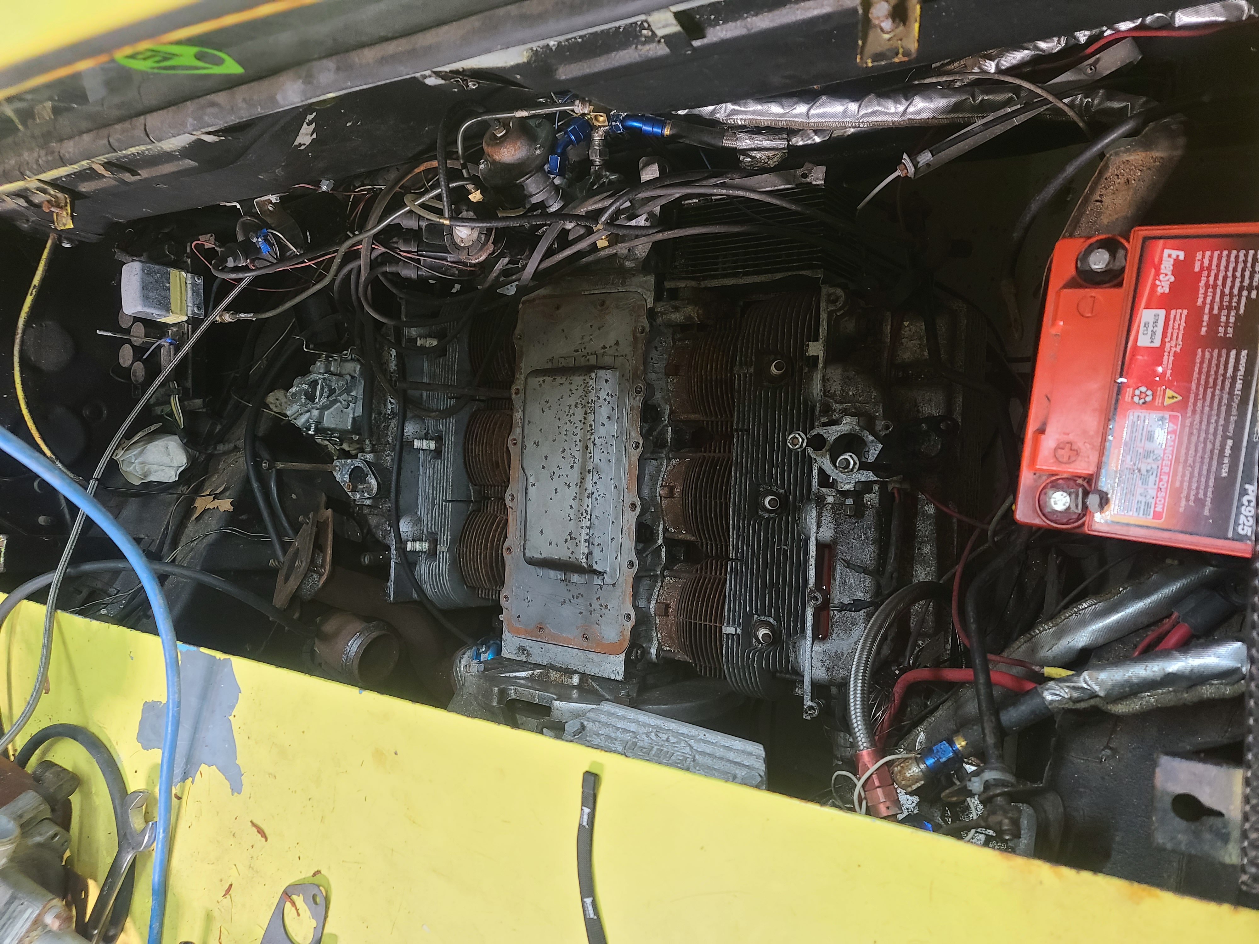

914coop
post Jan 31 2021, 08:11 PM
Post #169
Posts: 214
Joined: 5-September 08
From: Minneapolis
Member No.: 9,514
(IMG:style_emoticons/default/dry.gif) dupAttached Image
