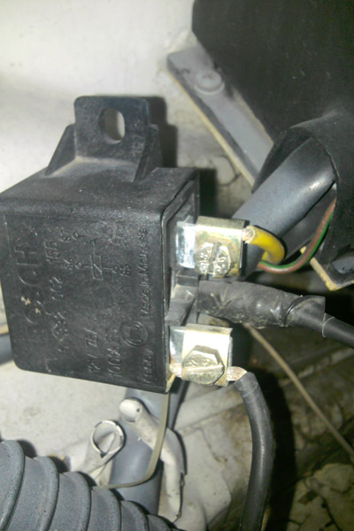

Confusing issue which has been compounded by frequent torential rain and being on-call with 15+ hour days. Short back ground.... Steve and I were attempting to get my valves adjusted which was cut short by heavy rain. When I attempted to start the car later, nothing would happen. The battery seems good. Lights and accessories work. The starter can be manually jumped but I can't get action from the starter by using the ignition switch. The only thing I did out of the ordinary was absent mindedly leave the key switched one click up to unlock the wheel and left it that way for a while but not so far the fuel pump was running. I don't think that would cause an issue but figued I'd throw it in there. There are also two what looks like relays of some sort which I hope someone can clue me in on. The one in the pic is the one up top and the other one not pictured but looks very similar is wired to the starter. I should also add it's a standard points setup.

poorsche914   ... Saturday will be the earliest I could look at ...   Jun 22 2011, 09:47 PM

detoxcowboy   Common and re-occuring issue of failing ignition s...   Jun 25 2011, 12:28 AM
poorsche914   OK... we are working on this now but while the eng...   Jun 25 2011, 07:55 AM
poorsche914   Start issue "possibly" resolved... found...   Jun 25 2011, 08:12 AM

poorsche914   Thanks for all the suggestions. The non-start prob...   Jun 25 2011, 10:37 AM

poorsche914   detoxcowboy - we lucked out and found a wire had c...   Jun 25 2011, 12:14 PM
