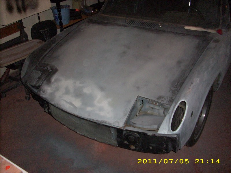

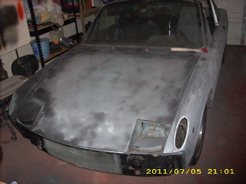

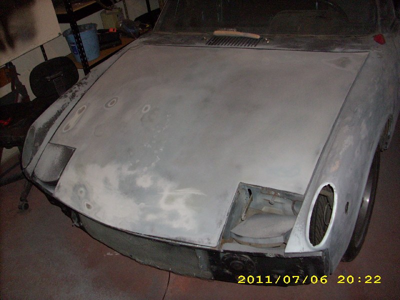

Got 1/2 hour of work in tonight and stripped the hood with 80 grit. There are two rock chips that need to be taken care of but the rest of the hood is nice and shouldnt take much work.
Loads of paint... I think the hood took a rattle can in itself.
Andyrew

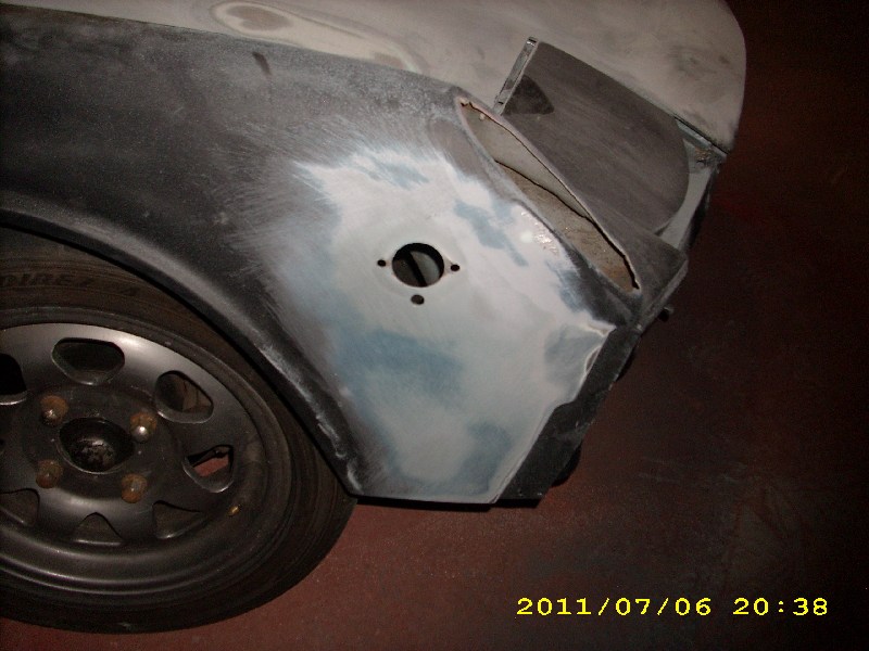

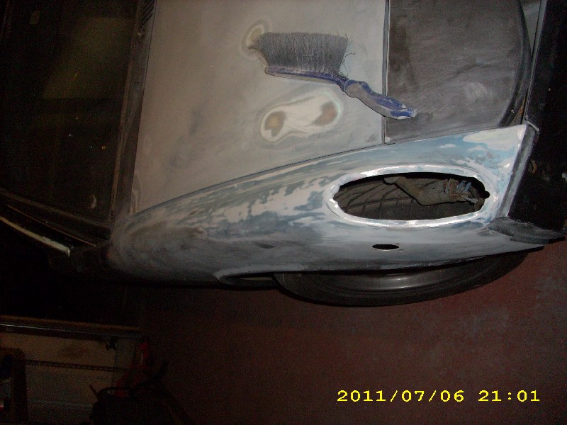

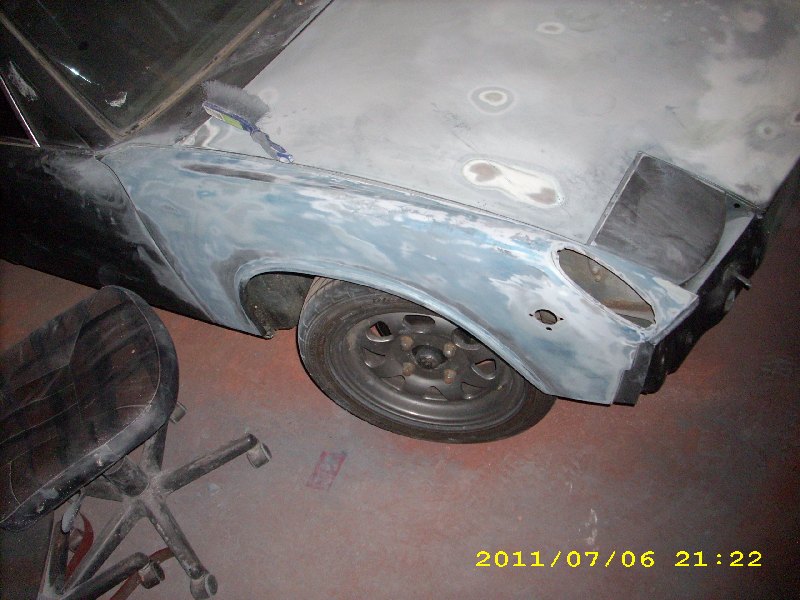

Fixed that corner, didnt get a good pic of it so I didnt post it. Finished up sanding the hood down, Probably have to go over it with 180 prior to primer. I put sanding blocks on the corners and tied the hood down so I could get the edges. Also got some sanding done on the fender. Looks pretty good but will need a little bit of filler.
Just a little over an hour and a half tonight.
