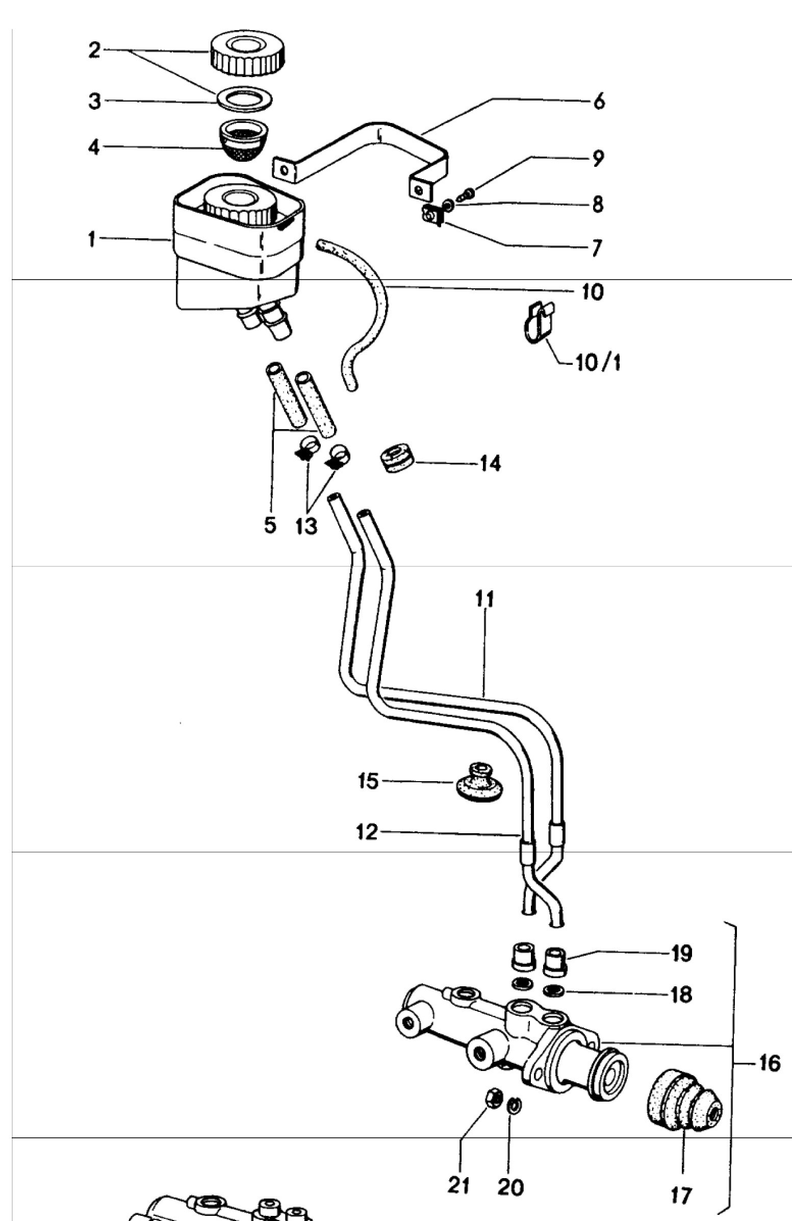

Tried many searches, asked a couple people... getting ready refill my brake system. The larger section of the two in the brake fluid reservoir is currently connected to the rear brakes. I hooked my hoses up like the pic below (items 11 & 12) when I put on my new master cylinder. Is the reservoir larger because the volume of the rear brake system holds more fluid? Or am I backwards? Or does it not matter?

assemble it just like that picture and you will be fine.

And, I like that assembling like the picture = OK, but still am curious why one part of the reservoir is bigger than the other.

I think the big reservoir feeds the front brakes. And further, this is because since the front brakes have bigger pistons, and do most of the braking and thus wear more, they have a bigger reservoir requirement.
The picture shows the big reservoir feeding the front chamber of the MC.
The front chamber of the tandem MC feeds the front brakes. (That's not shown on this picture, tho) But it's that way so that if the back brakes fail, you're still left with fronts. The rear piston compresses the front.
The large chamber is on the "back" of the reservoir, connects to hose 12, which is connected to the back chamber of the MC?

I was just going from the picture - in which it appears that the 'Hose 11' side of the reservoir is bigger.
I'll have to go look at an actual reservoir tonight.
You are saying that the big end of the reservoir contains the small chamber ?
Interesting...
Interesting...
Just looked at mine, the front section seems smaller when you look at it from above thru the cap. Maybe it's one of those "which line is longer" games
by Porsche engineers (meaning they are the same volume - and we're back to the it doesn't matter answer)

OK in this case, the drawing is the way it is suppose to be. . . the front of the reservoir is for the front brakes. . . that lower plastic line goes through the body hole that is towards the passenger side, and curves back to the front of the master cylinder. . . so the rear of the reservoir , for the rear brakes, and it's lower plastic hose goes through the hole on the drivers side and curves to the rear port on the master cylinder. .

Virtually all cars will have larger brakes on the front, thats where all your stopping power comes from. With this in mind, the larger portion of the reservoir typically goes to the front brakes. Now on a 914 with a remote resevoir, you have so much brake fluid stored in the feed lines, you would be hard pressed to run into a problem with low brake fluid and getting air in the system. I would still hook the larger side to the fronts no matter what the picture shows. Mike
