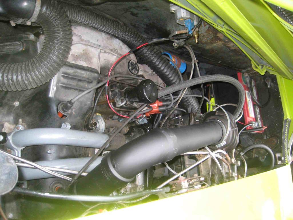

I finally got to drive my 914 again! (IMG:style_emoticons/default/mueba.gif) (IMG:style_emoticons/default/biggrin.gif) Back in June I was having fits with the L-Jet system that was on my car so I decided it was time to tackle a project I was wanting to do for some time, a CIS conversion.
I retrofitted a CIS Basic system to my stock 1.8L engine using parts from various VWs and Mercedes and today I fired it up for the first time and was able to take it for a long drive. It felt AWESOME. Smooth reliable power all the way to redline. It has a nice growl to it too. (IMG:style_emoticons/default/evilgrin.gif) I'm quite impressed. I still have to make some small adjustments but at least now I can get back to driving the car daily and the best part, NO MORE JACKSTANDS! I'm going to drive the snot out of the car this week to get the system dialed in and hopefully next weekend I will take it for a day drive in the mountains. (IMG:style_emoticons/default/driving.gif) More details and pics to come later.

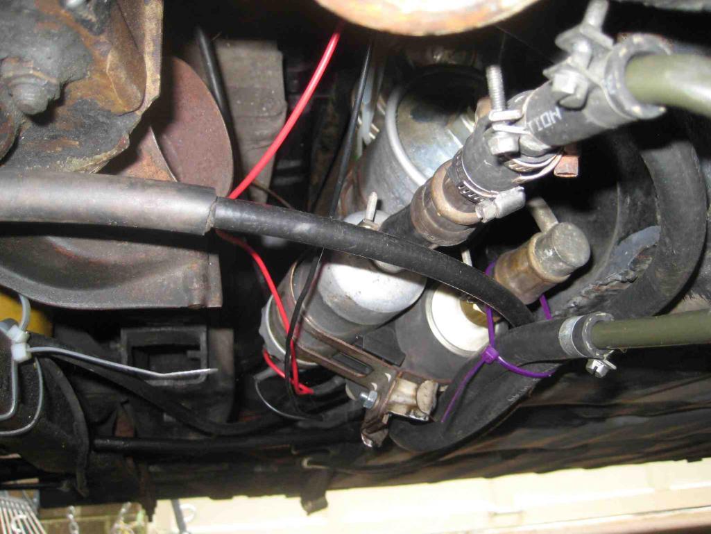

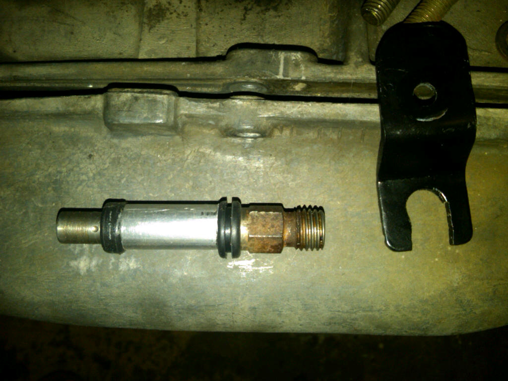

dlee6204   Okay here is a break down of everything I used. ...   Jul 18 2011, 09:27 PM

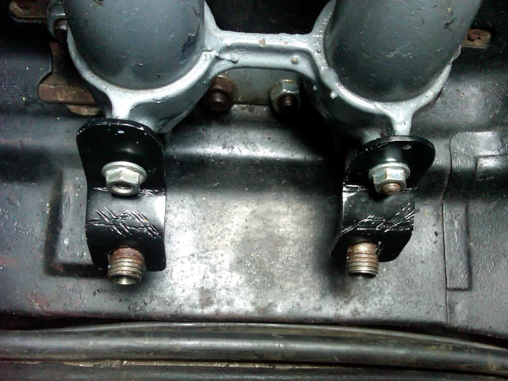

dlee6204   For the injectors I had to fab up some brackets a...   Jul 18 2011, 09:29 PM
dlee6204   And finally since I was completely new to anything...   Jul 18 2011, 09:32 PM

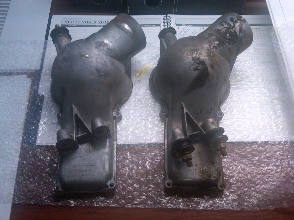

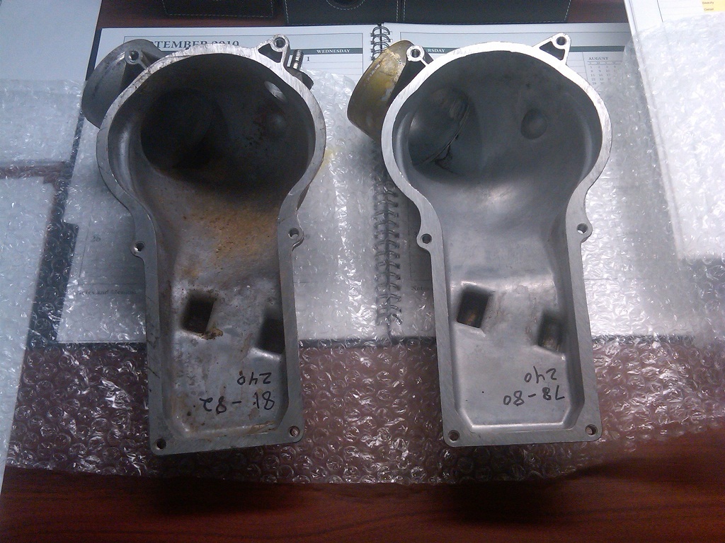

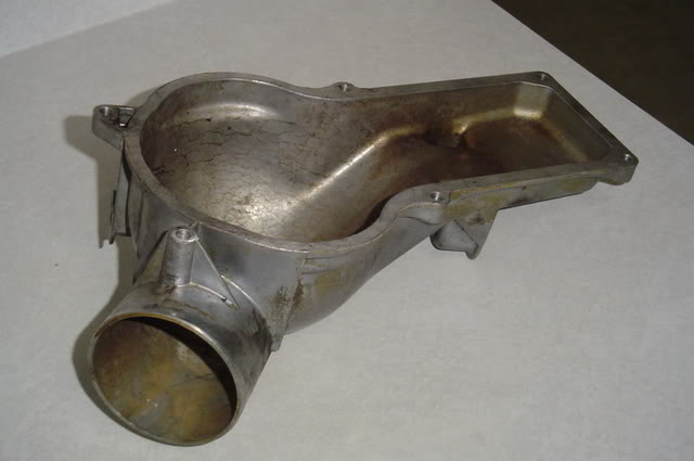

montoya 73 2.0   One of these Volvo 240 Aluminum Air Box Tray's...   Jul 18 2011, 09:44 PM
dlee6204   Yeah I need to do something about that. I had t...   Jul 18 2011, 09:47 PM

ThinAir   I was drooling over Dan & Jeff Dixon's CIS...   Jul 18 2011, 10:37 PM
dflesburg   whats with the long pipe on the air box? Why didn...   Jul 19 2011, 07:28 AM
dlee6204   Link saved! Thanks! The Rabbit I got m...   Jul 19 2011, 08:30 AM
dlee6204   The pipe goes from the Fuel Distributor/Airbox t...   Jul 19 2011, 08:33 AM
