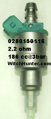

specs indicate this also applies to 74-79 VW buses and 80-83 Vanagons which have 1.8 and 2.0 engines. Possible substitution for 914 1.8L (NLA) injectors. flow rate 190.2 cc/min
http://www.fuelinjector.citymaker.com/Fuel...Flow_Rates.html
http://users.erols.com/srweiss/tableifc.htm
http://www.witchhunter.com/injectordata1.php4
