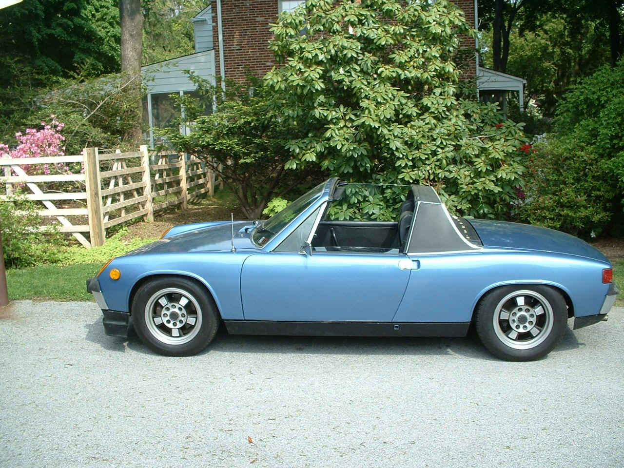

Trekkor
post Jul 2 2004, 11:50 PM
I do things...
Posts: 7,809
Joined: 2-December 03
From: Napa, Ca
Member No.: 1,413
I have 195/50/15's in the pic.
As far as I know they are a 5.5 inch rim.
If they were 6 inches wide, strong and spaced right would the hating stop?
I have to run my stock steels to accomodate my 205/50/15 Falkens without rubbin'.

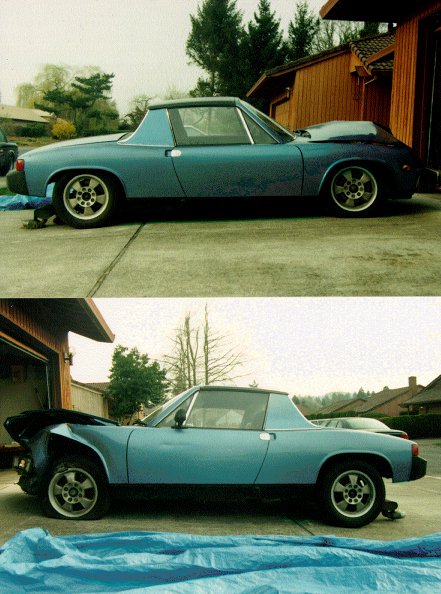

Ok, here is why I don't like them. It has nothing to do with backspacing, and everything to do woth appearance. Basically, that center circle where the lug holes are is too big. Plus, the number of holes there draws the eye away from the otherwise nice spokes that it has. Obviously the reason for this is because they had to fit 4-lugs into a 5 spoke pattern, and this was their attempt at doing that without it looking awkward. The end result is that the spokes don't look big enough. Having the spokes accented in black makes the problem worse. Now, having said that, there is a photo from the "What does your car look like" thread that I found where the Rivieras do look pretty cool. I think the reason I like them in this photo is because the spokes are not painted. The car in the photo is wrecked, but the top part of the photo looks pretty nice with those wheels.
914werke
post Jul 3 2004, 09:20 AM
Posts: 11,294
Joined: 22-March 03
From: USofA
Member No.: 453
Those are the bug variety. (IMG:style_emoticons/default/wacko.gif)
morph
post Jul 3 2004, 09:58 AM
quality parts builder
Posts: 1,828
Joined: 25-November 03
From: oregon coast
Member No.: 1,389
well i dont know if they are the bug ones.but as far as i can tell they made several diffrent types of rivies over the years. the ones in trekkors photo are the later style they have cut edges and are clear coated,american raceing i belive.the ones in thomas photos are one of te early styles they didnt have a flat spot on the spoke.over the years ive seen just about every one they made (musta made a buttload of these rims) the two that made me laugh when i seen them was the one that was a steele rim with with the mag or alum face of a riviera on it.cheap ....cheap looking.the other made me really laugh was a riviera hub cap (IMG:style_emoticons/default/laugh.gif) so in its time it musta been a really popular wheel to get imatations like that made of it.i never really had a problem with the looks,they can be pretty good looking,depending on paint and polish.ive just found more appealing wheels to me (IMG:style_emoticons/default/smile.gif)
