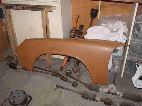

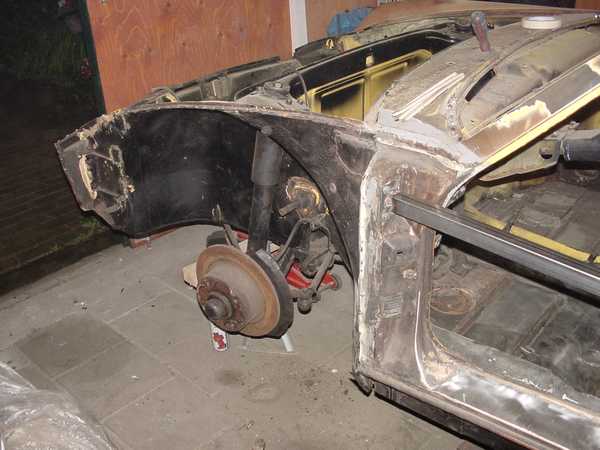

Got off my ass today...
Took off the left front fender
Jeroen
post Jul 4 2004, 05:14 PM
Posts: 7,887
Joined: 24-December 02
From: The Netherlands
Member No.: 3
Region Association: Europe
Here she is... brand spanking new factory piece (that's factory primer)
Tried to get it off with as little mutilation as possible

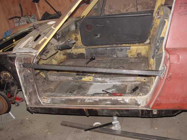

Next, I build a doorbrace. It bolts in nicely

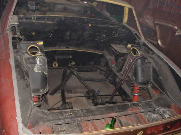

Next thing that had to go...
(before shot)
Jeroen
post Jul 4 2004, 05:17 PM
Posts: 7,887
Member No.: 3
3 grinding disks later (IMG:style_emoticons/default/biggrin.gif)

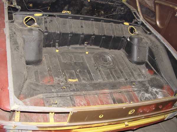

Here's why you don't need a rear shock tower brace...
The rear fire wall is double wall

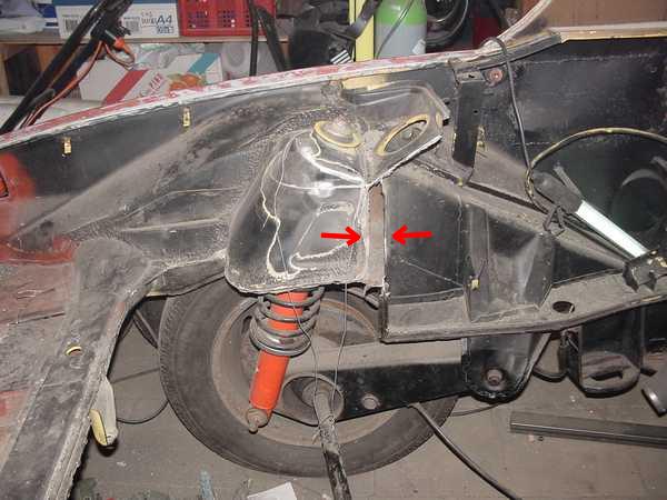

Engine will be a completely rebuild euro 3.0 Carrera with 40mm carbs

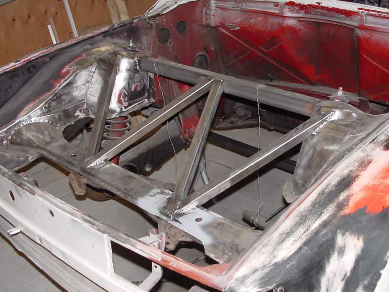

Fiid, I did the rear bracing already on my previous rustbucket (before found this less rusted bucket)
(IMG:http://www.rennware.com/914/pics/reartrunk04.jpg)
Check my website for more pics (of old rustbucket) and sketches (see button below)
cheers,
Jeroen

Here's a better pic...
fiid
post Jul 5 2004, 03:29 PM
Turbo Megasquirted Subaru Member
Posts: 2,827
Joined: 7-April 03
From: San Francisco, CA
Member No.: 530
Is that actually lighter than what was there before :-) ??
I gots to gets me somes of thats. Looks way cool, and gives me lots of space for turbos, intercoolers and fastness :-)
Fiid.

QUOTE(jandro62 @ Jul 5 2004, 05:41 PM)
Factory original body panels on a tube frame racer? oh dear.
That fender came OFF the car (IMG:style_emoticons/default/biggrin.gif)
Maybe not much, but there will be more sheetmetal cut out (IMG:style_emoticons/default/biggrin.gif)
And if not lighter, it will be a heck of a lot stronger
cheers,
Jeroen
