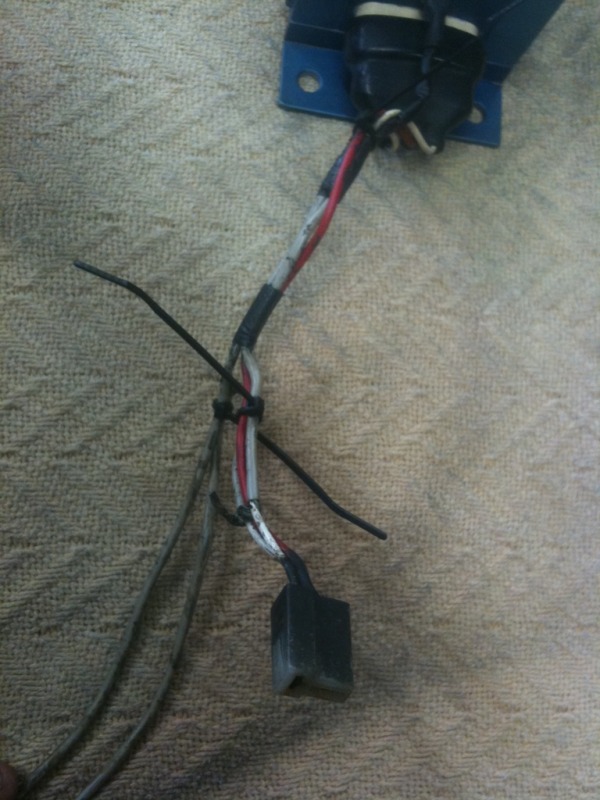

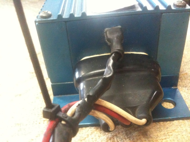

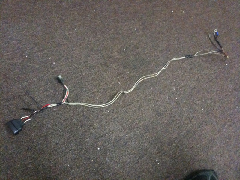

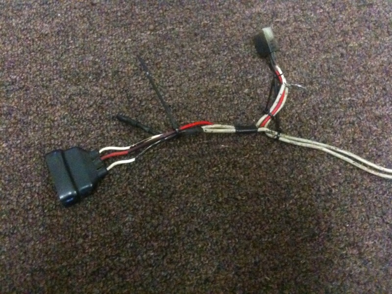

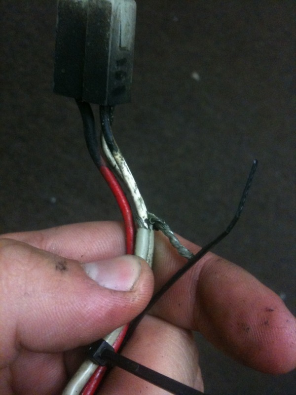

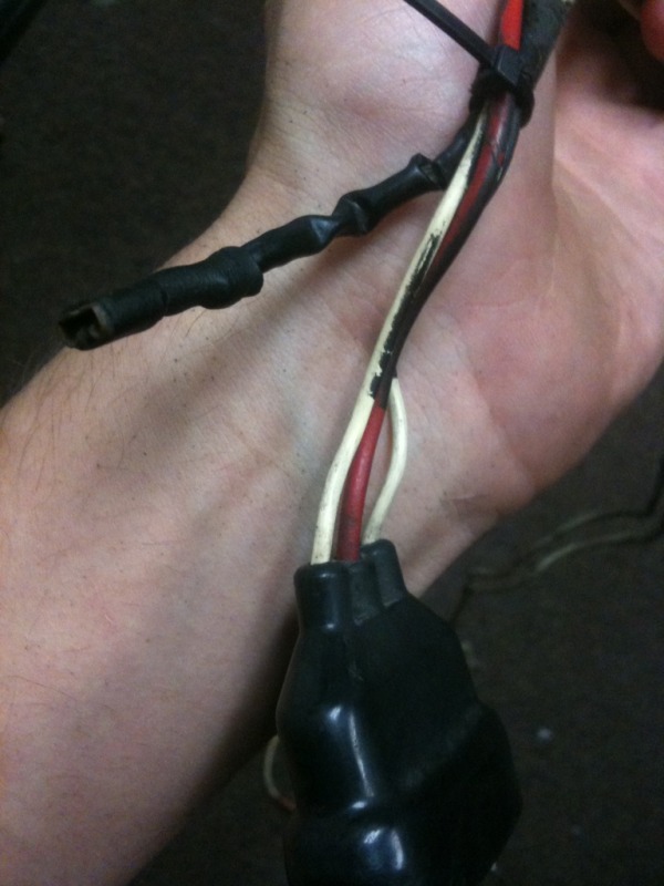

I'm in desperate need of help with this CDI wiring on my conversion. The wiring I pulled off the 77' is just in horrible condition, as you will see in the pictures below, and I wouldn't be surprised if the wires are colored wrong or spliced wrong.
I'm not sure where each of the leads go, and I can't seem to find anything on an assortment of diagrams.
(IMG:http://www.914world.com/bbs2/uploads_offsite/i16.photobucket.com-9478-1313108475.1.jpg)
(IMG:http://www.914world.com/bbs2/uploads_offsite/i16.photobucket.com-9478-1313108475.2.jpg)
(IMG:http://www.914world.com/bbs2/uploads_offsite/i16.photobucket.com-9478-1313108476.3.jpg)
(IMG:http://www.914world.com/bbs2/uploads_offsite/i16.photobucket.com-9478-1313108476.4.jpg)

I don't have any of my wiring diagrams here at home, but the red one should be switched power, one goes to the points/tach, and the other goes to the ignition transformer (which looks like a coil but isn't).

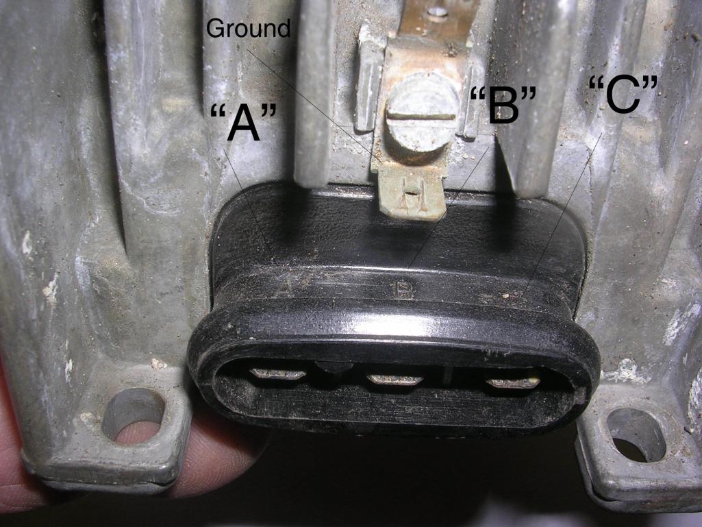

Four wire to a 3 pin CDI box. Look at the end of the box ... terminals are labeled "A", "B" & "C"
"A" = to Terminal 15 on transformer (not an effin' coil).
"B" = Switched power B+
"C" = Tach input & trigger wire from points
Last wire CDI case to ground (spade terminal)

The connector in your pic had a mate and probably is the tach wire / B+ if there are 2 wires. Long harness went to transformer / dizzy (other side of transformer goes to ground - Terminal 1). Lonely wire is the ground on the CDI case.

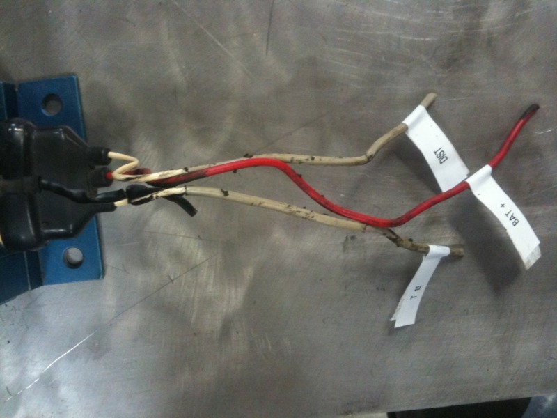

Ok, so I've started pulling everything out, and I'm sure I'll have to do some work on this portion of the harness, as you've seen, it's pretty rough. Just have a few more questions...
I have the Red wire going to the positive terminal on the battery, my only issue now is that I don't know which of the white wires is which, because I have a Permatune Box and the numbers/letters don't seem to be there (IMG:style_emoticons/default/blink.gif)
Was this the connector you where talking about, Ron (see first picture)?

Wiring on the "Permadoom" is the same. My 2.7L runs better with the "Permadoom" than it does with the Bosch. "Permadoom" was OE to Porsche when Bosch couldn't get their act together.
Cost to rebuild a Bosch unit is $225 & up. Supposedly, the "Permadoom" cannot be rebuilt as it is potted. Never took one apart to find out.

And what about that plug that I was talking about? Can I eliminate it and am I correct in the red going to the positive terminal?
Pelican sells a 'Permatune Coil' will I need one or can I stick with the original black unit?

Use a stock "TRANSFORMER - it's not a coil.
Yes you can cut the plug off and wire in (not the plug that goes into the CD unit).

Yes, I meant the one below with the black overspray on it.

And that's the one I meant. You probably could find a mating plug if you looked though.

Reference for anyone else who stumbles upon this, correct?

Si!
