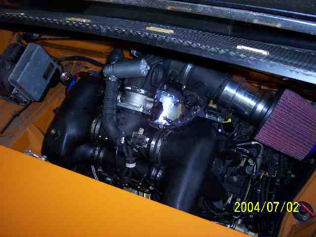

I too'll chime in.
I like others started my project,with something simple in mind.
I thought I'd go w/a 2.4l,webers,and a 901 box.Keep it simple.I bought one,and even had it in the car.That way I could just be out having fun,but like others,a project ends up taking more turns than 12 hours at Nurburgring.
I came across the 3.6 and decided,WTH.
Horsepower is already there,modern FI.and as big as you can get from the start.
It's taken more time,money,effort,and I haven't even yet had the chance to get it on the road.I still believe it was the right choice for me. But,you gotta go where heart will lead,and your wallet can follow.
Me,I've done mine with some D.E. in mind somewhere down the road.The wife and I both wanna learn to drive this car correctly,and have some fun while we're doing it.
Ron
