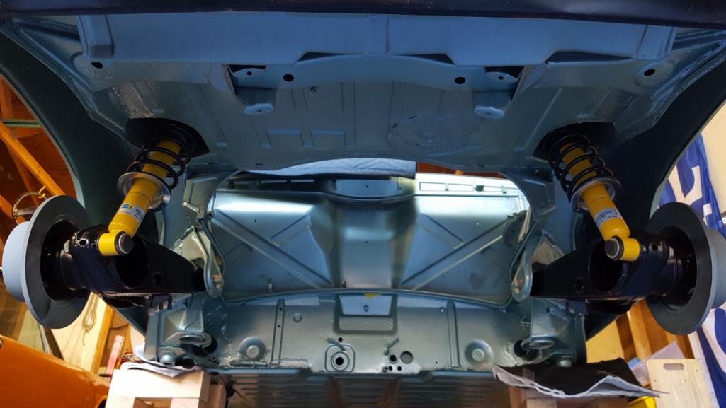

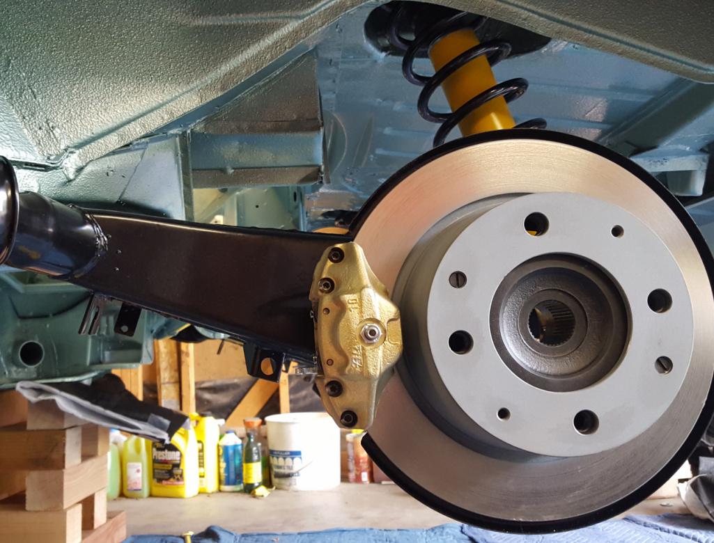

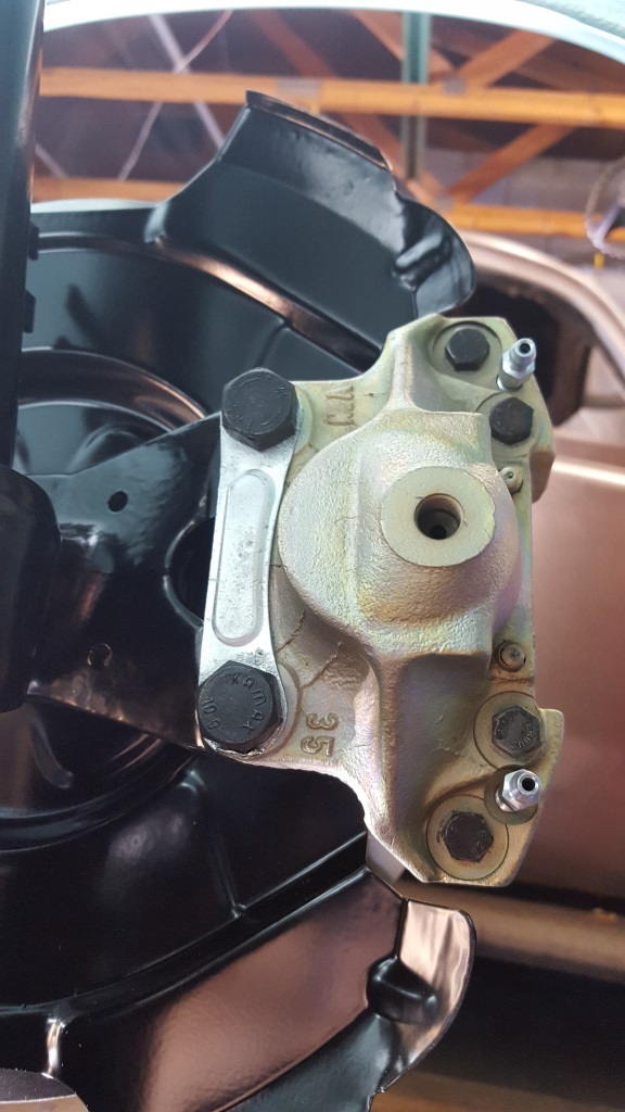

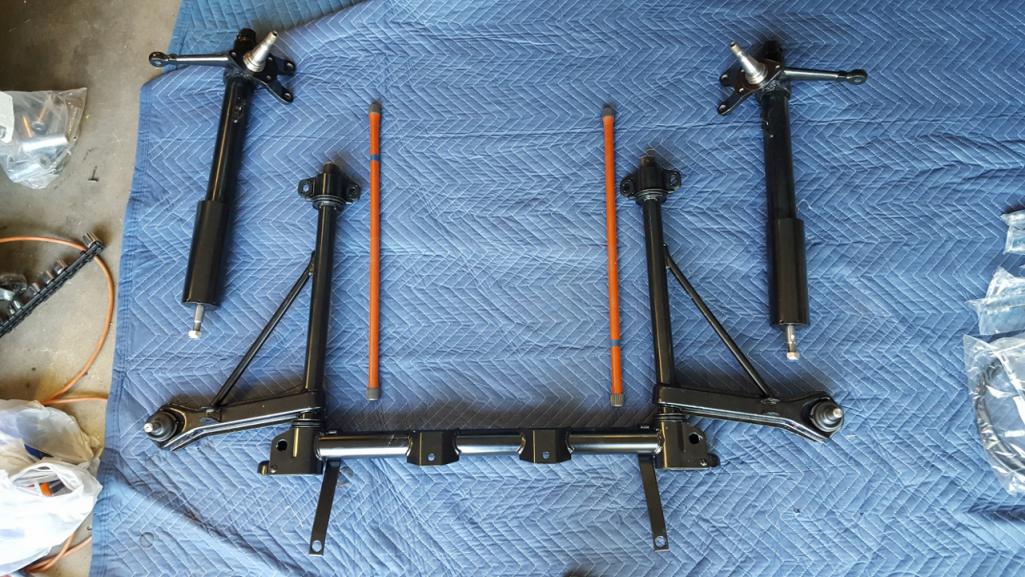

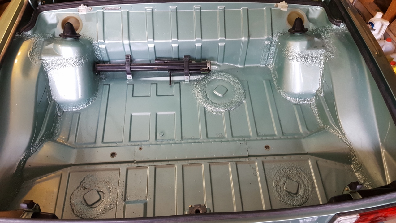

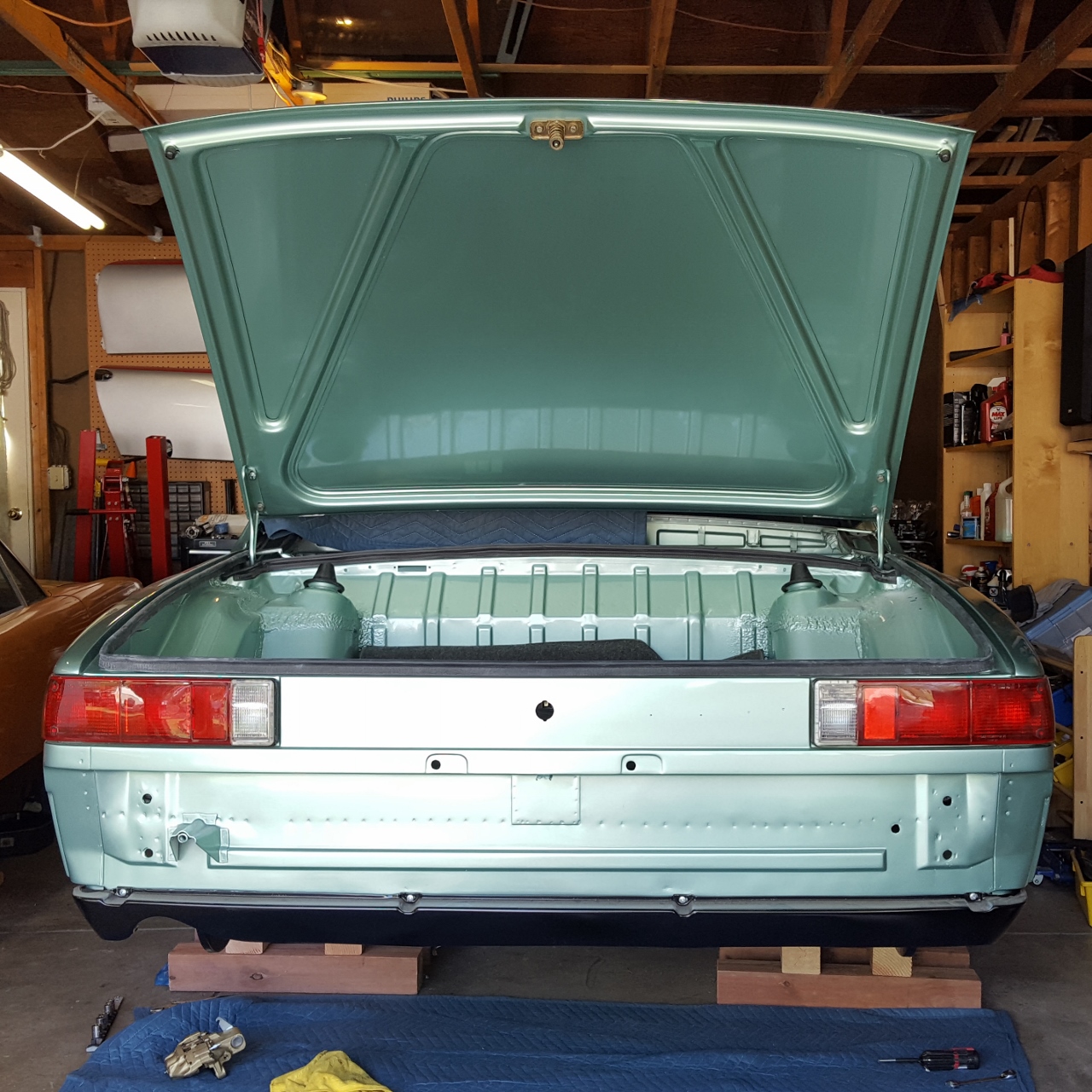

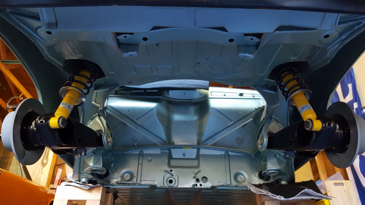

Starting reassembly with PMB brakes, powder coated suspension components, and Bilsteins!

gms
post Oct 3 2017, 06:27 PM
Post #182
Posts: 2,761
Joined: 12-March 04
From: Chicagoland
Member No.: 1,785
Looks great Ross!
Jacob
Post #183
Posts: 131
Joined: 12-February 08
From: Mansfield, Oh
Member No.: 8,705
Wow! That is beautiful! Thanks for taking the time to post all the pictures! Much appreciated!

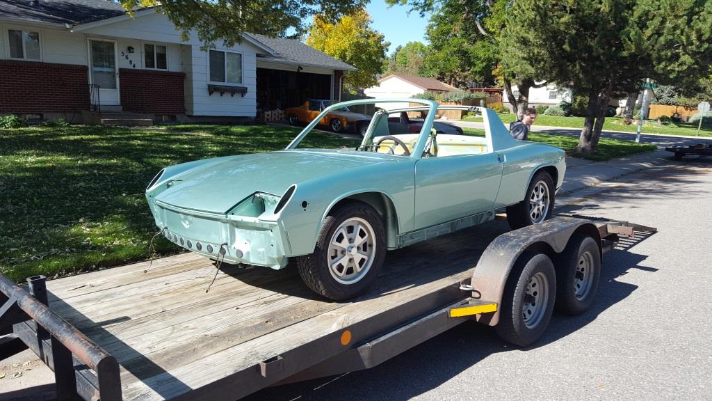

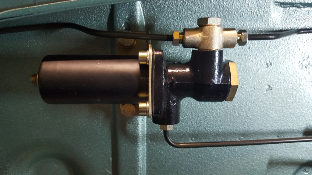

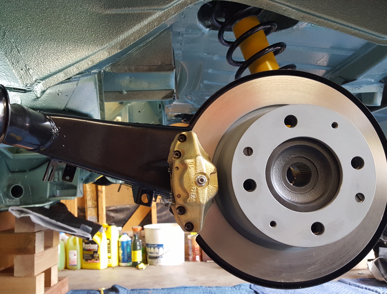

Got some more work done installing brakes and new hard and soft lines from PMB. Worth the cost! I also Pulled the car out and trailered it to a new garage that's a bit closer to home.
The shine off the paint is incredible!
