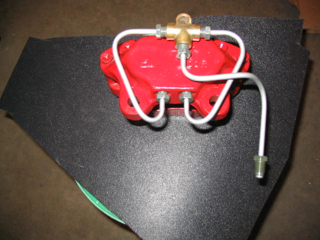

I'm running 4 piston units from a BMW 2002. They are much lighter than the Volvo. (unsprung wieght is not our friend) Also I think they would cause less heat build up and possible warping of the rotors. Just my oppinion. But what do I know.

i rebuilt my friends 2002 calipers for his '02. it'd be great if there could be a spacer for the caliper, to make it for a vented rotor
