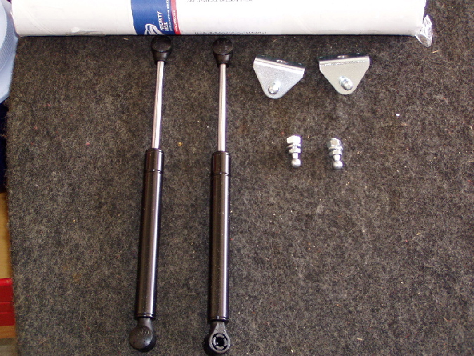

Just wanted to say that I am very happy with the front trunk shock kit from CAMP914, thanks Craig! (IMG:style_emoticons/default/smilie_pokal.gif)
My springs were shot and would not keep the front trunk lid open all the way. They couldn't be adjusted anymore and I was tired of the lid slowly sliding down when opened. Craigs kits are easy to install, took me on 15 min during lunch today (I work from home)
Here's a few pics: The KIT

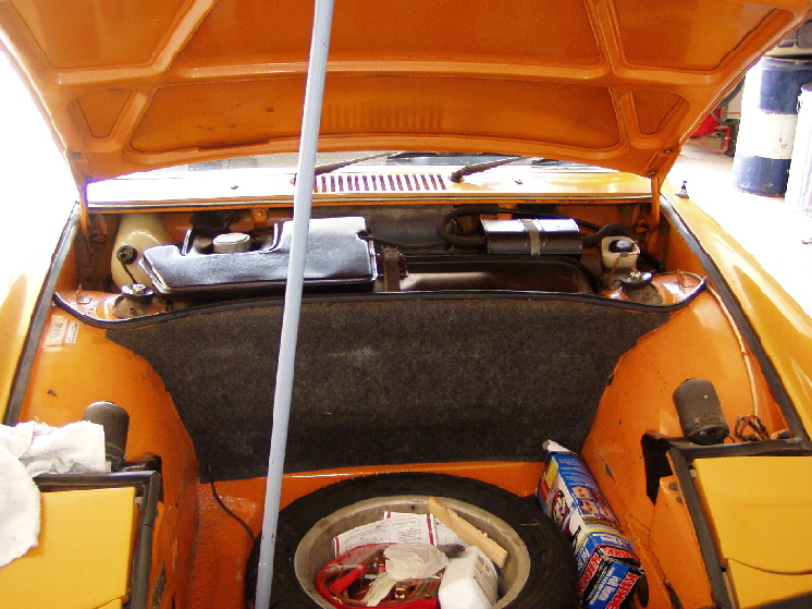

Look Ma..... No springs.... (IMG:style_emoticons/default/ohmy.gif)

Kit installed (IMG:style_emoticons/default/smilie_pokal.gif)
