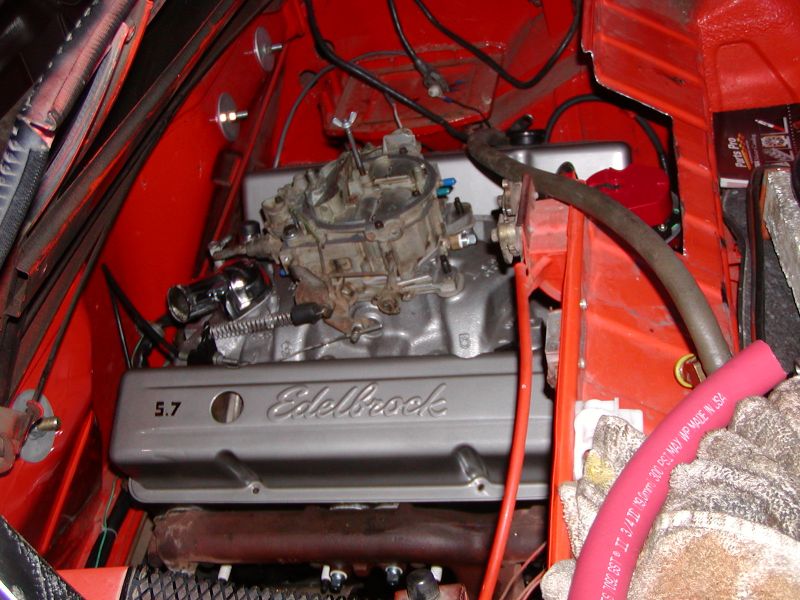

BIGKAT and Brad
Thanks for warding off a big problem. We're throwing out the plastic fittings and getting copper plumming like one of the previous kit owners was using. I would prefer stainless, but Lowes doesn't carry it (IMG:style_emoticons/default/huh.gif)
So now it's time to learn how to solder copper plumbing. (Good to 450 degrees)
In the meantime. We took a moment last night to try and fire up the beast. Long enough to find out the dist was 180 out, wasn't getting any juce, the battery was dead, exhaust had a huge leak and hi-torque starters are NOISEY. (May be because we need to rework the tranny mount bolts, too solid).
Finally, FIRE in the HOLE. (litterally when the exhaust was leaking)
Still have to rework the timing and find why the carb seems to be sucking air.
No more running until the water lines are sorted out. Soldering is a pain, anyone else have an idea how to reduce 1 1/2" hose to 1" hose?
Inch by inch... slowly It turned...

for the reducer, try Summit Racing
I found these for Datsun Z Chevy swaps
Hose adapters/reducers
If you do end up using the copper tubing, try to add a bead on the OD so that the hose is less likely to slip off...

If you are going to use copper piping, I'd suggest you use a 90 *sweep* rather than a simple 90. It has a much larger radius bend rather than the tight *L* found in common copper 90's. You may have to go to a plumbing supply house (though I've seen 1/2" at HD), but they are available and will really help to reduce pressure drop.
Shock mounting the radiator is a really good way to avoid cracking/leakage issues. For race vehicles, I have always fabricated a U shape with U channel lined with foam weather strip. Slide the radiator in, and it is completely isolated from vibration under even the most severe conditions. I have an AFCO dual pass racing radiator; on their site, they recommend this type of isolation mounting as well. I have done this on mine; as I progress, I will post some pic's in a couple of days of my setup.
I suggest you avoid using puller and pusher fans. I have no direct experience with witnessing problems with this combination, but (as was previously posted) I've read that any small difference in the balance of flow between the two can create a tremendous stall in the air flow.
Shrouding the fans really improves their effectiveness usually because they cannot cover enough of the radiator core area. An unshrouded fan will only cover the area it projects over. You can test first, and shroud as necessary. If you do build a shroud, I'd also suggest some simple flappers that remain closed when the fans are runing while the car is at slow speed or stopped, and open when airflow increases as vehilcle speed increases so as to realize a greater area of air flow. BeCool makes a nice fan and shroud assebly with flappers available from Summit, p/n BCI-75007. BTW, I bought two 12" fans from Zirgo; they have very high CFM ratings, their prices are very good, and you can buy directly from them (Oregon). http://www.zirgo.com/search.lasso?search=fan
I also stumbled arcoss this site http://www.fordmuscle.com/archives/2003/02...fan/index.shtml
I'm not sure I believe their estimated 2000CFM from a 12" fan (off a Ford Taurus), but it is an interesting alternative (two fans?).....Although, after checking into on-line junk yard pricing, seems $75 to $150 was the going price. Perhaps you'd fare better at a Pick-and-Pull.
