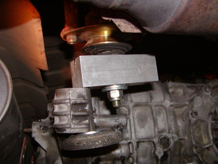

Well while dad was giving it full throttle, we must have hit a bump or something.. A couple loud noises came... Not continual.. just a couple. Im guessing dad put the clutch in... So we drove it back home (all of about 100 yards) and looked at it.. We looked around, checked underneith.. I tried to point out the low clearance between the alternator belt and the shift linkage (bout 1/4 to 1/8 in...) when dad noticed something...
The trani mounts...

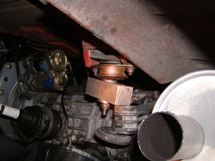

But I didnt even show you the mount!!
I'd love to talk! Cant say it here? Need more room? More idea's? Go ahead and shoot me a pm (either account..)
Heres the mount... I THINK I have it in backwards (I debated on that for a LONG time installing it... guess I just did it wrong.... Eh I'll figure that one out.

Dude, that aint right. It should fit perfect, that looks like its going to fall out. You need to fix that right away. Trust me, you dont want to take any chances with that one. Did you see this???

Oh, I know its not right... notice that I posted pics on it and such? lol
Ya, Im going to fix it before I drive it again.. the trani is being supported by a small jack right now just in case.
Andrew

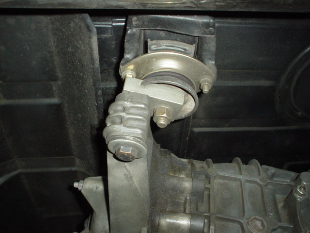

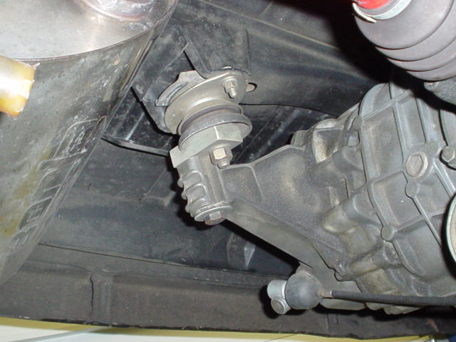

Attached are a couple of pics of how the trans. mount is supposed to look. This is a combination of the 911 sport mount, a notched washer from the stock 914 mount and Rengade's spacer.
Getting the timing right can be challanging with the v8 installed. You may have the distributor installed off a tooth or two but you should still have more power than described. With my timing set correctly, I could still rotate the distributor 3/8" in either direction without loosing the amount of power you describe (3/8" measured by marking base of dist. and having a fixed mark where it slides into intake).
