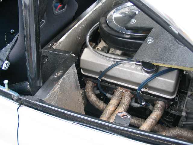

BIGKAT_83
post Oct 5 2004, 03:06 PM
Post #199
Posts: 1,800
Joined: 25-January 03
From: Way down south Bogart,GA
Member No.: 194
and one of the engine.
