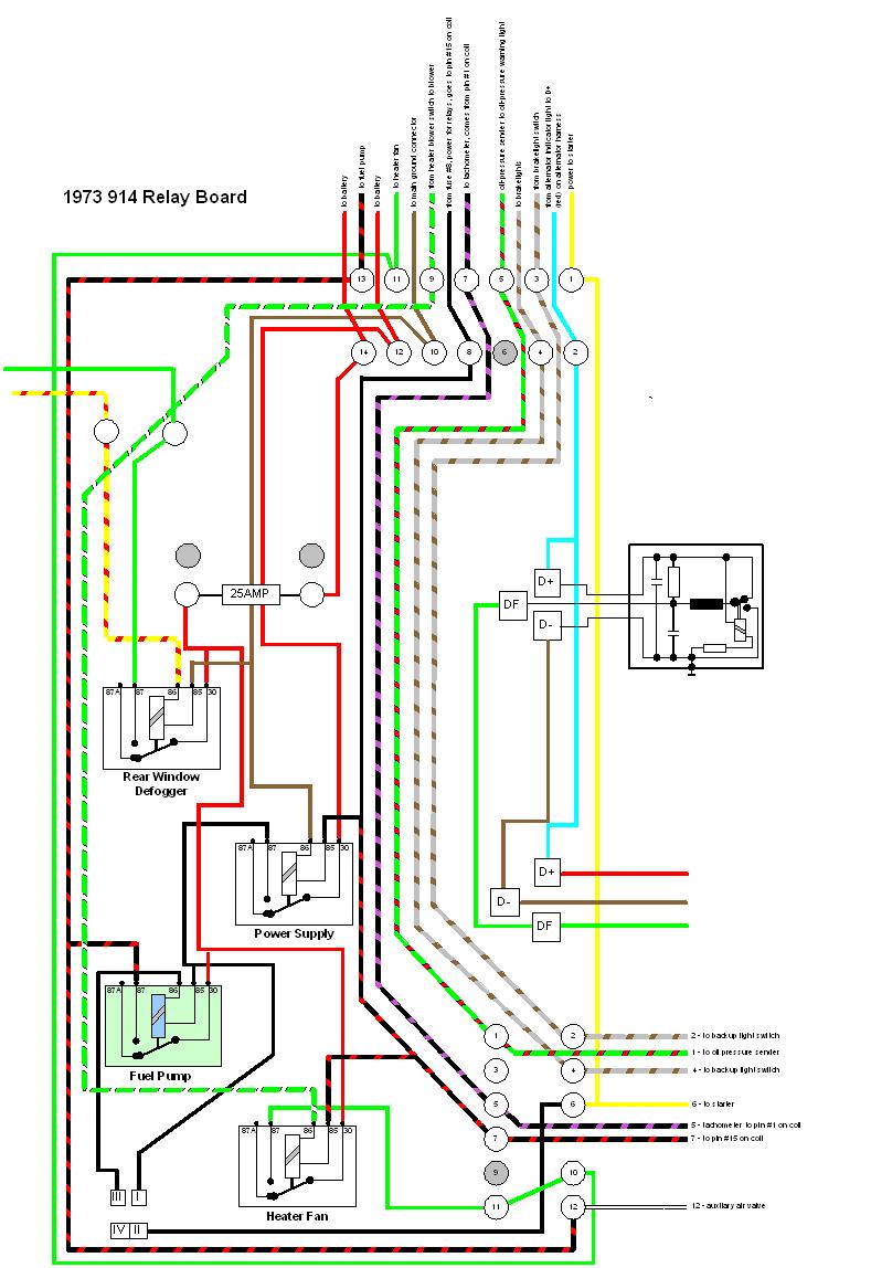

There are two unfused leads directly from the battery to the relay board - pins 14 and 12 (don't know why 2 of them - need to check the diagram) The relay board ground is pin 10 - right beside the unfused supply. Hopefully whatever shorted was on the board and not the harness. There is a cover on the plug - slide it off and see how bad the damage is. I shudder to think about the amount of work it would take to repair that plug if there is significant damage to the wires. Might not be too bad to repair the power supply and ground. Anything else though...
hear is a good diagram of the relay board with the leads identified.
Tom

That is a wonderful diagram! Did you redraw it? I like the labeling of the wires to the 12 and 14 pin connectors especially. I have slowly been getting the drawing in my Hanyes labeled, but now it was easy.
One small thing, on the 14 pin pins #3 and #4 say brake lights but are back up lights. It is labeled right on the 12 pin.
Thanks for posting this great diagram,
Tom

I can't take credit for this one Tom. I picked iit up somewhere in my travels years ago and I can't remember where. I've really found it priceless and would love to credit the original author but I don't know where it came from.
