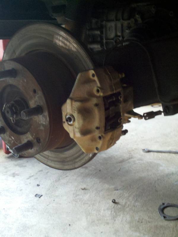

Here is a pic of my new restored rear Calipers. Huge tanks to Eric at PMB Performance (IMG:style_emoticons/default/pray.gif) . My calipers are beautiful. I still need to adjust them but will get to that tommorow night. The picture is a little dark but damn if my rotor doesn't look like crap with the new caliper there (IMG:style_emoticons/default/dry.gif)

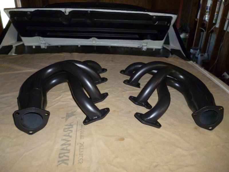

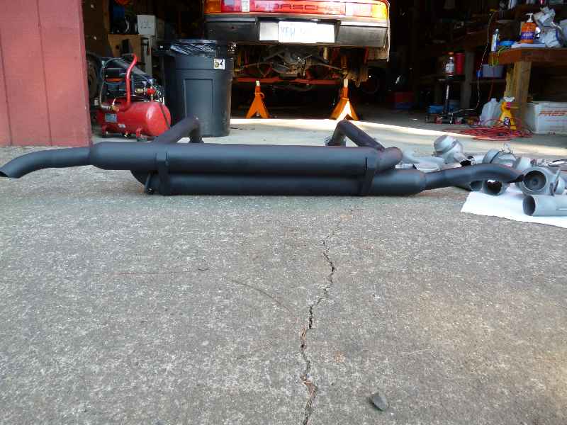

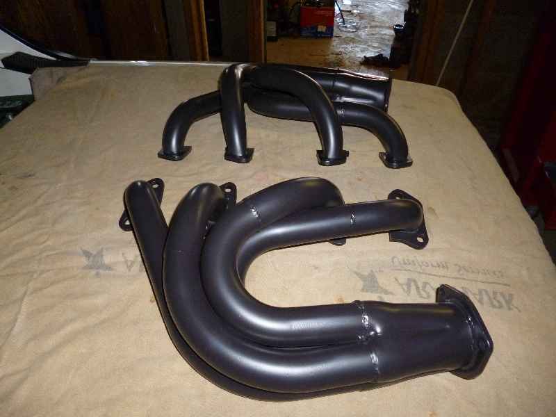

I sent my short headers off to get Cermaic coated at a place in Portland. They will do one coat inside & 2 coats outside. I'm having them done in black as they said that had the best cooling. I'll get pics of these when I pick them up mid week.

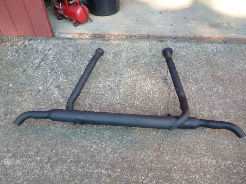

I also dropped off my muffler & pipes to get ceramic coated at another shop. It was a little cheaper than the place in Portland. The quality won't be as good either but that's okay for the muffler & pipes. I just did these to look nice really. It will help cooling also but not as much as my headers.

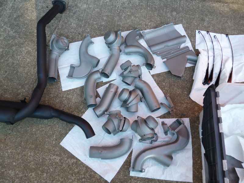

Along with these I dropped off a bunch of heater parts to get powder coated for my LE. All the parts that connect to the heat exchangers. I took one full set along with all the spares I had. Made sense to just get them all done & looking nice. I'm excited as this guy is pretty cheap & does nice work. I guess I will reserve my judgement until I get all my parts back though. I will get pics up for this stuff this weekend when I pick them up.

Picked up my headers today! They look sweet. I guess they don't really qualify as bling since they are black. They really don't pop in the engine bay. I just can't wait to pick up my muffler & pipes saturday & get them on. I will be putting my v8 back on the road monday (IMG:style_emoticons/default/driving.gif) . Still need to do something better about my firewall. It will be a temporary one. I am just tired of waiting to drive it. 2 years on stands is way to long

My car has always stopped great. I doubt I will feel a difference. I have 944t brakes up front. It really stops amazingly fast. Only did the rebuild/restore to the rears because of a leak. I've got to go out & adjust them tonight too. Not sure if I will get them bled tonight. Not sure what the family has planned.

On the engine bay temps I didn't get readings. The headers ran $260 with 2coatings outside & one inside. Supposed to cut the heat by 70% on them. My muffler i took to a cheaper guy. Only be like $70 for it with the pipes. Not as good a quality. He will get the inside a little but only as far as he can spray. Then one coat outside. Kind of a hillbillie setup but he looks to do good work. I'll get some pics up when I get it. He has them done but had to leave town today. So I am picking them up tommorow afternoon.

I picked up my muffler. Along with my heater parts for the LE. Went with a grey on the heater parts for the powder coating. I think they look great. Muffler will be fine too. Looks better than before & should cool the temps back a little bit. Definately not the quality of the headers but I wasn't expecting it. I am happy with it overall. Going to relax in my recliner until after dinner. Then I will go out & put it on (IMG:style_emoticons/default/smile.gif)
On the heater parts I just loaded all my spares up too. So I have at least a full extra set (IMG:style_emoticons/default/evilgrin.gif)

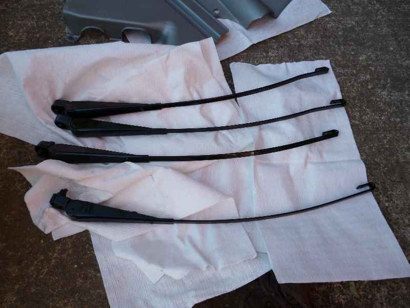

Oh yeah I took 2 sets of wipers arms to get done too. They look excellent

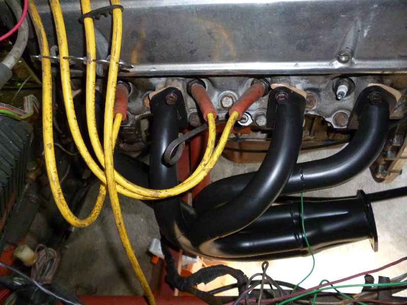

Exhaust all on & interior in. Now I need to adjust & bleed the brakes (IMG:style_emoticons/default/smile.gif) . Yipee (IMG:style_emoticons/default/rolleyes.gif)

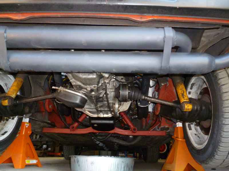

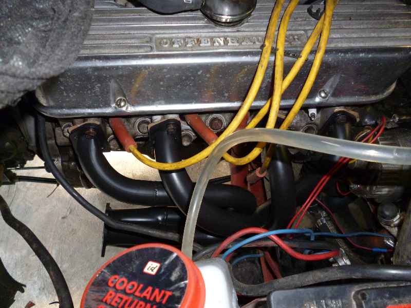

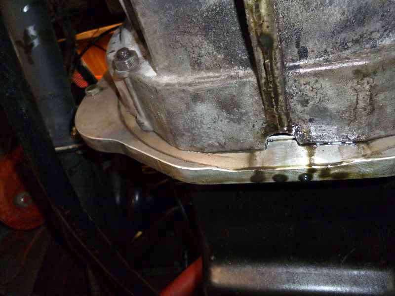

Okay I got everything on that needed to be on. Started right up & headed into town for fuel. I was way low & my light was blinking. Still it was only 2 miles into town. Started cutting out just as I pulled in the station. Took 13 1/2 gallons before it shut off. No problem except it doesn't want to start after my fillup. I pump the gas a few times & try again. Battery dead (IMG:style_emoticons/default/headbang.gif) Not enough juice to turn it over. Called my wife to come in with jumper cables (of course she was taking a nap). So I am semi on the shit list. Finally get it started & unhook the cables. 10 seconds later the car chokes out & dies. Just the dreds from the bottom of my tank (IMG:style_emoticons/default/confused24.gif) . Anyway I get it started again & rev it for a bit. Still choking out at lower rpm's. Anyway I get it home & notice on upper RPM's I get a plume of smoke. Basically if I floored it once it hit the 4-5k i would get smoke.
I get home & pull into the shop. I jack up the rear end & get a battery charger on. I have a pretty decent drip of oil coming from the bottom of my tranny & adapter plate. Not sure where that is coming from? Rear main seal maybe? I also start it & rev it from the engine compartment. I can see the oil coming out of my dipstick tube. Right around the dipstick (IMG:style_emoticons/default/confused24.gif) . It doesn't have any kind of seal on it? Strange but it must have lost something at some point as it just sits in there kind of loose. I checked my oil level & looks like I overfilled it some. It was reading about a quarter of an inch over full. I'm going to look into getting another dipstick. Any other suggestions?????

Is the smoke comming from the exhaust or engine compartment?
Are you using a distributor on this motor? (Is the distributor hold down clamp loose?)---check timing
Any vacuum lines or ports come unplugged?
Is your choke plate on your carb stuck closed?
Oil from your dip-stick leak is probably collecting at the union between the engine and trans.

I'm sure that the exhaust is going to smoke a bit whilst getting them hot the first couple of times. I would get the oil level back down to a more acceptable level. sometimes seals dry up after sitting for a long time.
