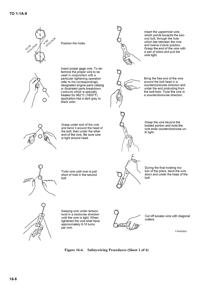

synthesisdv   anyone got a picture of the cv bolts safety wired?...   Jul 13 2004, 06:17 AM

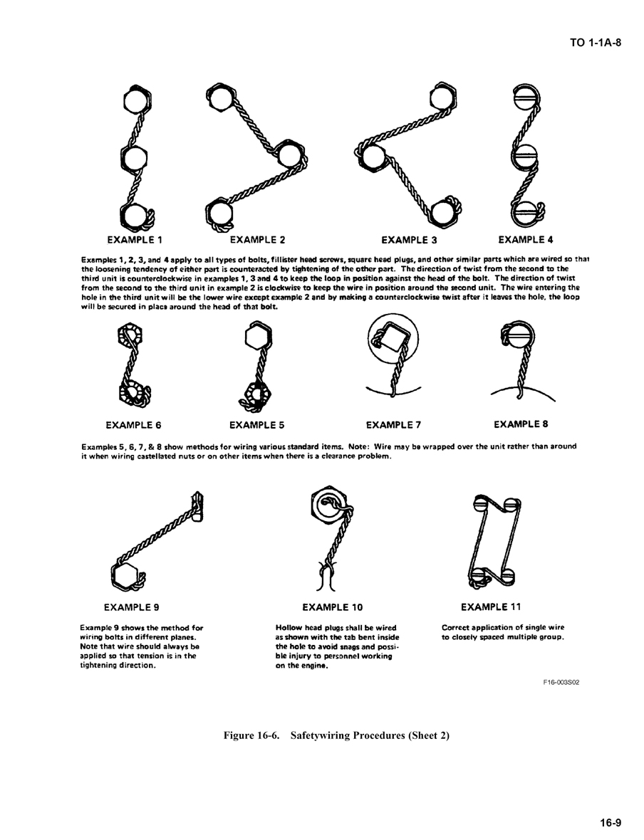

Ctrout   Safety wiring is easy. The tricks are not to over...   Jul 18 2004, 09:08 PM
!   Ayupers....me seven....happened on Wyld Thang. Di...   Jul 18 2004, 09:45 PM
Ctrout   This   Jul 19 2004, 07:05 PM
Ctrout   And this   Jul 19 2004, 07:07 PM
Porsche Rescue   That gives me a headache. I think I'll stay wi...   Jul 19 2004, 07:18 PM
