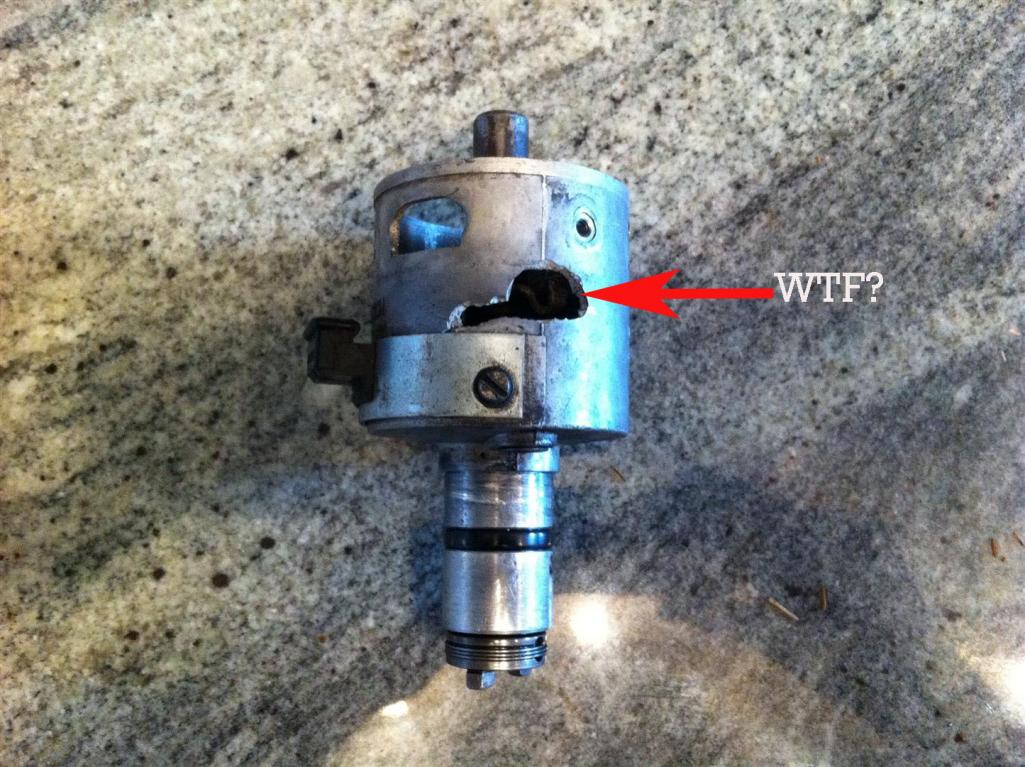

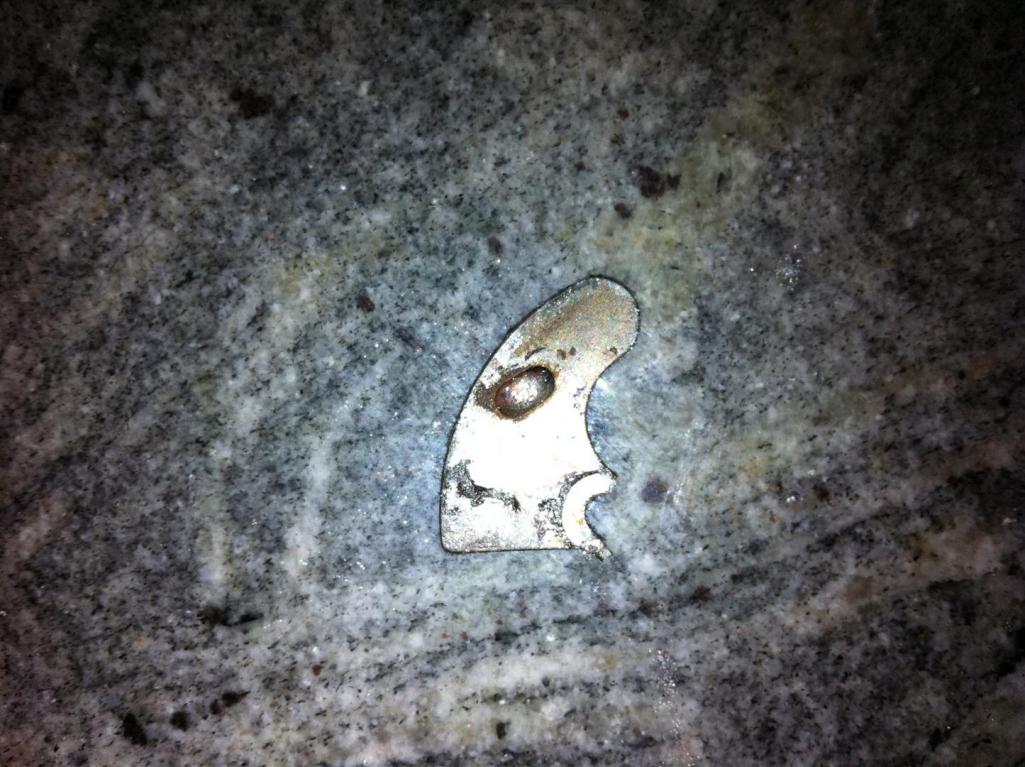

2.0 Djet. I changed out the plate due to a disconnected ground about a year ago and cleaned and lubed everything at that time. It has worked fine since then, til yesterday. Went to start the car and it did not sound right. Then no spark. Fiddled with a few things to make sure the wiring on the coil did not rattle loose etc, tried again and the distributer rotated 180 degrees and exposed this fancy new hole.
Attached Image (IMG:style_emoticons/default/ar15.gif)

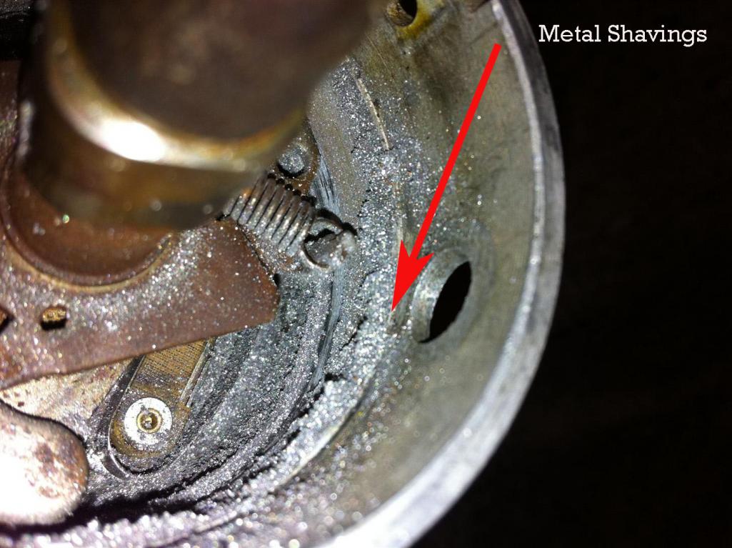

Towed it home and dismantled the distributer this morning to find the following.
It had been wearing away for a while based on the metal shavings. The shavings are not brass / bronze from the normal wear of the rotor /cap.

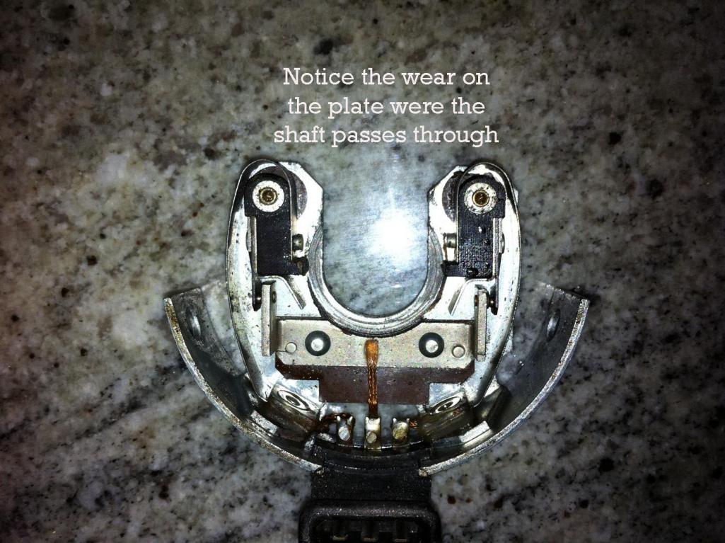

Notice the wear on the FI trigger points plate too

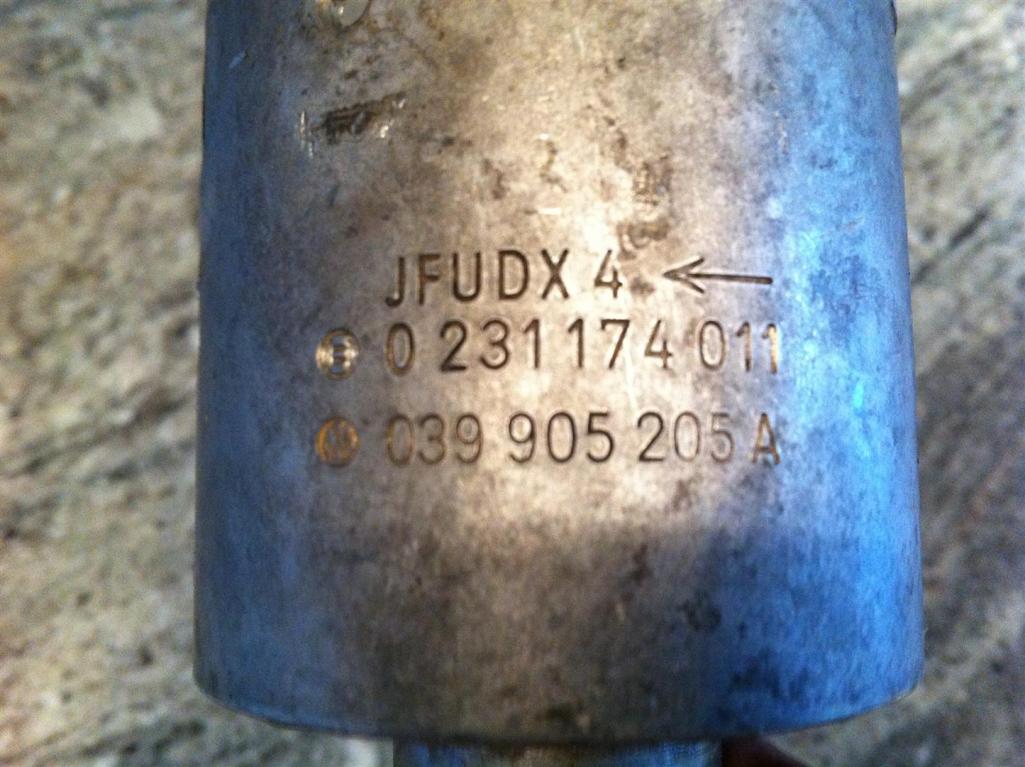

Part numbers for reference

kwales   Jup, Bosch distributors do that. Blew one in my ...   Sep 7 2011, 09:08 PM

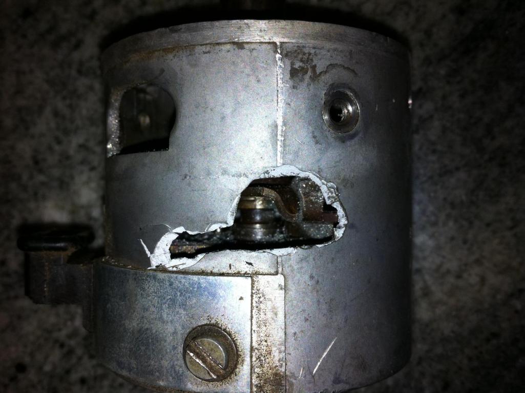

green71   My car did the same thing -- shot the piece clean ...   Sep 7 2011, 10:41 PM

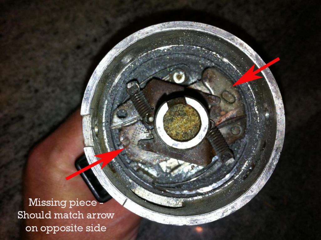

cwpeden   Actually the bottom 1/4 of your drive is ok. That ...   Sep 8 2011, 07:36 PM
bigkensteele   Looks like you might owe Mark a beer. It would ap...   Sep 8 2011, 07:53 PM
green71   bigkensteele is right about splitting the case. Th...   Sep 8 2011, 11:41 PM
