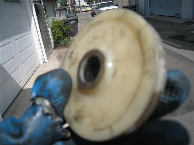

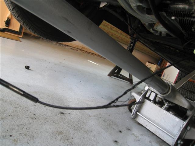

Any particular reason the clutch cable would unravel at the top of the roller ? Should the roller spin freely when reasembled ?
A few pics of what I'm looking at... (IMG:style_emoticons/default/smile.gif)
underthetire
post Sep 20 2011, 02:48 PM
Posts: 5,062
Joined: 7-October 08
From: Brentwood
Member No.: 9,623
Cause thats where it makes a U-turn. Yes, the roller should be free. 914 rubber makes new delrin ones.

Yep, that's where the most load is on the cable.

.....Defective cable(clutch) & yes it should roll with freedom! (IMG:style_emoticons/default/flag.gif) (IMG:style_emoticons/default/flag.gif)

Metal fatigue . . . .

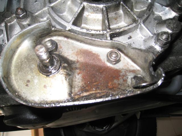

Jim - Unless you set it aside before snapping the pic, it looks like you're missing the metal sleeve the goes in between the roller and the stud in the console (IMG:style_emoticons/default/confused24.gif)
I bought one of those '914 Rubber.com' Delrin rollers from Glenn Sager at the most recent All Porsche Swap Meet ... it's nice (IMG:style_emoticons/default/cheer.gif)

Thanks Mark, I had the bushing set aside at the time of the pic. Upon closer inspection of the wire where it partially broke and unraveled; it appears that there was a serious amount of grit between the wires and around the roller. Seems like the assembly would benefit from being enclosed in a rubber boot of some type.
Went over and looked at another 914's roller this am and found serious build up of oily dirt. This is definately a part to regulary inspect and clean.

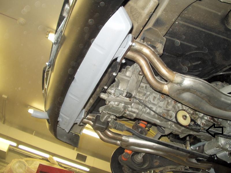

In addition to a boot (bellows) being a good idea, while I was helping Kapt Kaos inspect and reinstall a clutch cable last Tuesday evening, I noticed that he had a retaining ring that secures the cable sheath to the pulley housing (a washer with a tab sticking out on one side that bends into the hole on the side of the housing). I had never seen one of those before.
