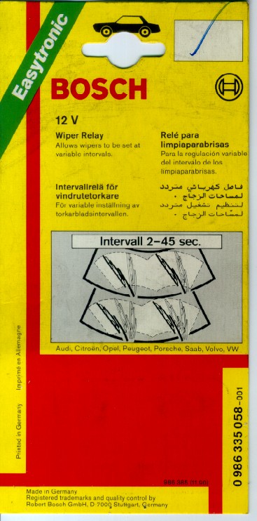

Get one of these. Bosch p/n 0 986 335 058-001, 'Easytronic' variable interval relay. The terminals should be compatible, & they really are the mutt's nuts.

So what's the deal on this relay? Is it NLA? I've got two that don't work. Is that generic Bosch relay a drop-in replacement or do you have to rewire?
