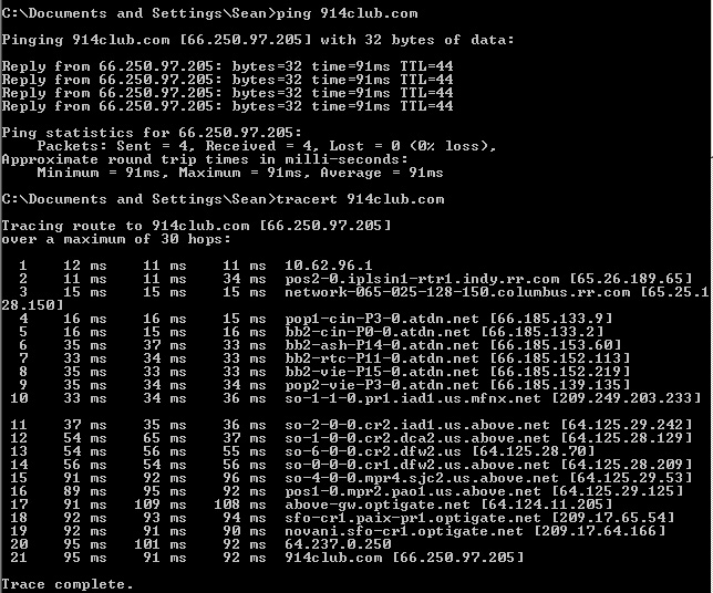

hey guys, how do I do a trace?

ok, figured it out:

QUOTE(seanery @ Jul 19 2004, 05:52 PM)
ok, figured it out:
same for you, hop 17, abovenet gateway ...
that has to be part of the reason why so many people see delays, this seems to be a major hop to get over here to the west-coast and it seems overloaded ...
Andy
