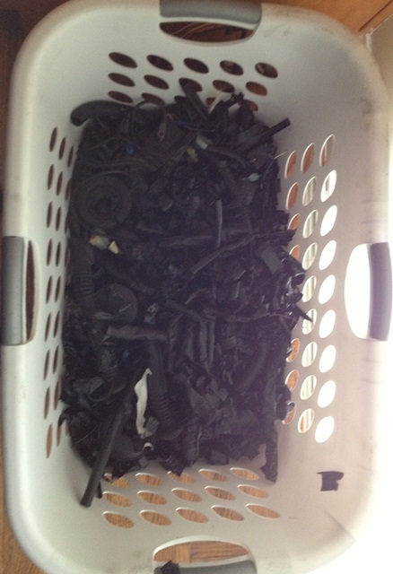

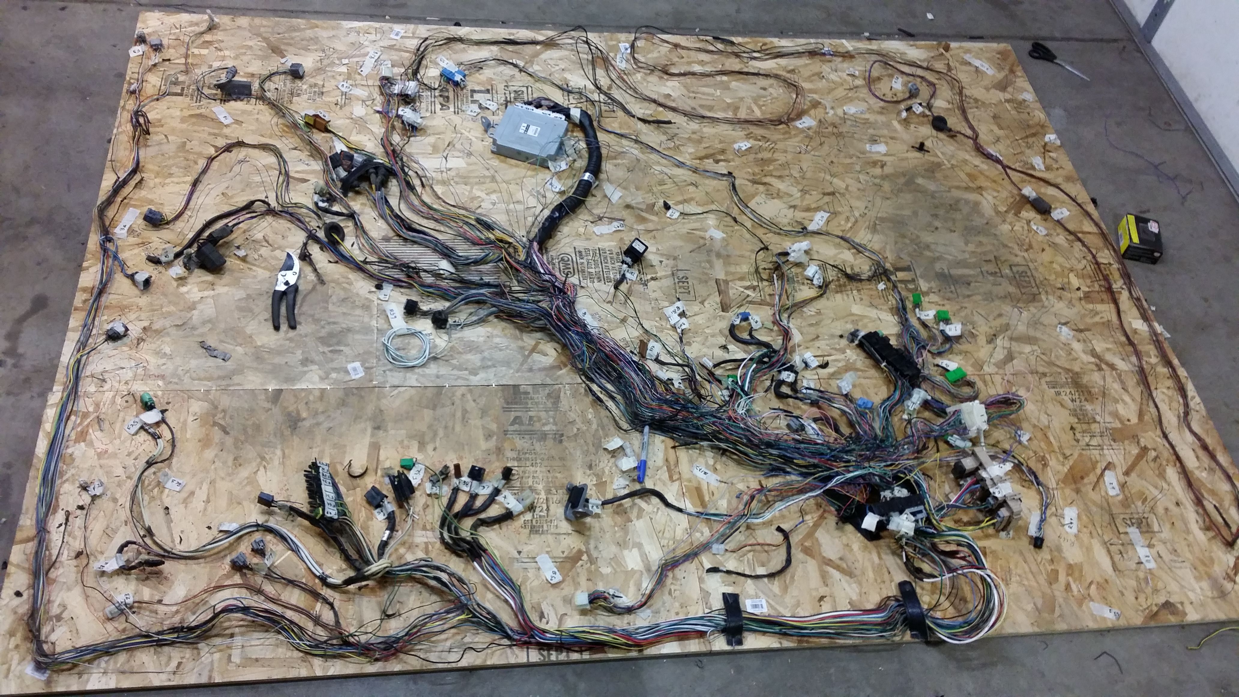

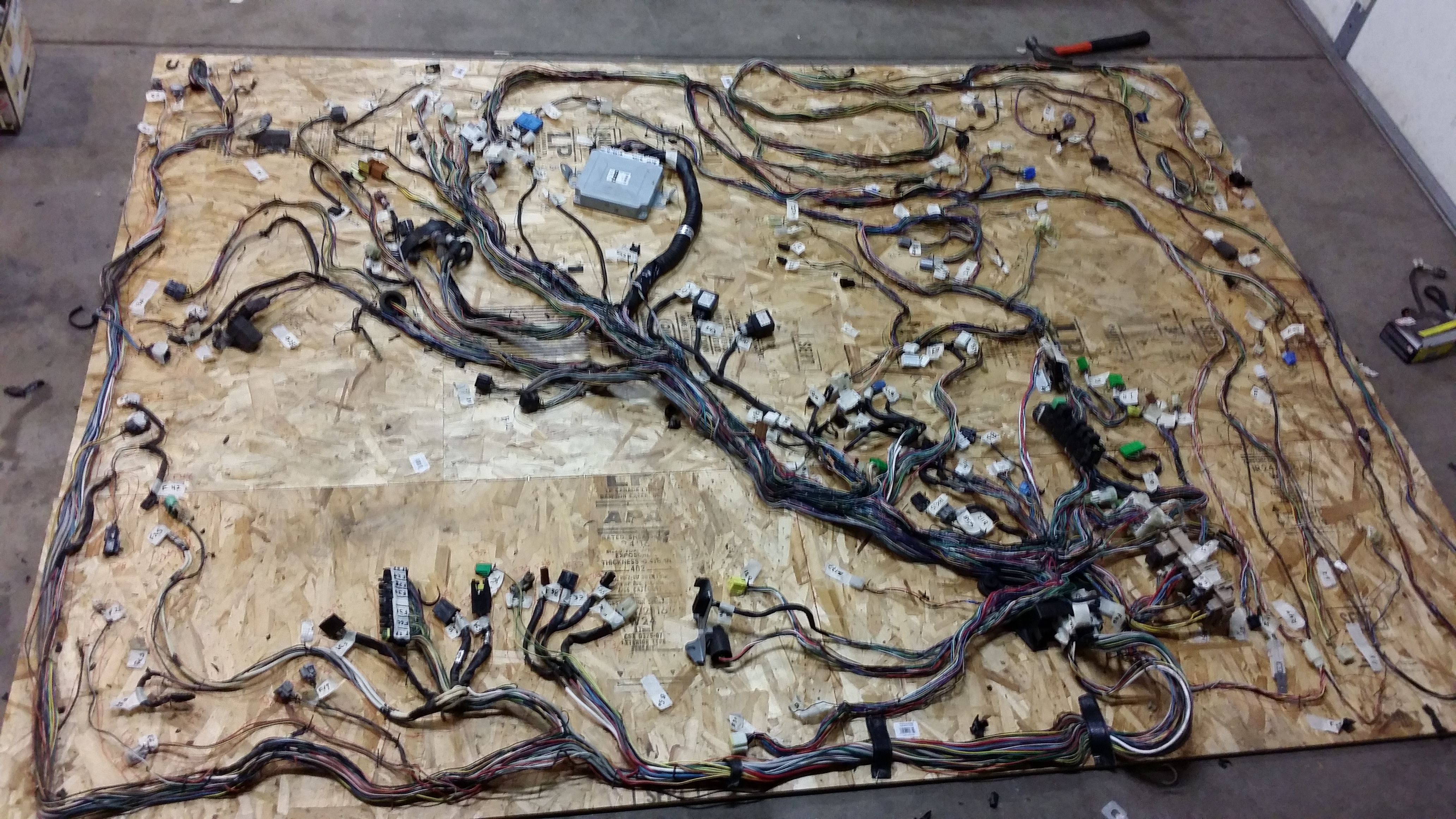

I am continuing on with the harness, I have finally gotten all the wrap off it and will begin stripping it down tomorrow! Holy cow my fingers hurt!

(IMG:style_emoticons/default/lol-2.gif) I for got how long it takes just to strip the sheathing. (IMG:style_emoticons/default/hissyfit.gif) FWIW, I as reading some Suby stuff the other nite and apparently it was used on '03 sixes. I didn't see any mention of it's use on any other 6 so................. who knows?

I used a bit of filter magic on an earlier post of mine.
Yeah I'm getting flashbacks...that was mind-numbing.
Whatever you do don't take the wires off the hooks! Leave it organized like you have it. I had a spaghetti mess. Totally my fault.

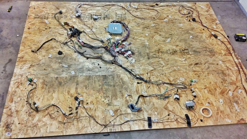

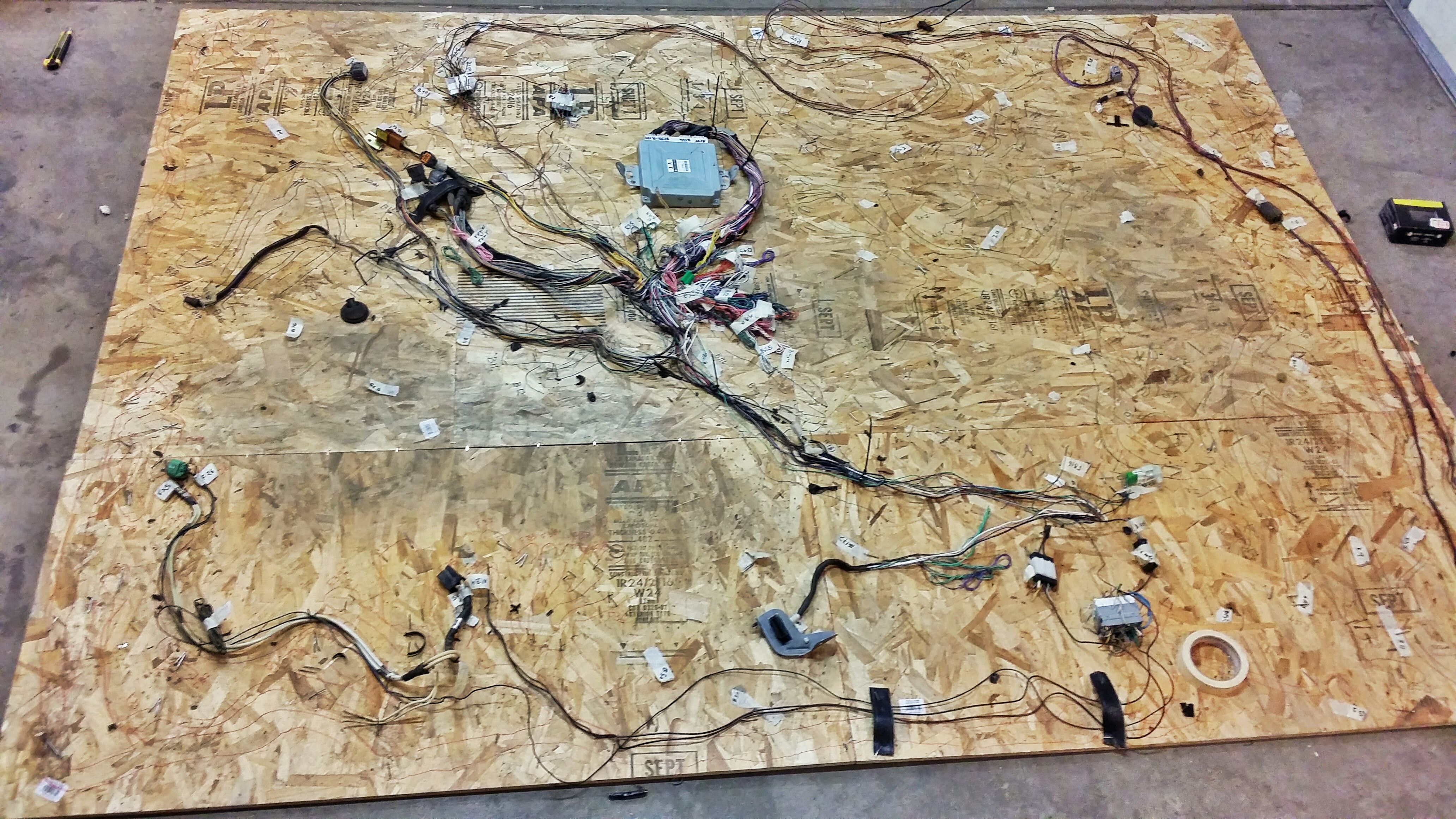

I've finally gotten the harness trimmed to about there I want it. It will need a few more wires removed, but I'm going to make sure it starts first!

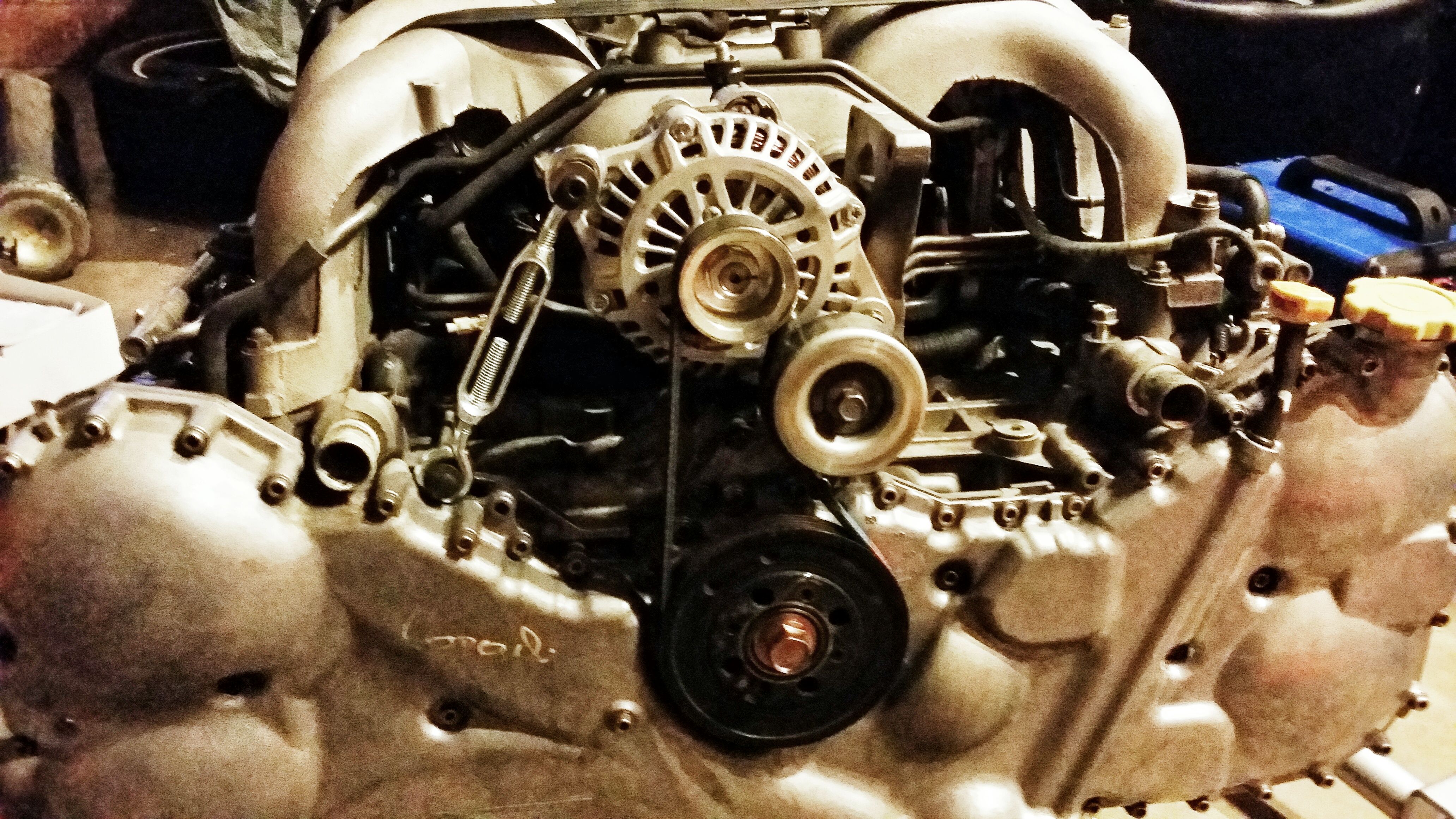

I also got the turnbuckle belt tensioner working. I tested the fit tonight, tomorrow I'll cut off the eye loops and weld on flat brackets in their place. It should work with cars running AC too, just a slightly different belt routing.

Once you finish that harness you want to go get drunk. Good job, Ross. (IMG:style_emoticons/default/thumb3d.gif)

Hey thanks for posting that tensioner! I need to make one of those. Tried to find a belt that was exactly the right diameter but it still slipped and squeaked like crazy.

It works pretty well! The belt I used is a Dayco 6PK0730. 29.4 in outer diameter. I'll let you know about the squeaking once I get it started up!

Amazing how much extra crap there is in a wiring harness!

[quote name='rnellums' date='Apr 2 2014, 07:30 PM' post='2019776']
Is that the SUPER MULTIPLE JUNCTION (SMJ) with just one wire going through it? (IMG:style_emoticons/default/biggrin.gif)
From 40 wires down to one. Almost there (IMG:style_emoticons/default/beerchug.gif)
76-914
post Apr 4 2014, 02:58 PM
Post #113
Posts: 13,876
Joined: 23-January 09
From: Temecula, CA
Member No.: 9,964
No SMJ in that pic. It gets tossed.

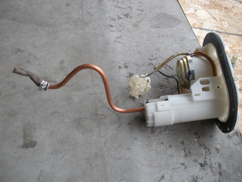

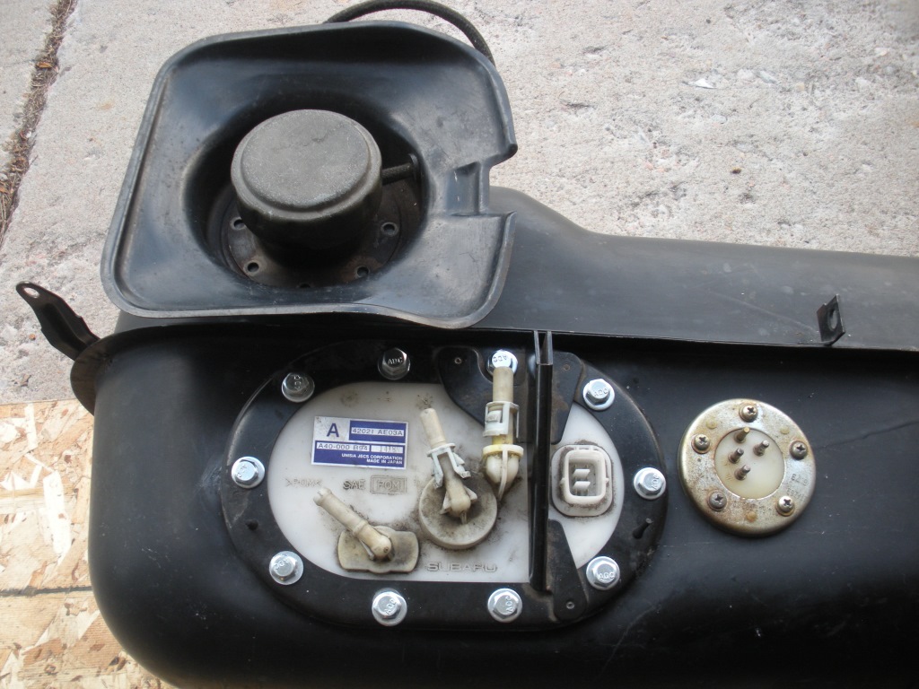

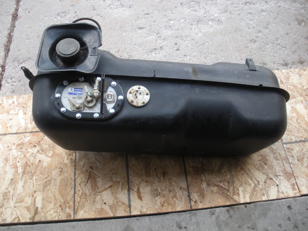

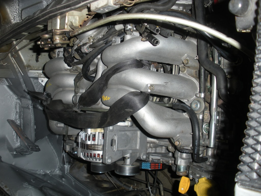

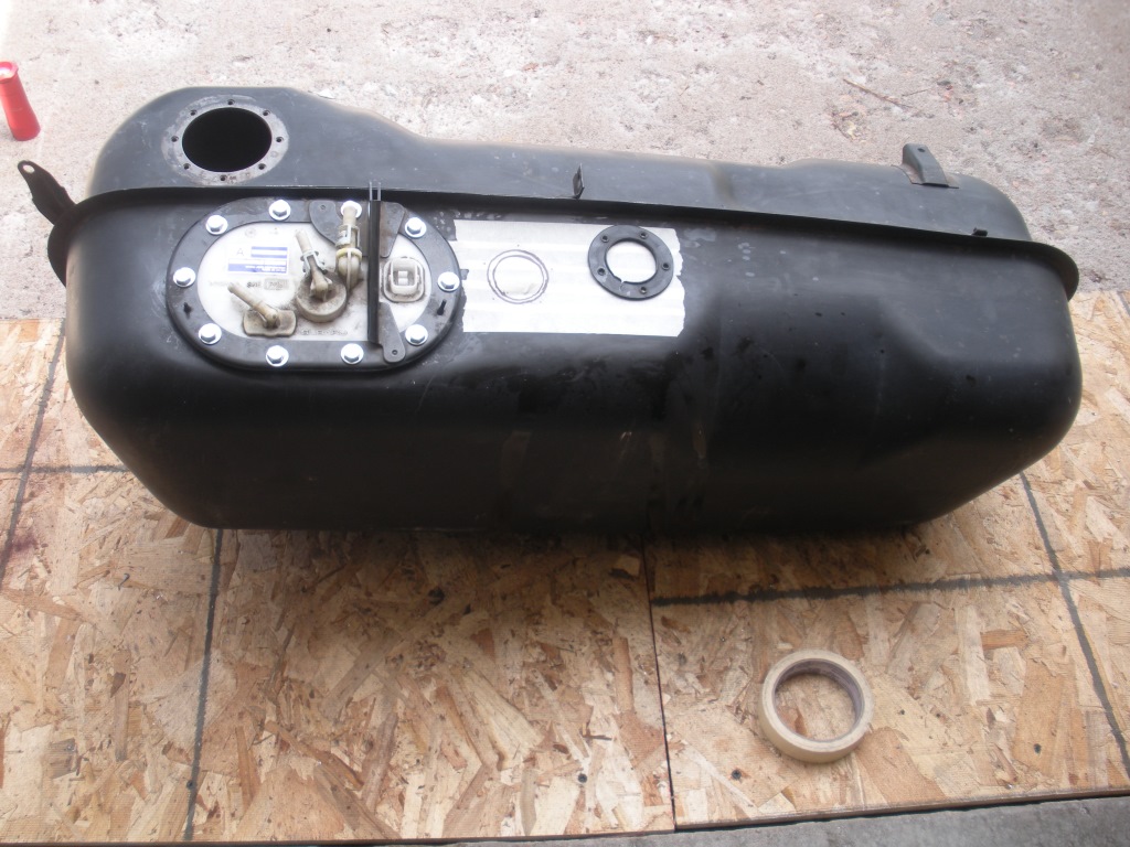

Made lots of progress this weekend! I have gotten the gas tank pretty much buttoned up, and am starting to get the engine in position so I can figure out what I'll need to do to get it to fit.
So first: the gas tank.

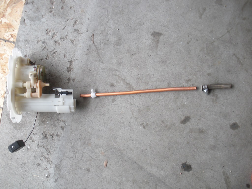

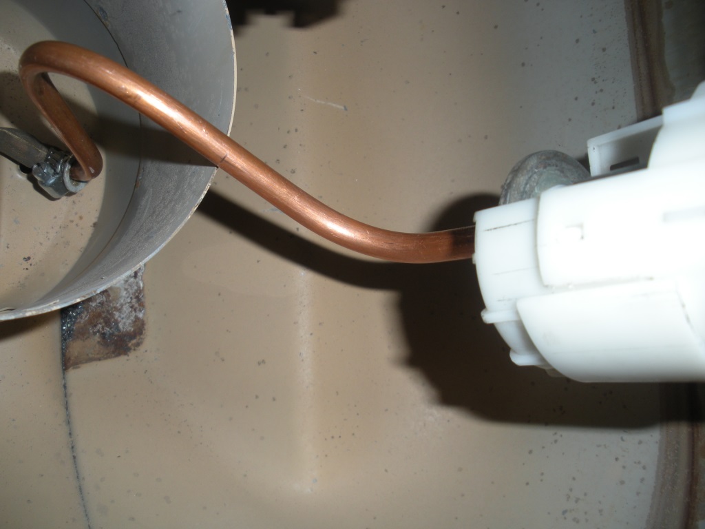

I borrowed pretty heavily from Kent's thread on his install of the subie fuel pump (from a legacy I think?) the biggest difference in mine is that I wanted to use the EZ30 fuel pump, but the pickup was too short.
I ended up modifying it with a bit of flared copper tubing to extend the pickup and place it where I wanted it. I'm using the stock 914 fuel screen clamped to the end of my copper pipe as a strainer.
When I started fitting the pump to the tank it was wide enough that the side of the tank started to round off, making installing the rivnuts difficult. I ended up bending and pounding the mounting area flat before installing the pump.

You're working fast! The tank looks great. Hey if you're planning to copy Kent's hose sizes like I am (which are a copy of Bob's) let me know. I have 50 FEET of 7/8 Gates green stripe indestructible hose that I got for very little. Can send you 15 feet or so if you want.

(IMG:style_emoticons/default/thumb3d.gif) Looks good, Ross. Did you get a pic of how you tied the copper in at the pump? I'm trying to remember what the problem was with it when I tried to use that same pump. IIRC, I was planning on using some surgical tube to connect their plastic sock to the pick up tube. As a matter of fact, I still have that tube in a glass jar filled with gasoline. I wanted to see if there was any degradation of the tube in gas. That was Sept 1, 2013. I'll pull it on it's anniversary to check again. It was fine after 3 mo's., though. Does that fuel sender need to be spun 180? Did you finish your wiring? If so, where did you connect the WL wire tagged "starter cranking"? Yellow starter wire or switched ign?

QUOTE(Chris H. @ Apr 21 2014, 06:33 AM) *
I'm afraid I already bought some hose (wish I hadn't now!) but I appreciate the offer!
QUOTE(76-914 @ Apr 21 2014, 02:59 PM) *

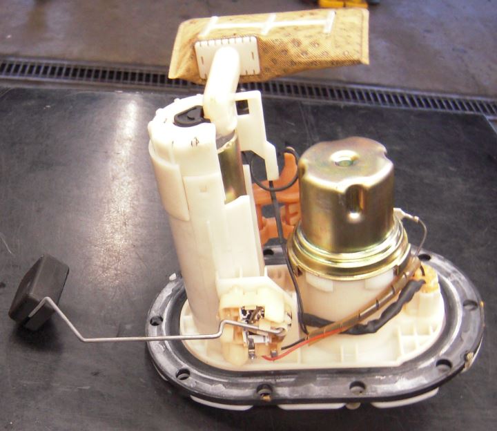

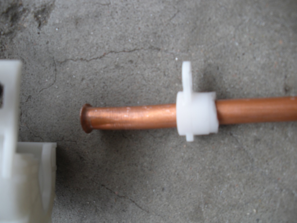

Kent, I dont have a great photo of it, but I'll attempt to explain with these. The stock fuel pump has a tiny outlet nub, too short to reliably attache a fuel hose to IMO. The stock fuel strainer is a fitted plastic cap with an elbow headed to the strainer. In Subaru's wisdom the tube headed to the strainer is U-shaped so you can't attach a hose to that either. What I did was cut the strainer fixture at the elbow, insert it over the copper before I flared it, and then use the stock strainer fixture to clamp the flared copper in place. I added a spring washer as well to improve the clamping force.
For the fuel sender, I am contemplating shorting it and eliminating the float and sender circuit altogether. Do you see any issues with that? I haven't finished up the wiring yet, but I'll probably go to the yellow starter wire, I'm not aware of any other connections that are only hot in the "start" key position.

I don't see any issues with shit canning those two items. You have the stock sender to use. I thought that the WL wire might go to that tab on the ign switch that goes dead when cranking but is otherwise hot in the on position. (IMG:style_emoticons/default/blink.gif) I guess the ECU interprets that signal. (IMG:style_emoticons/default/confused24.gif)

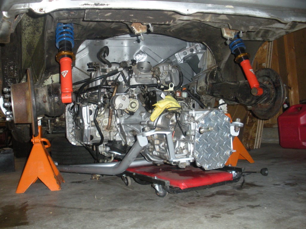

post Apr 29 2014, 07:36 PM
Post #120
Professional Enthusiast
Posts: 1,673
Joined: 26-November 09
From: Littleton, CO
Member No.: 11,072

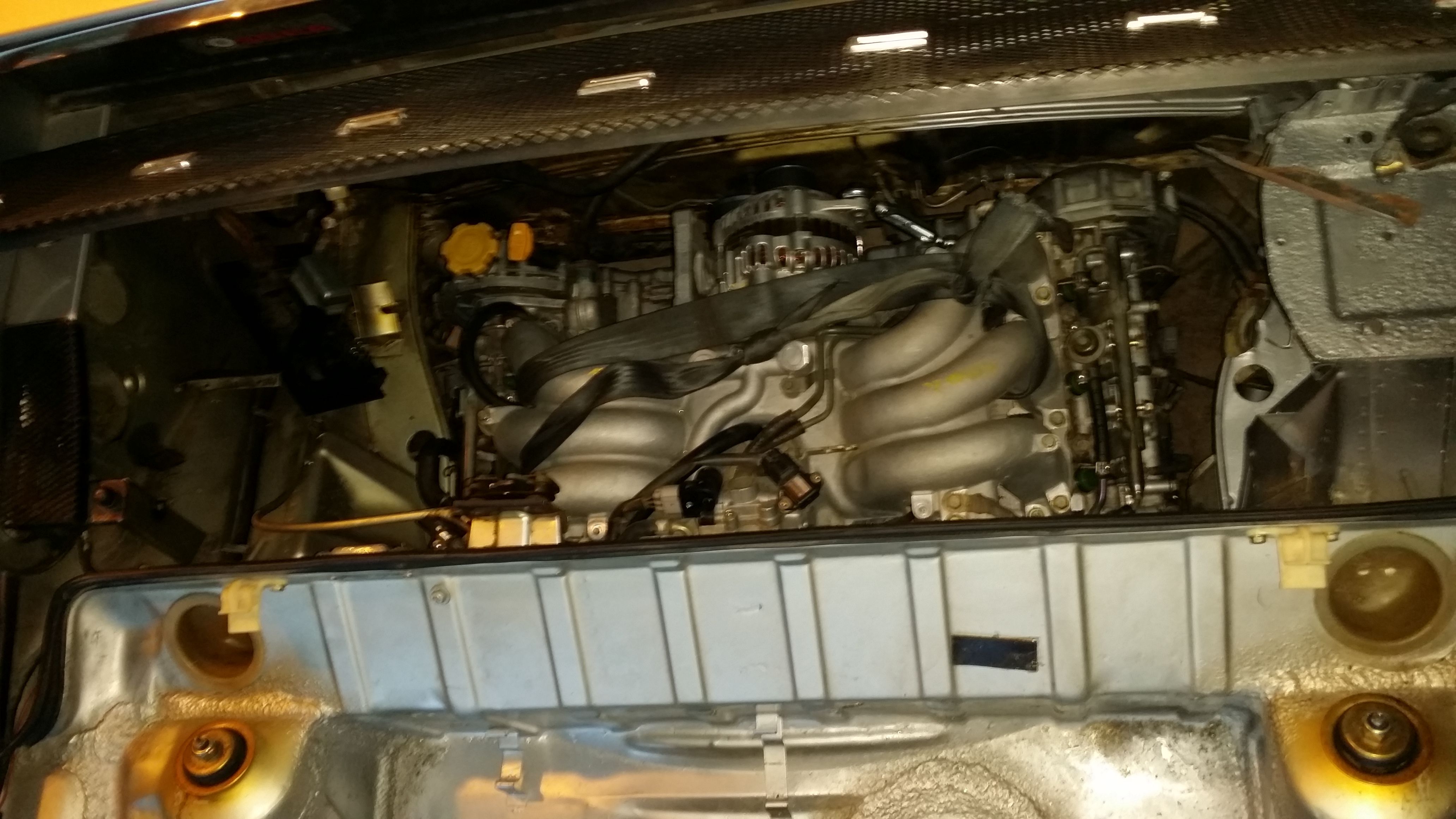

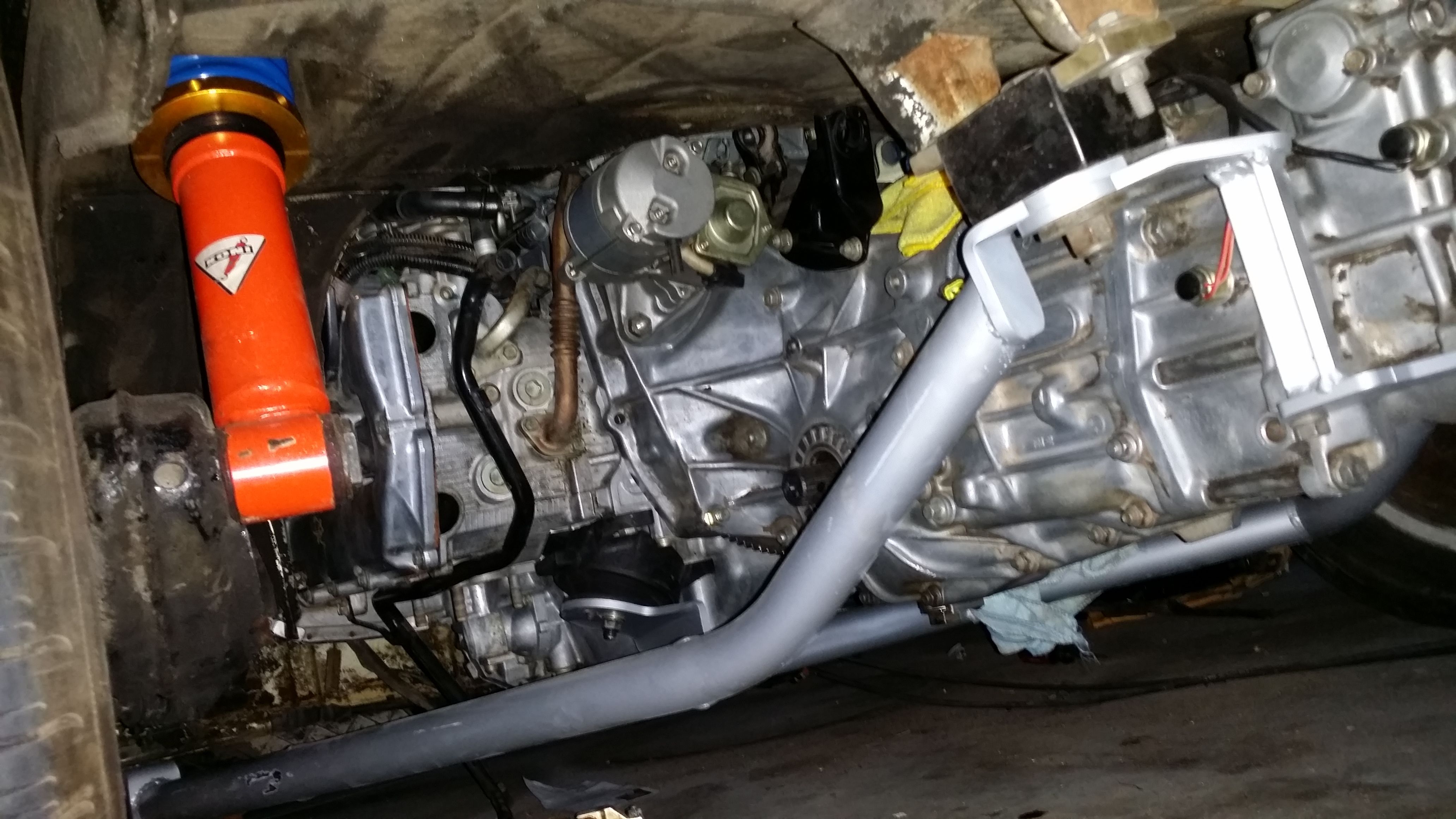

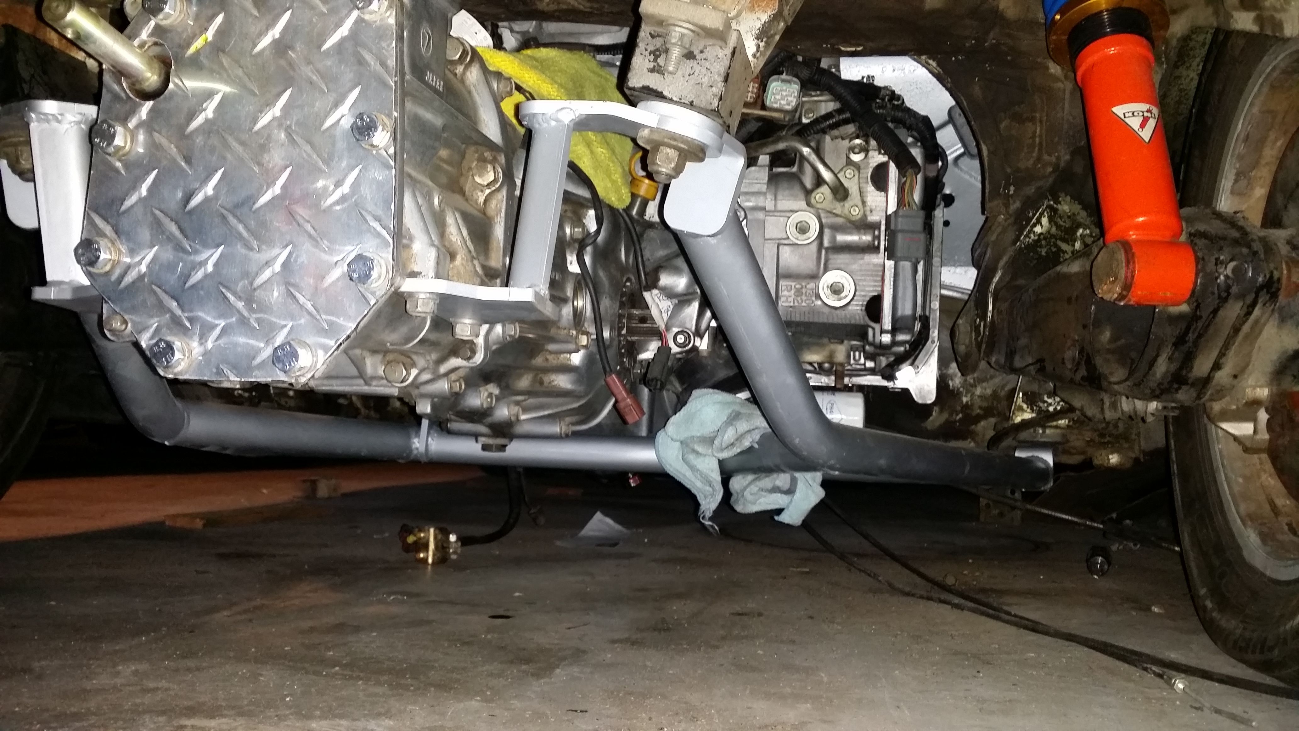

I finally got the engine in! No clearance issues to speak of as far as fit goes. I'll have to cut some space for the intake, and likely a bit of the top of the cable clutch fork, but the engine is in! Only 4 inches of ground clearance though, and even less once the exhaust is hung below it.
Is there a minimum clearance for lowered cars?
