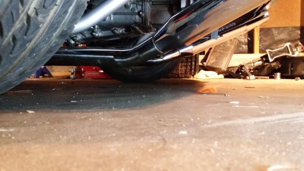

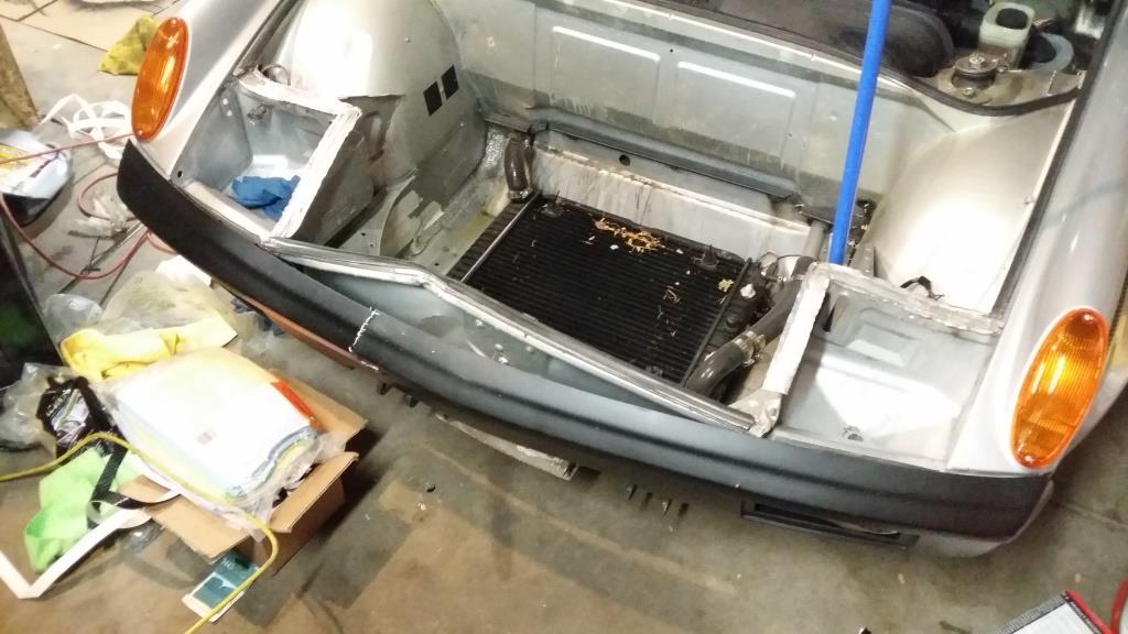

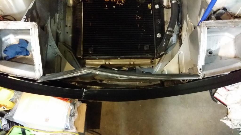

Well for anyone who hasn't seen my Calypso thread, I damaged the front of Apollo a week or so ago.
Its going to get fixed, but in the meantime I'm going to be starting to document the custom header setup I'll be building to replace my current pipes.

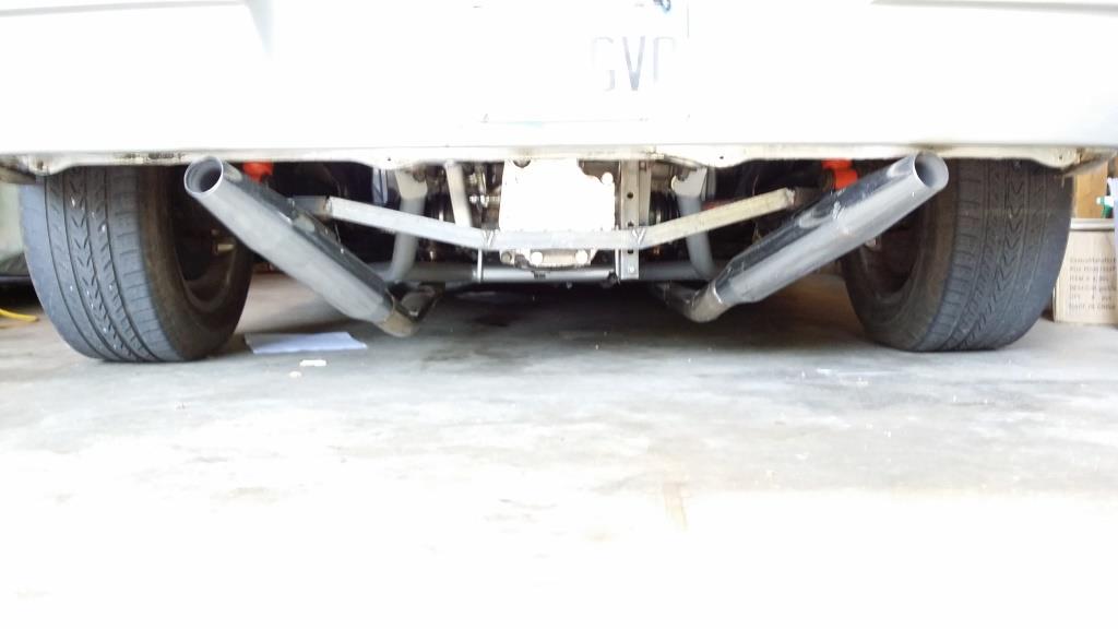

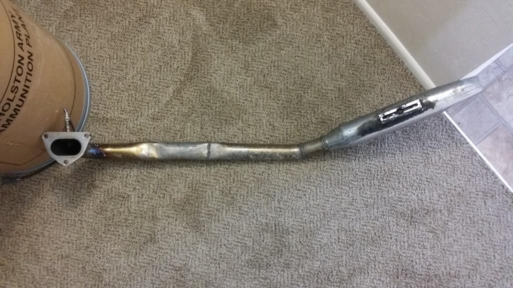

What I'm using currently is an aftermarket OBX header set that I chopped off before the collector and welded on two Harley Davidson motorcycle resonators.
The upside is this system is incredibly simple. The downside is twofold:
First, the pipes are routed underneath Ian's cradle, which severely impacts my ground clearance (makes me cringe anytime I go over any bump)

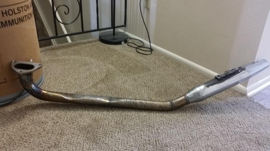

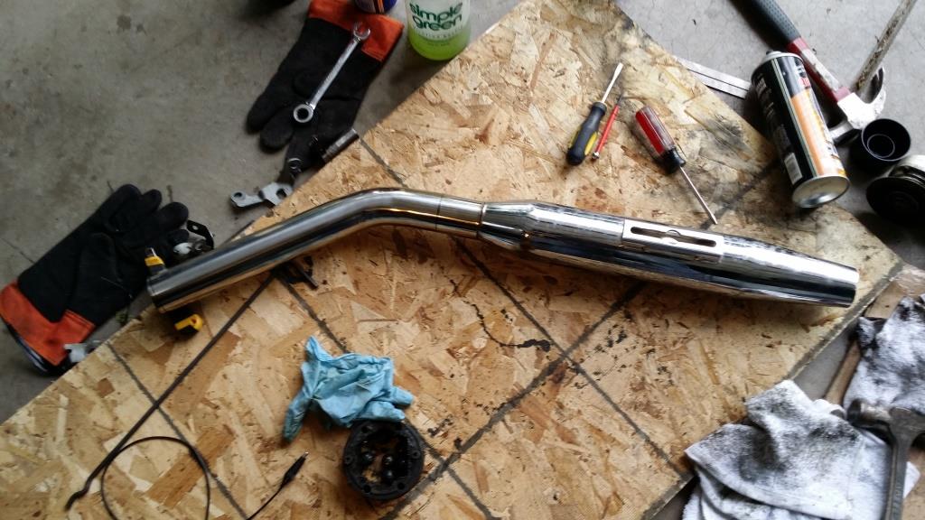

Second, the mufflers (resonators) are each built to handle 800cc spinning at 5500 RPM (2200 L/min), and I'm trying to force 1500 cc through them spinning at 6500 RPM (4875 L/min).

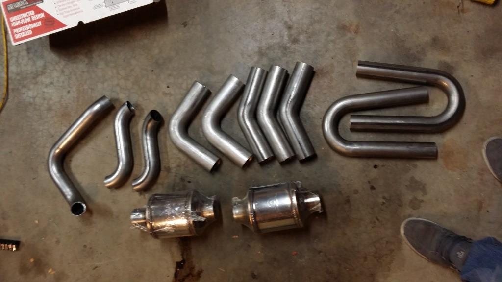

Marty at MSDS sent me an assortment of mandrel bends (some remnants, some new) which should be enough to get me started! I can't say enough how much I appreciate what Marty and MSDS do for our community, He has certainly been a big help to me!

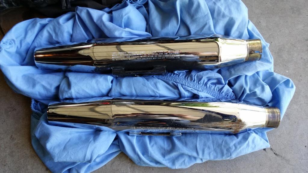

I also got a couple race resonators from Mark Z at Autoworks in Littleton.
They'll probably be too loud by themselves for street driving, so I'll likely end up porting them into a magnaflow 2 in 2 out muffler like this guy did on his 911.

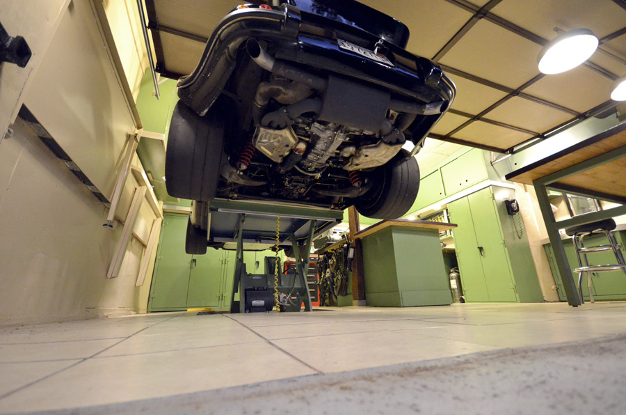

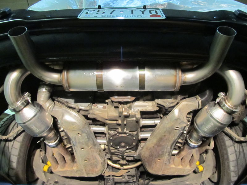

Or These 911's:
rnellums
post Feb 1 2015, 11:15 AM
Post #226
Professional Enthusiast
Posts: 1,673
Joined: 26-November 09
From: Littleton, CO
Member No.: 11,072
My current is to use 2" pipes for the initial exit from the header because the bends have a tighter radius, and then transition to a 2.5" pipe at a flange where it passes through Ian's cradle. I'm not planning to do any flex pipes as the entire exhaust system will be hard mounted to the engine and transmission, which is soft mounted to the frame. Thoughts?

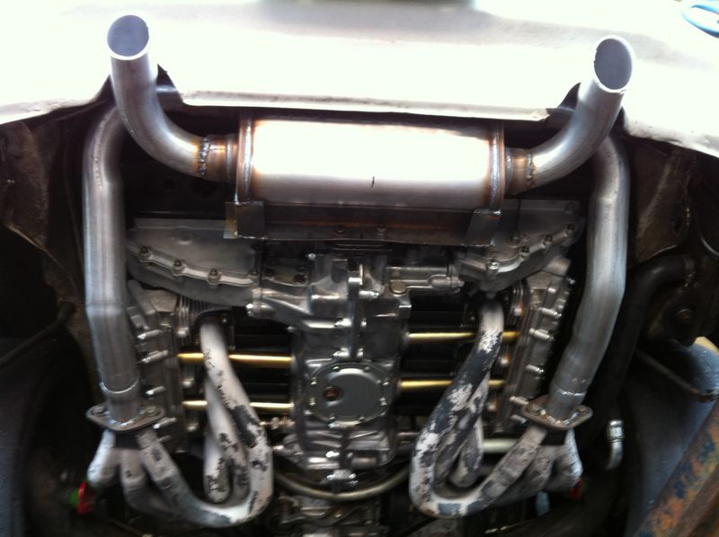

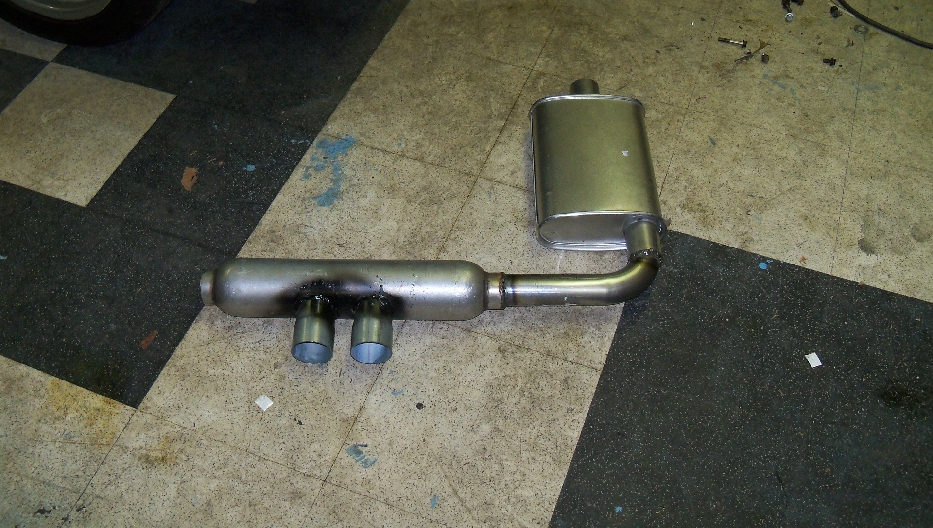

Bob's car was very quiet (for a Subaru). He did two mufflers into a center muffler. Here is a pic..
muffler

You can use a regular Camaro muffler, two in two out, that crosses between the transmission and the valance, fits and works great, cheap, super easy to plumb, and an outlet on either side is kind of different. And you can choose the brand, Magnaflow or whatever, according to the loudness/sound you prefer. Or alternatively, what would be my favorite, a two in one out Porsche performance banana. Problem with that one is what transmission you used and how much clearance the cradle positioning the tranny left between the end of the transmission and the valance. Need to measure. That would give you that Porsche six sound, if that's something you like.

QUOTE(DBCooper @ Feb 1 2015, 11:18 AM) *
The Camaro muffler is almost exactly what I was thinking.
The Porsche performance banana muffler would be great, but i don't know if it is worth the extra cost to me.

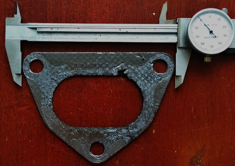

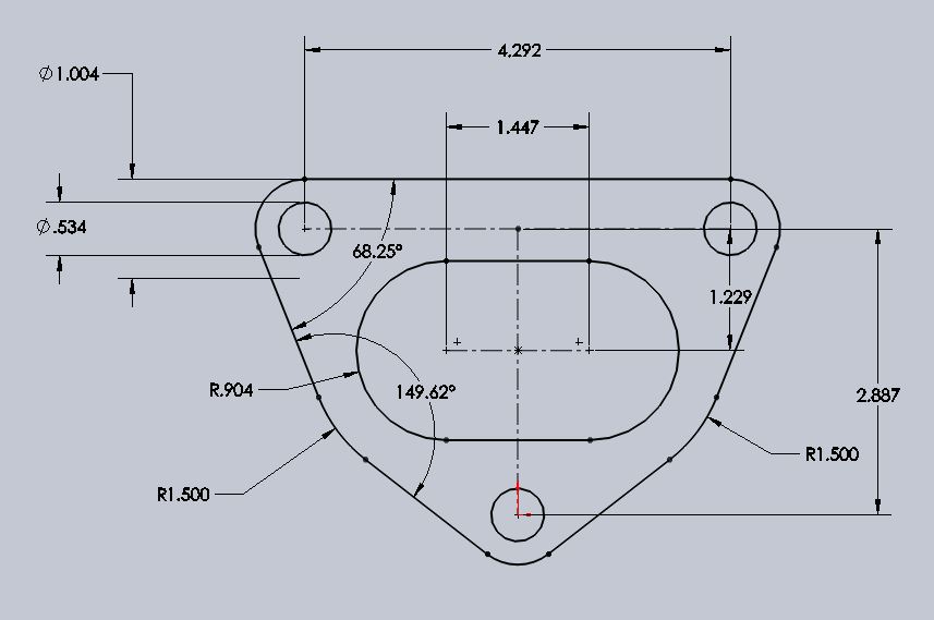

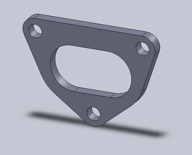

I just drew a flange up in SW based on a scaled photo I took of my flange gaskets.
I'll probably have these water-jet cut out of 3/8" mild steel if anyone else is interested. Having 4,6,8, or 10 cut is only going to be marginally more expensive than having 2 cut.

These people have EZ30D flanges in stock
Bob (IMG:style_emoticons/default/idea.gif)

QUOTE(BIGKAT_83 @ Feb 1 2015, 01:20 PM) *
I was hoping someone would chime in with something like that! I'll put them on order tomorrow!
