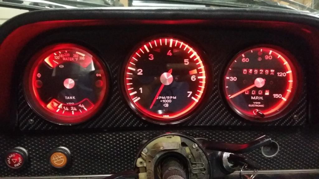

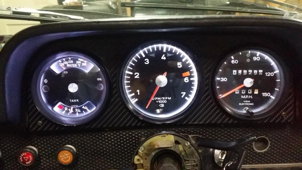

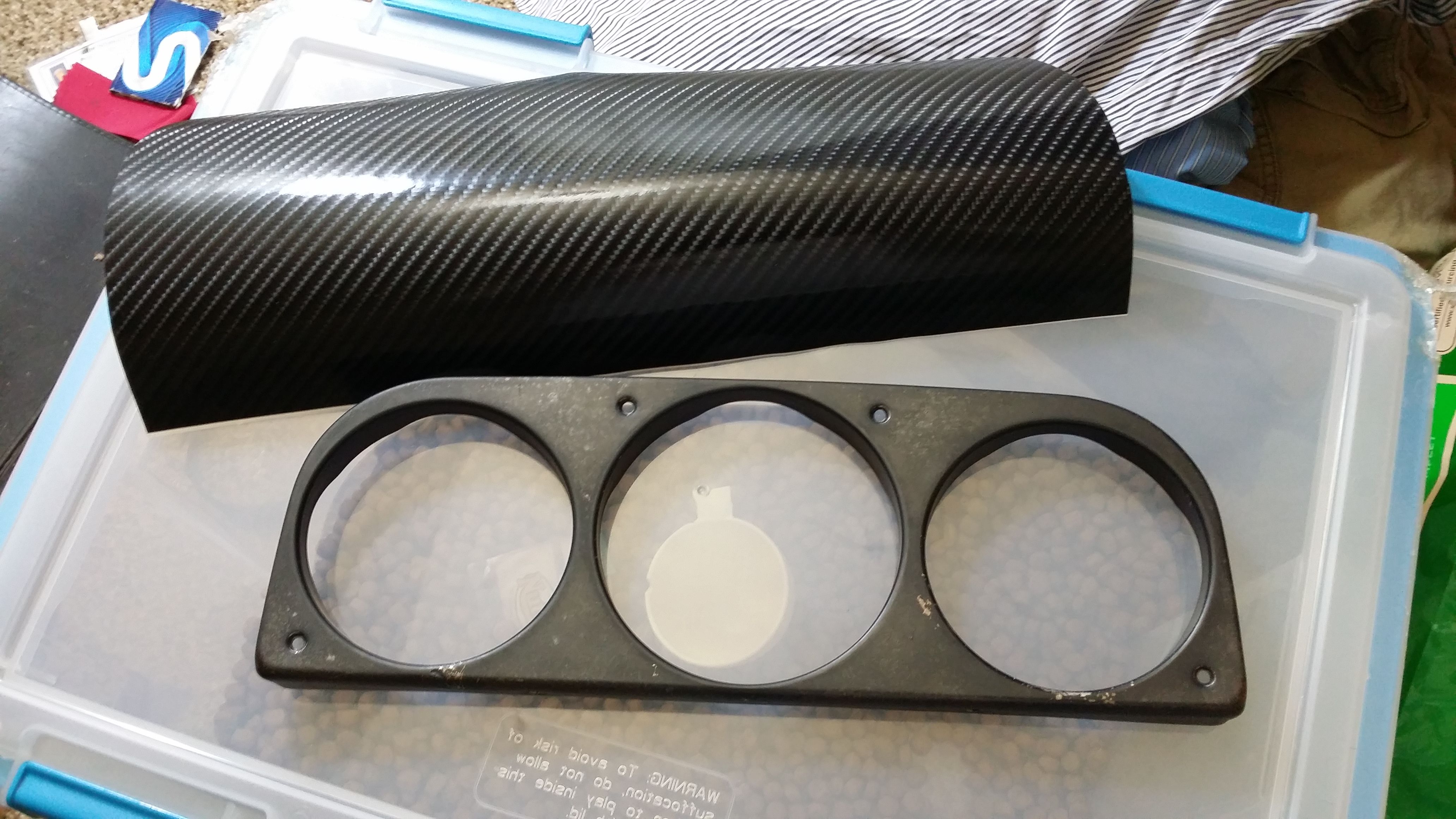

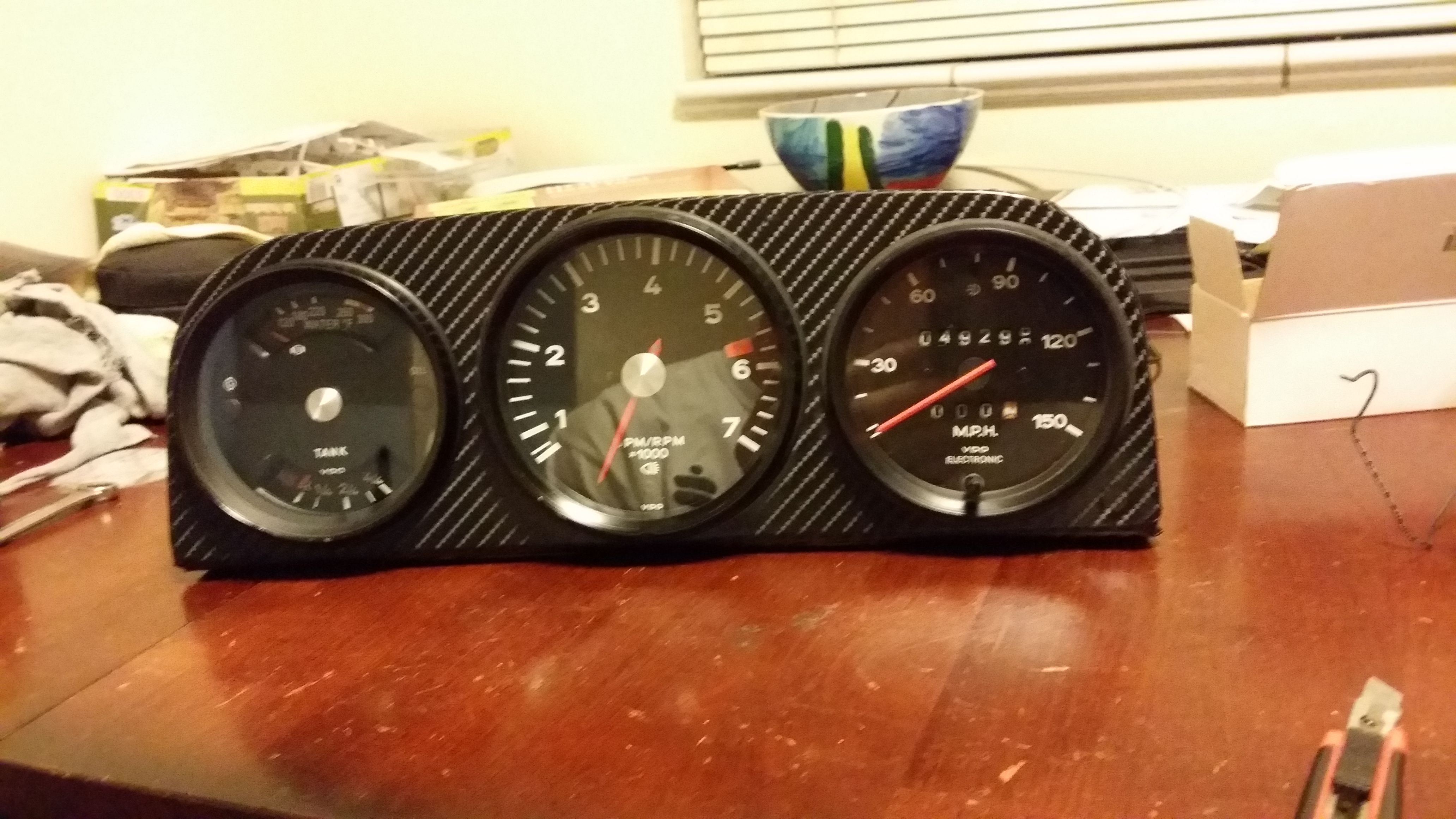

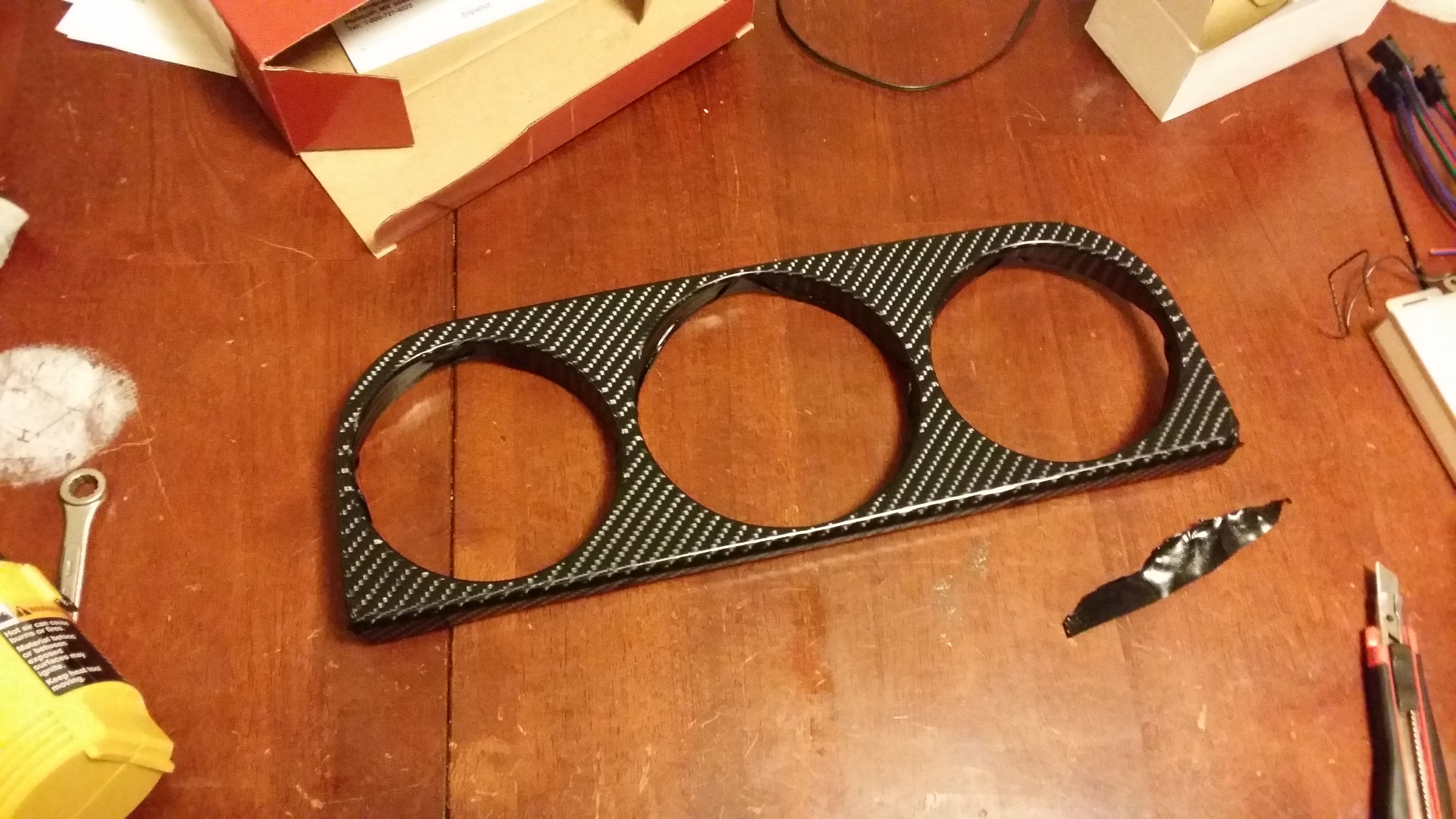

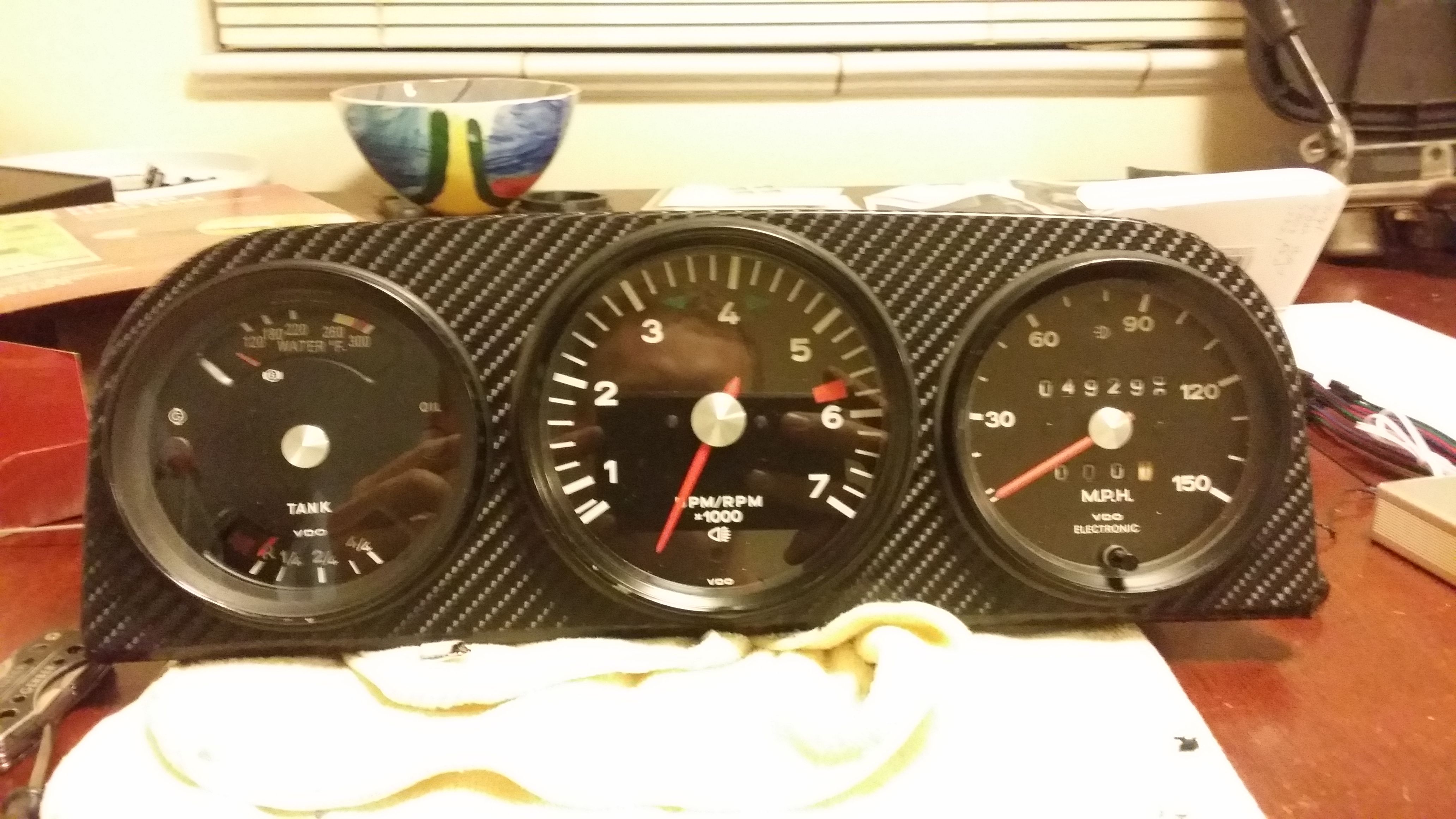

I played a bit of gauge dress up tonight with some spare carbon fiber vinyl I had laying around. Who knows how long it will last, but when I get tired of out I'll just peel it off and paint it.

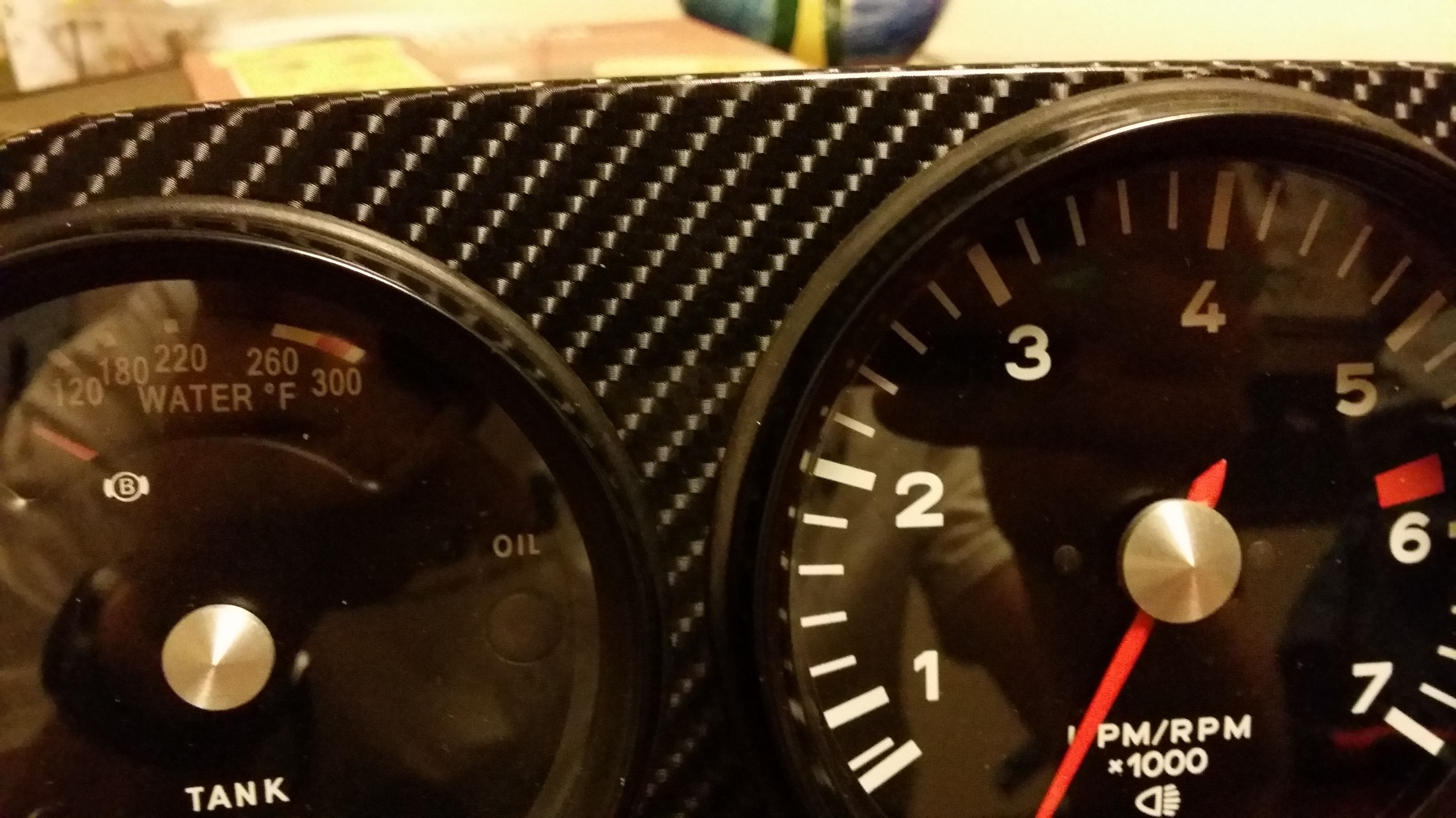

I must have missed this in your thread, is the water temp gauge in the combo gauge from a 924 - 944 - 928?

None of the above. It's from Tim. He also created the custom face too. It's printed on thick card stock. I think the gauge is from Jegs or summit. I'll be taking it out for a scale adjustment in a bit and I'll take some photos.

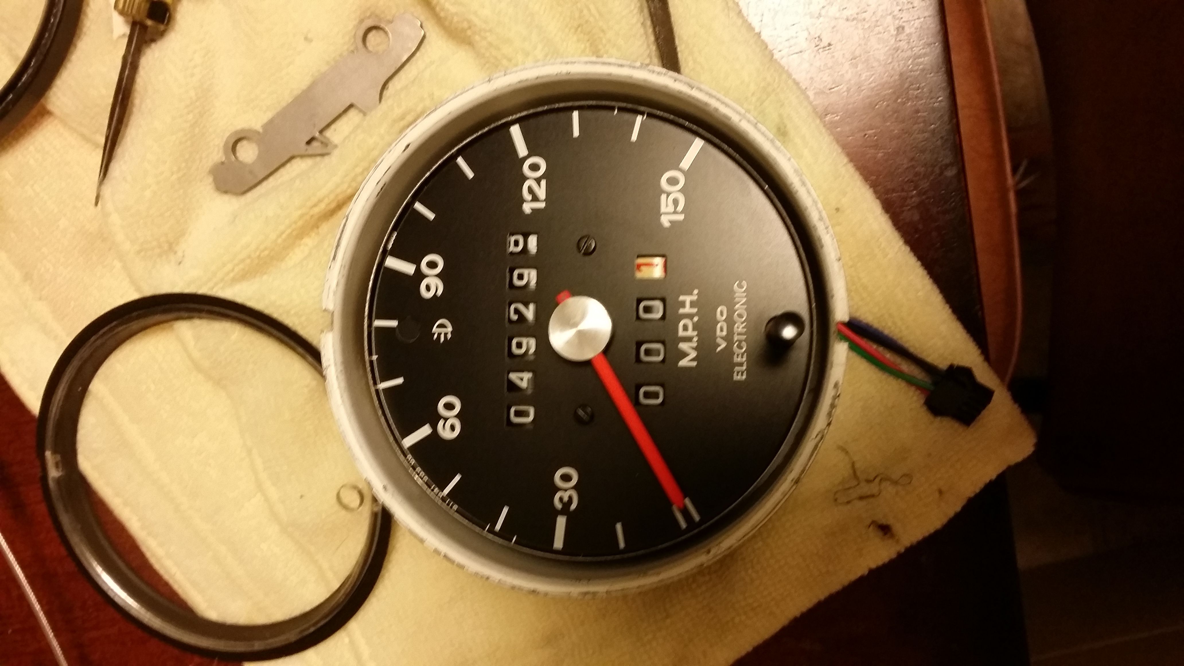

I added a silver button to my speedometer tonight. Now it will take a keenly trained eye to realize anything is out of the ordinary!

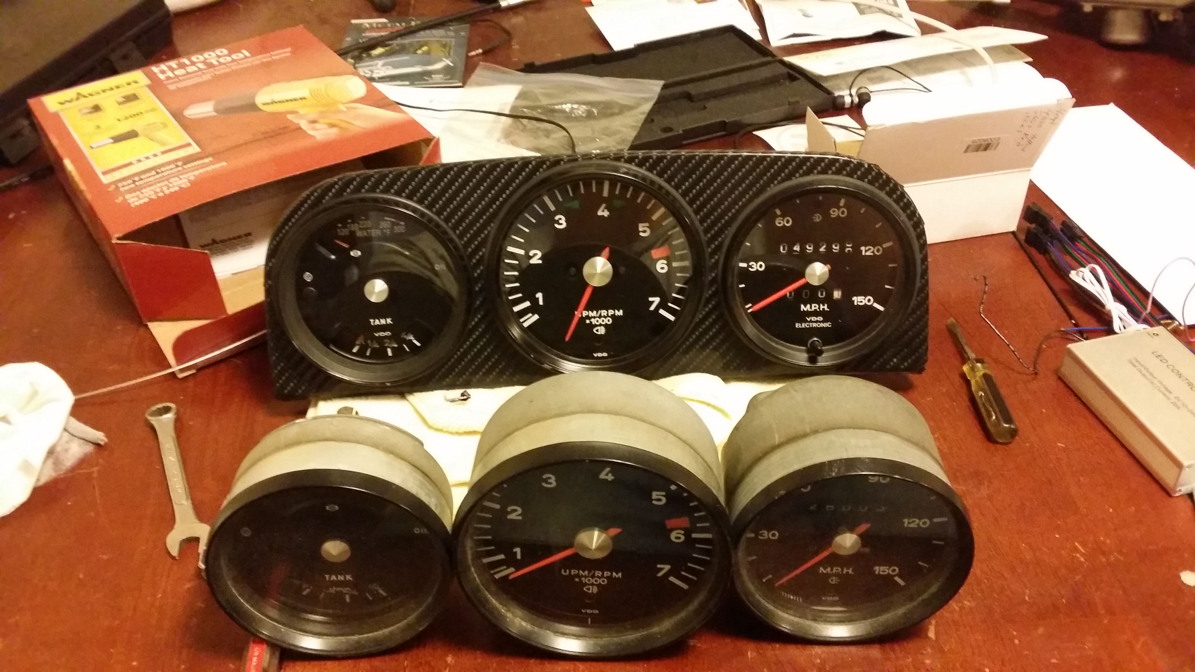

Tim's custom gauges are now wired in! The stock look with new internals and some sweet color change action, all for less than the Speedhut Gauges!

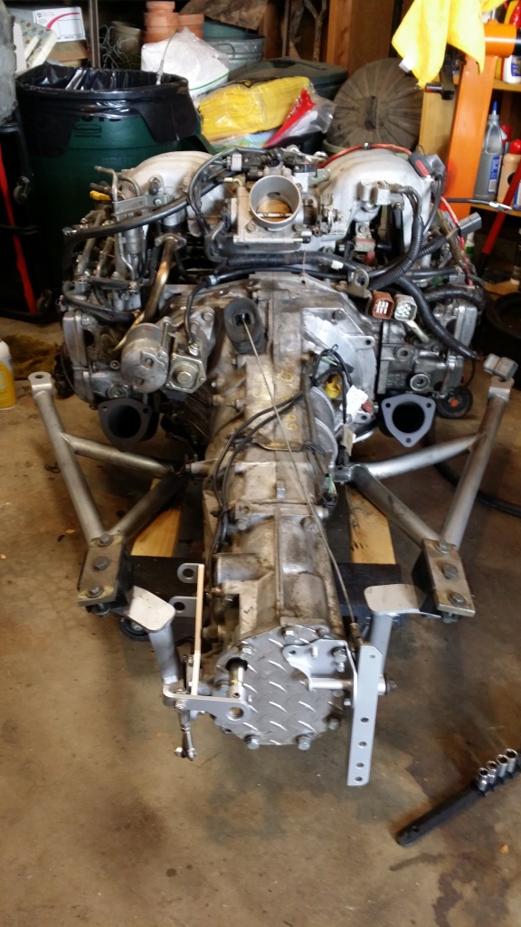

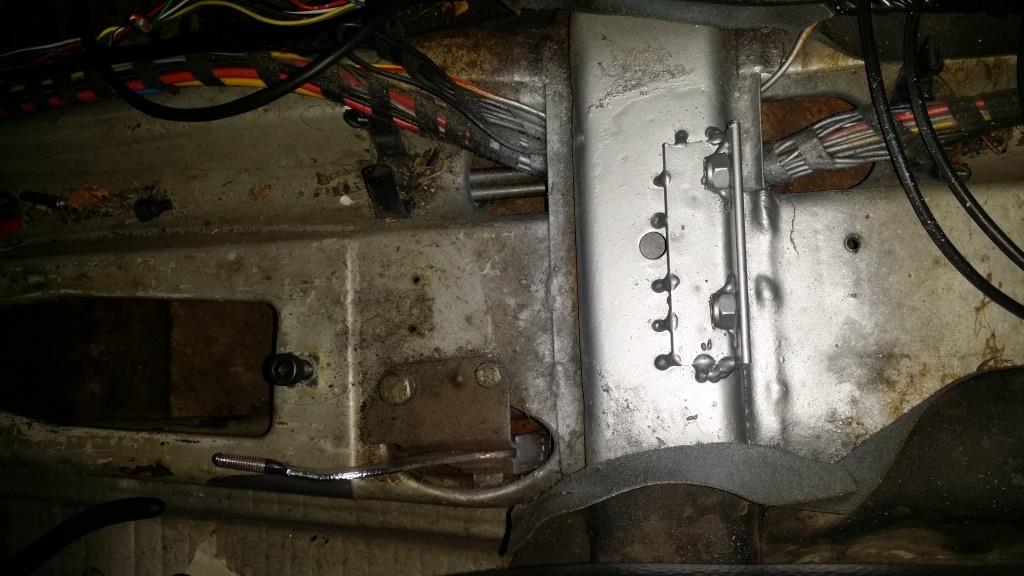

Yesterday was really productive, with the engine out I took some time to clean up the engine bay.
I have decided hat I'm unlikely to go back to the stock engine any time soon, so I stripped the unnecessary extra stock wires out of the engine bay and deleted the relay board connector.
I added in Some proper P-clamps for my fuel lines so that I could run the wiring back inside the stock clamps as well. I also installed new clutch and accelerator cables, and plugs for the shifter cables, the old heater controls, and the coolant hoses where they pass into the longs.

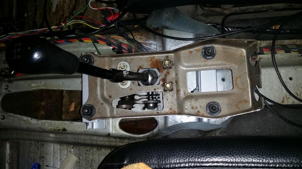

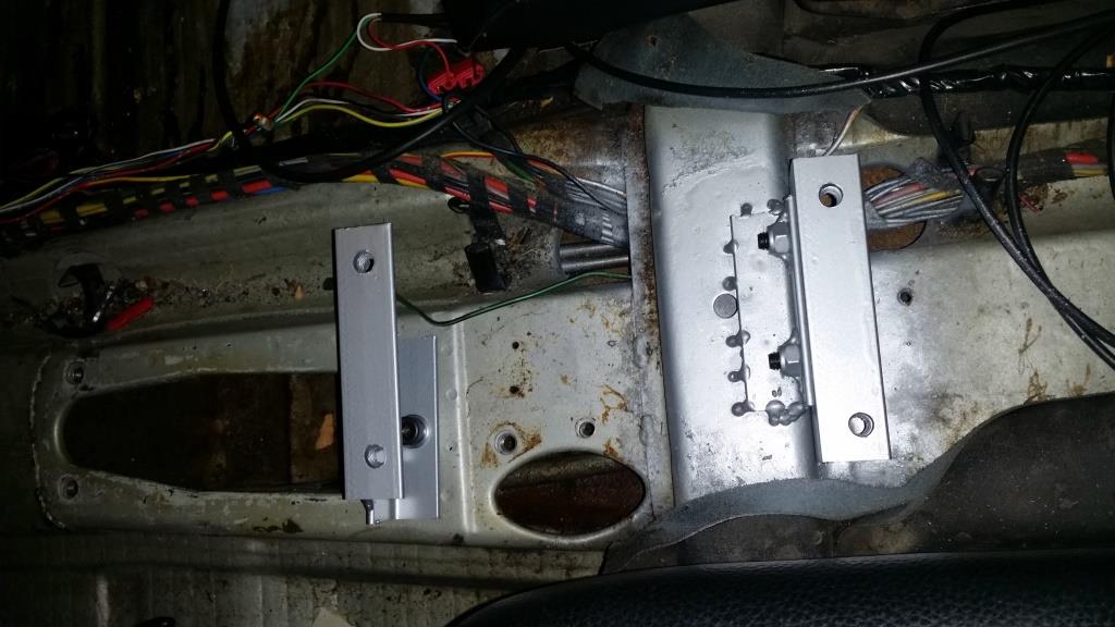

I painted and re-installed the shifter and supports

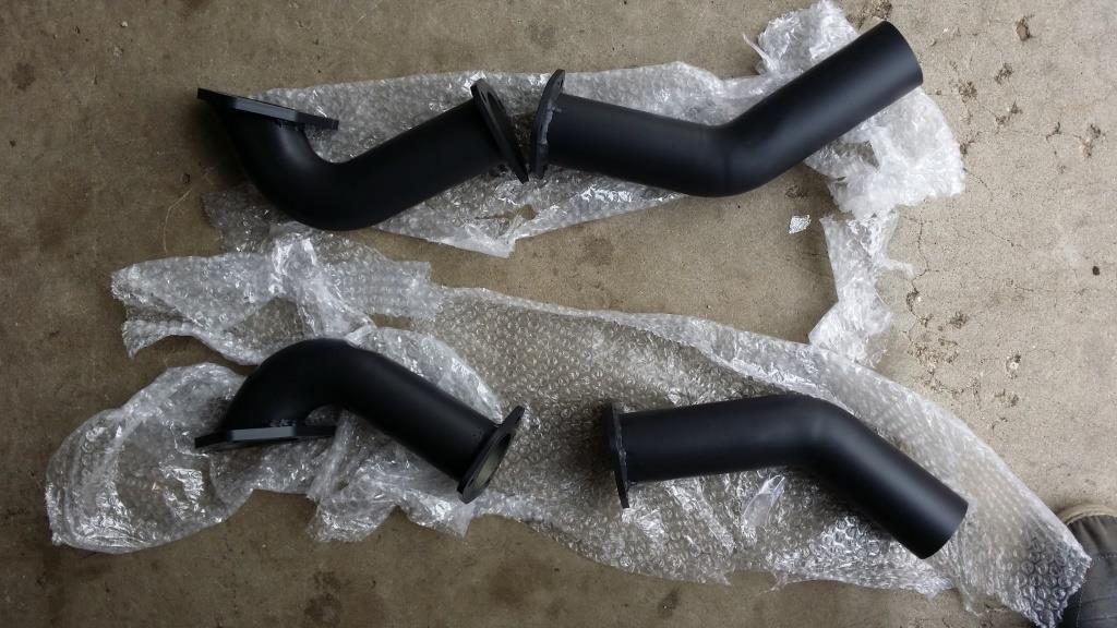

And, I got my ceramic coated headers back from the powdercoater. I wen't with black instead of the chrome because it was better recommended by the powdercoater, but also because I thought chrome would be a bit too much bling!

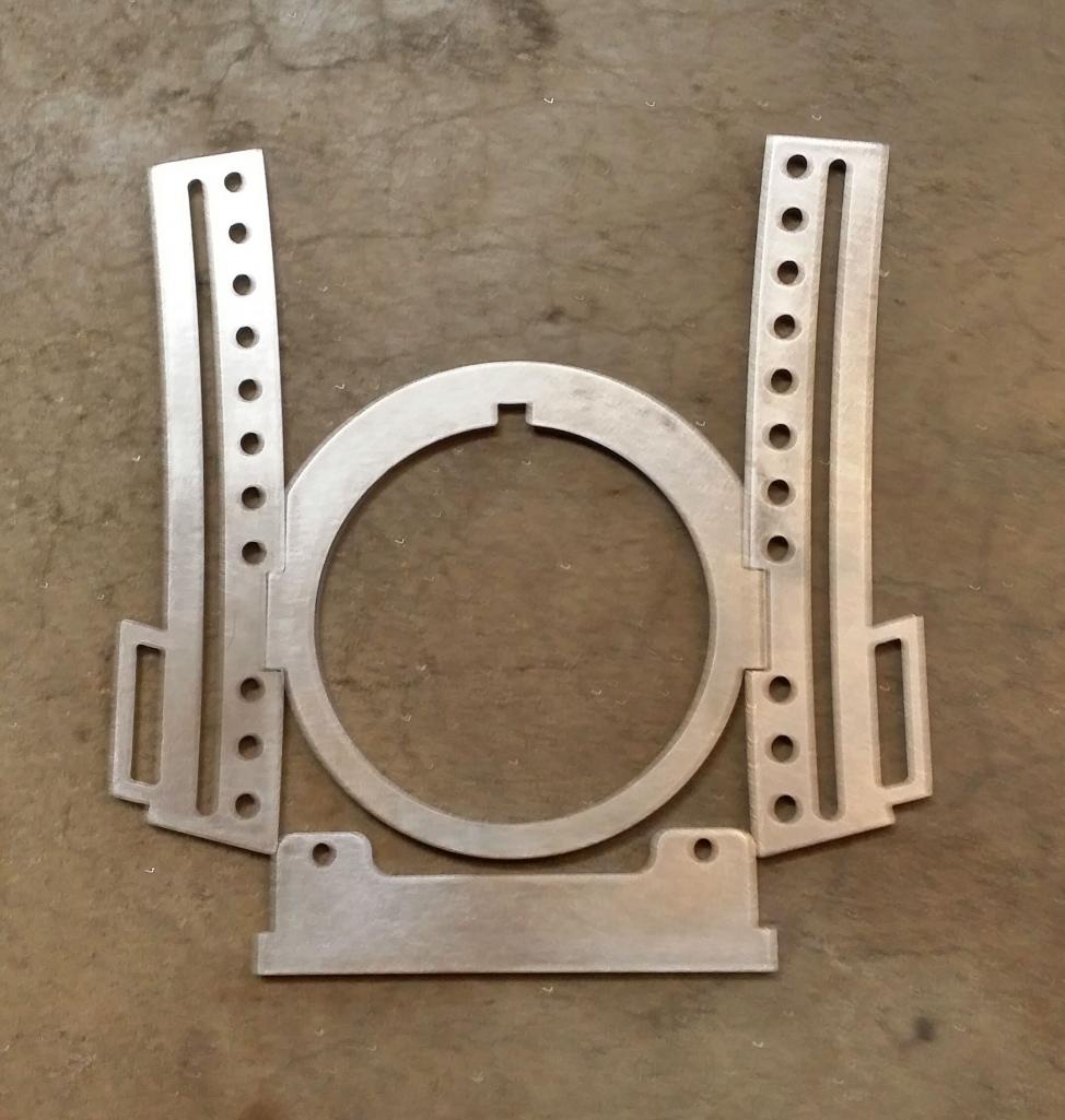

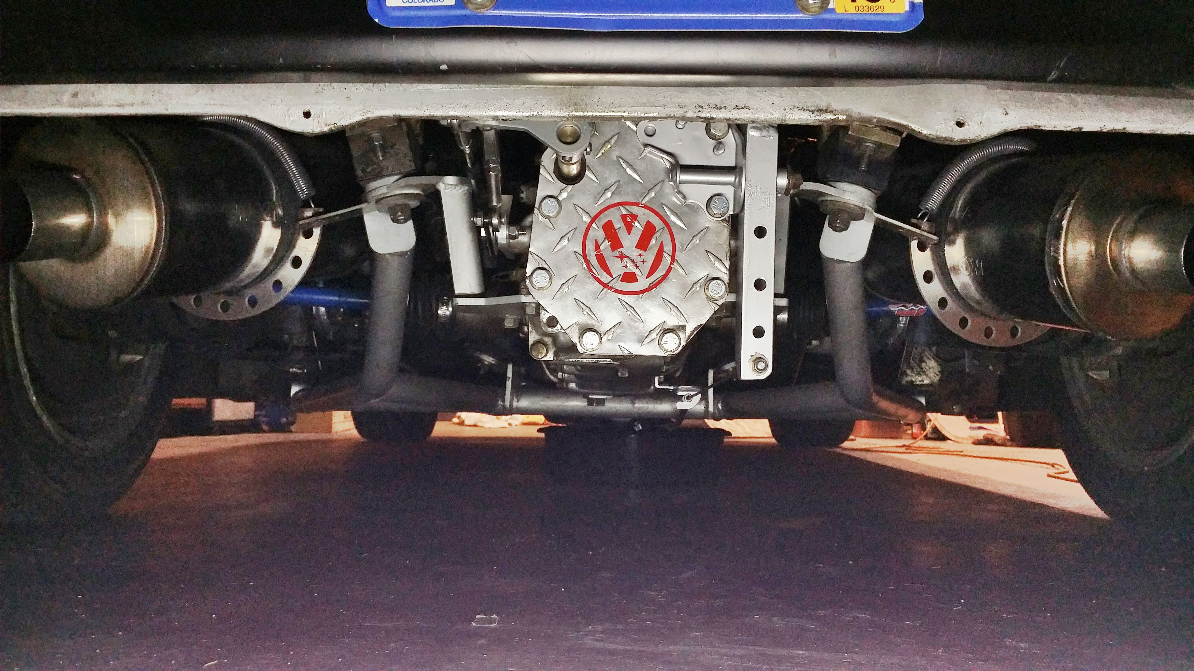

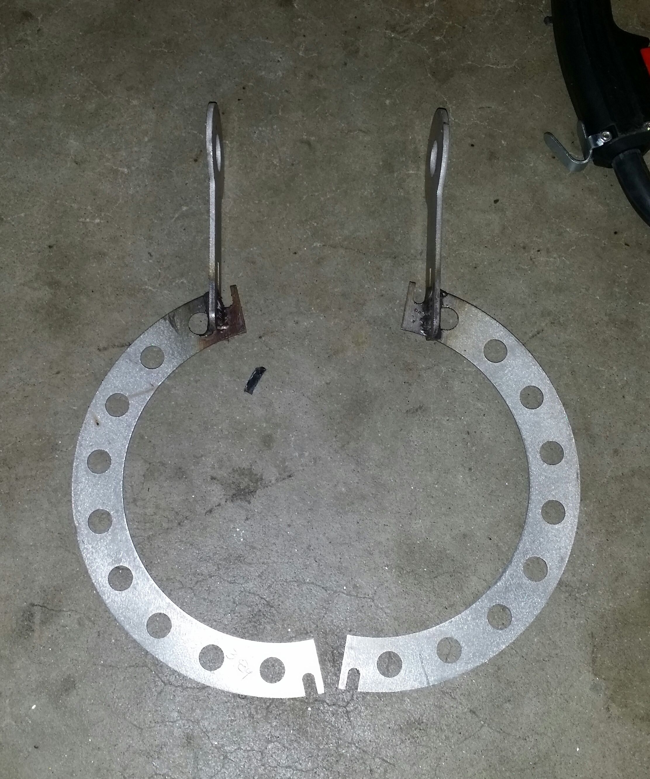

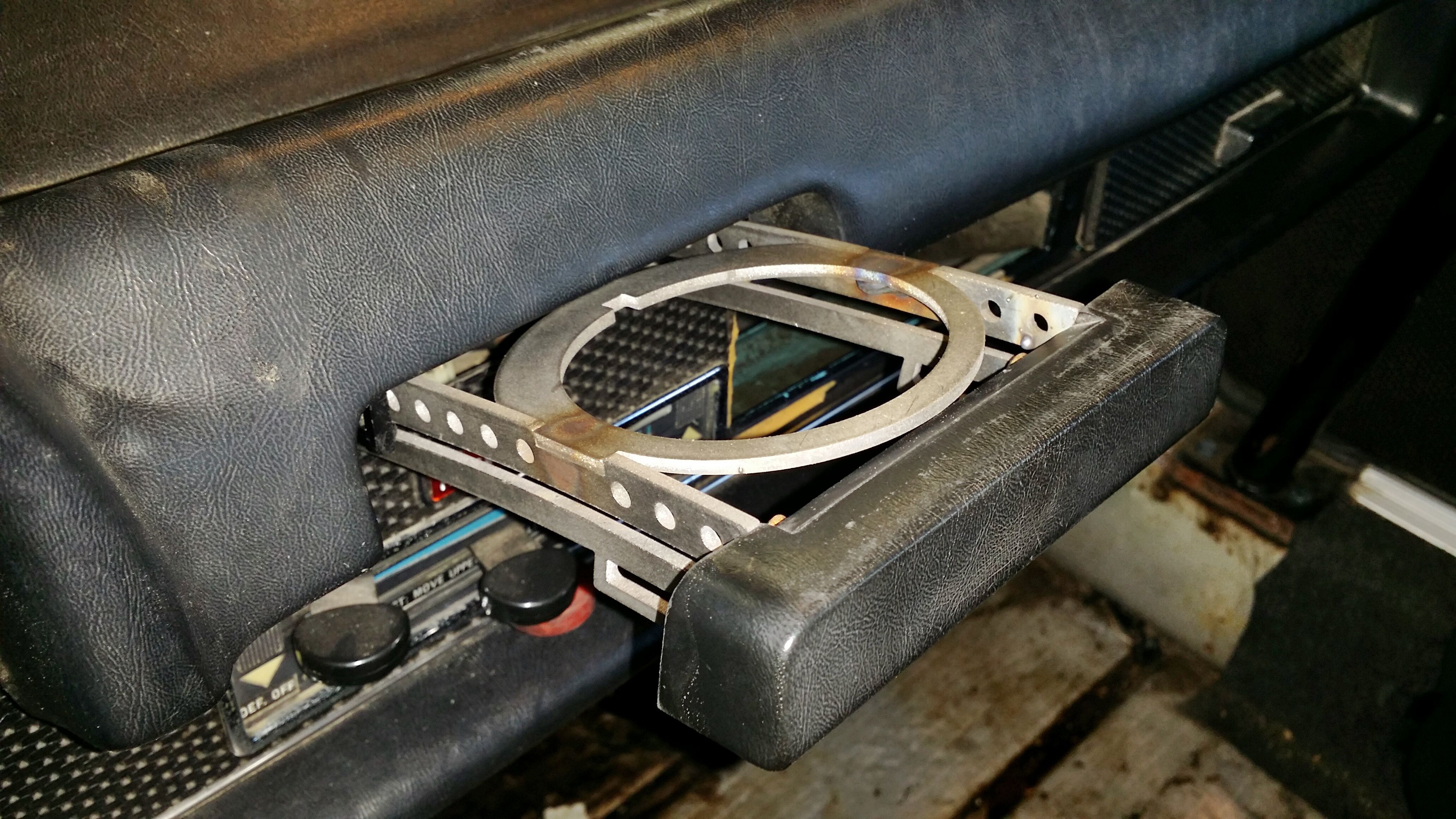

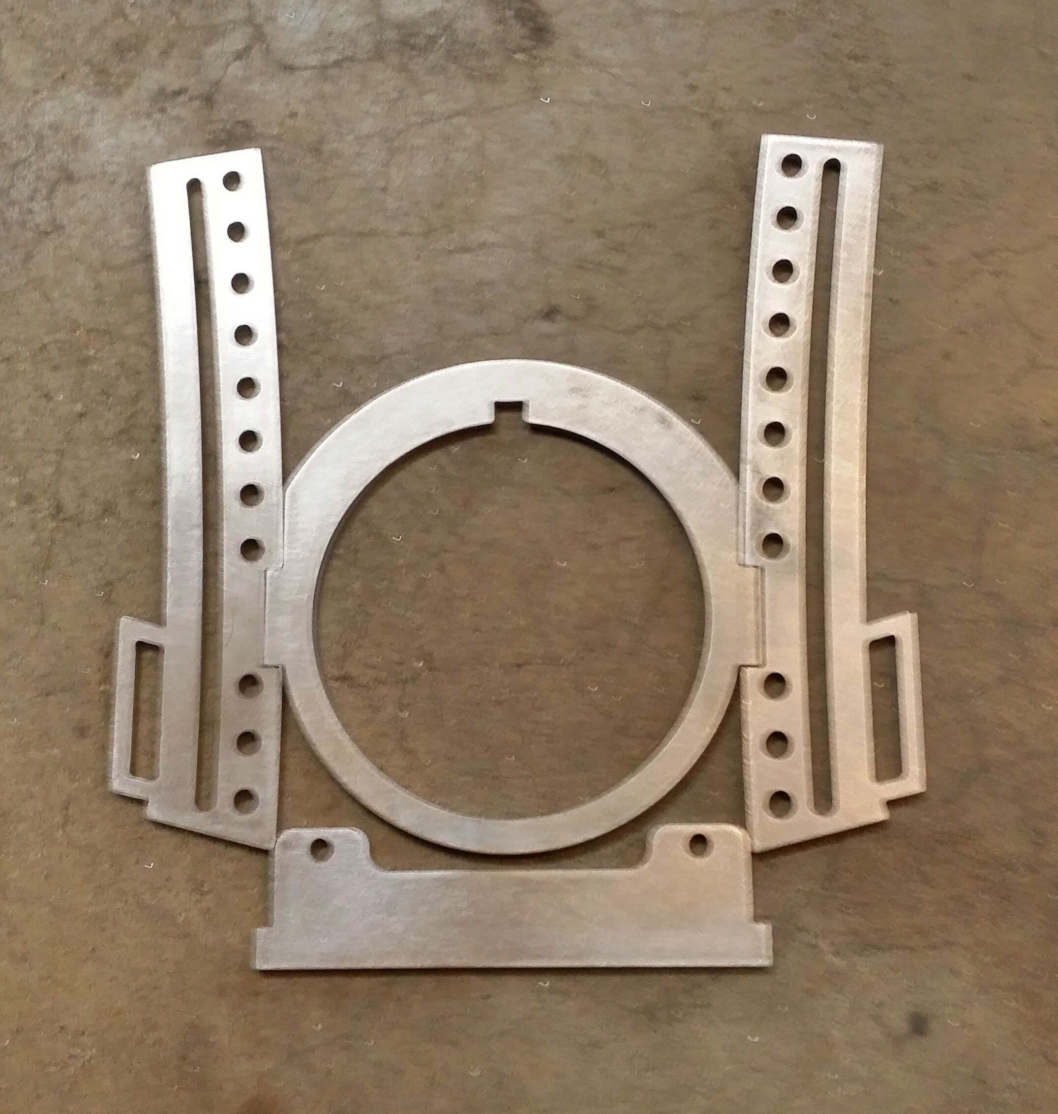

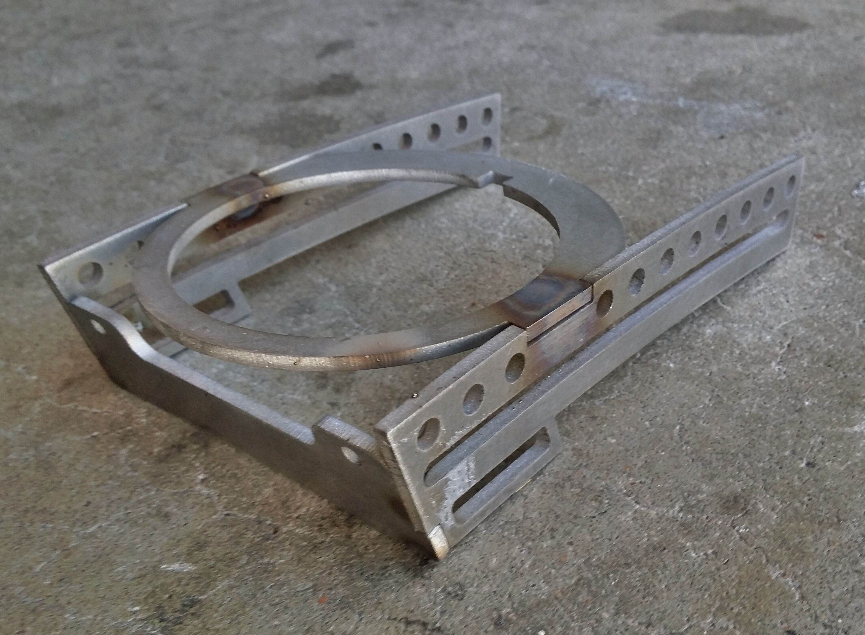

I put my exhaust hangers together tonight!

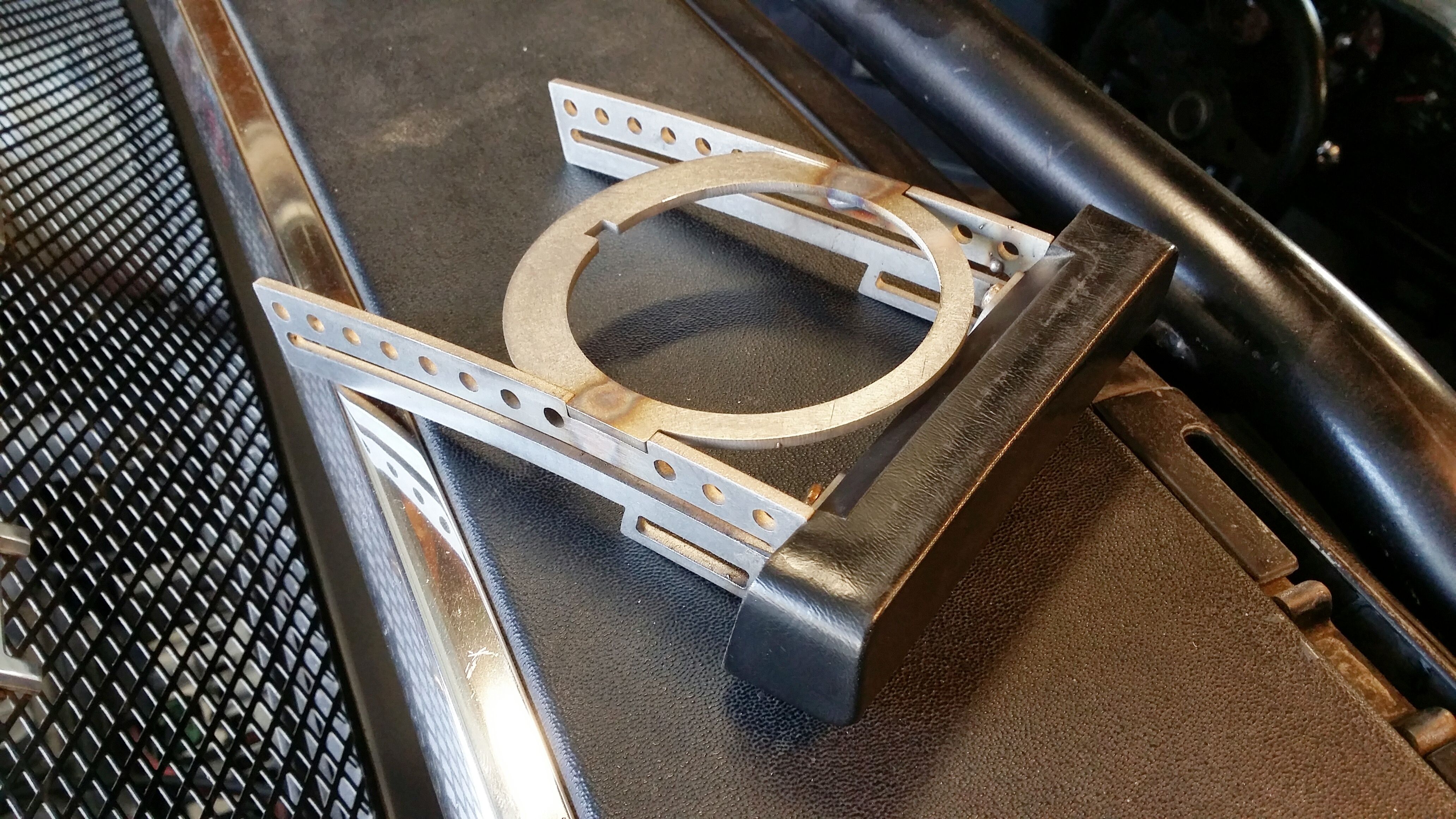

I also started back on one of my other back burner projects ... (IMG:style_emoticons/default/biggrin.gif)

Not quite ready yet, but it's close!

Muffler brackets look cool but they also look like they will bend at the mounting tab.

QUOTE(Mike Bellis @ Apr 6 2015, 09:55 PM) *
Ash tray is way cool.
Good point on the brackets. I'll add in a gusset on the bottom to strengthen them against bending.
A&P Mech
post Apr 7 2015, 06:12 AM
Post #316
Posts: 401
Joined: 10-September 13
From: United States
Member No.: 16,371
Wow Ross! The cup holder looks awesome! I want one. Put me on the list. (IMG:style_emoticons/default/aktion035.gif)

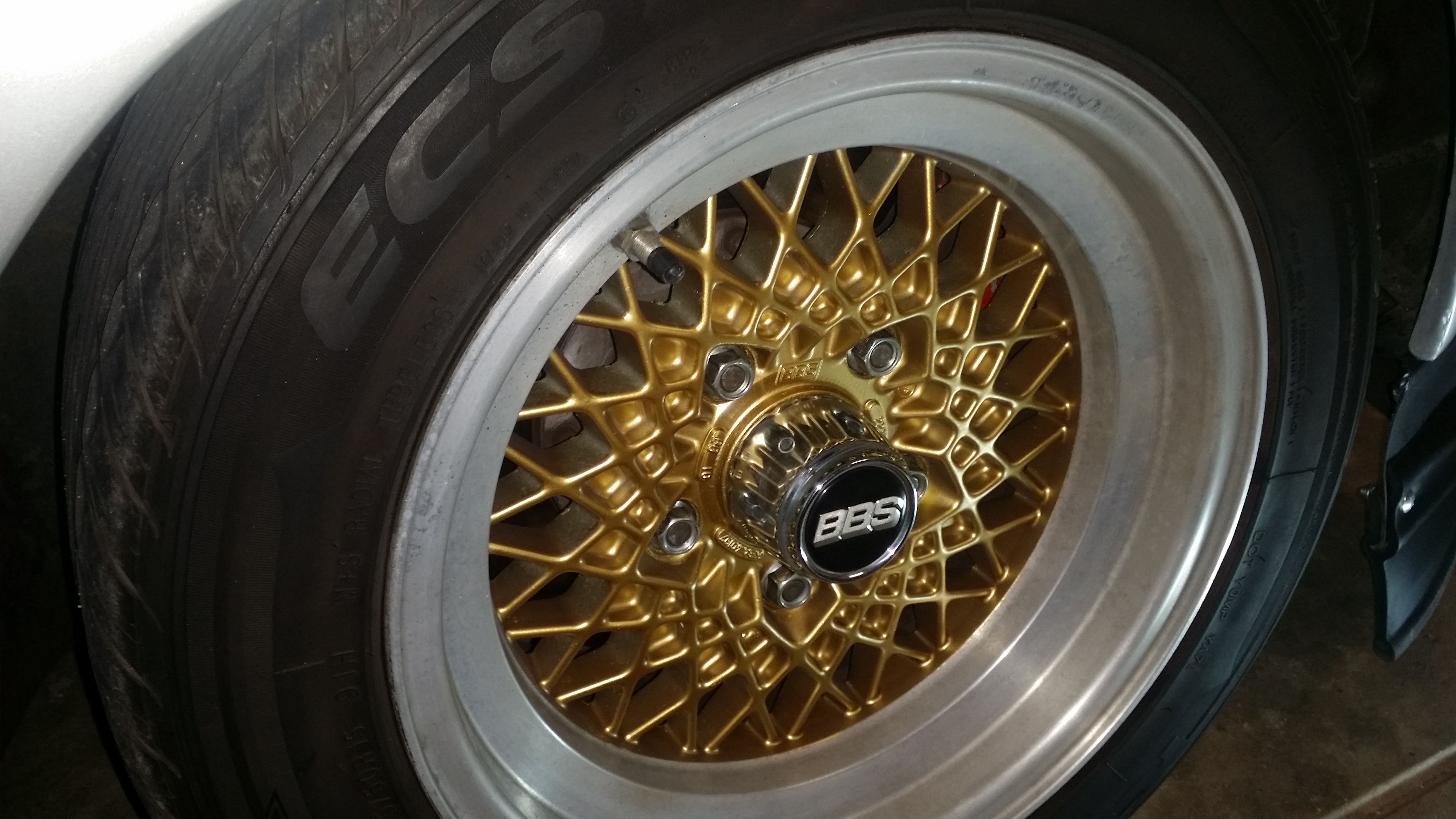

I did a few small things this weekend, but my favorite change was plasti-dipping my wheels gold! I also think I have sourced a neutral safety switch that is closed in neutral instead of open which should make the lockout relay easier to install!

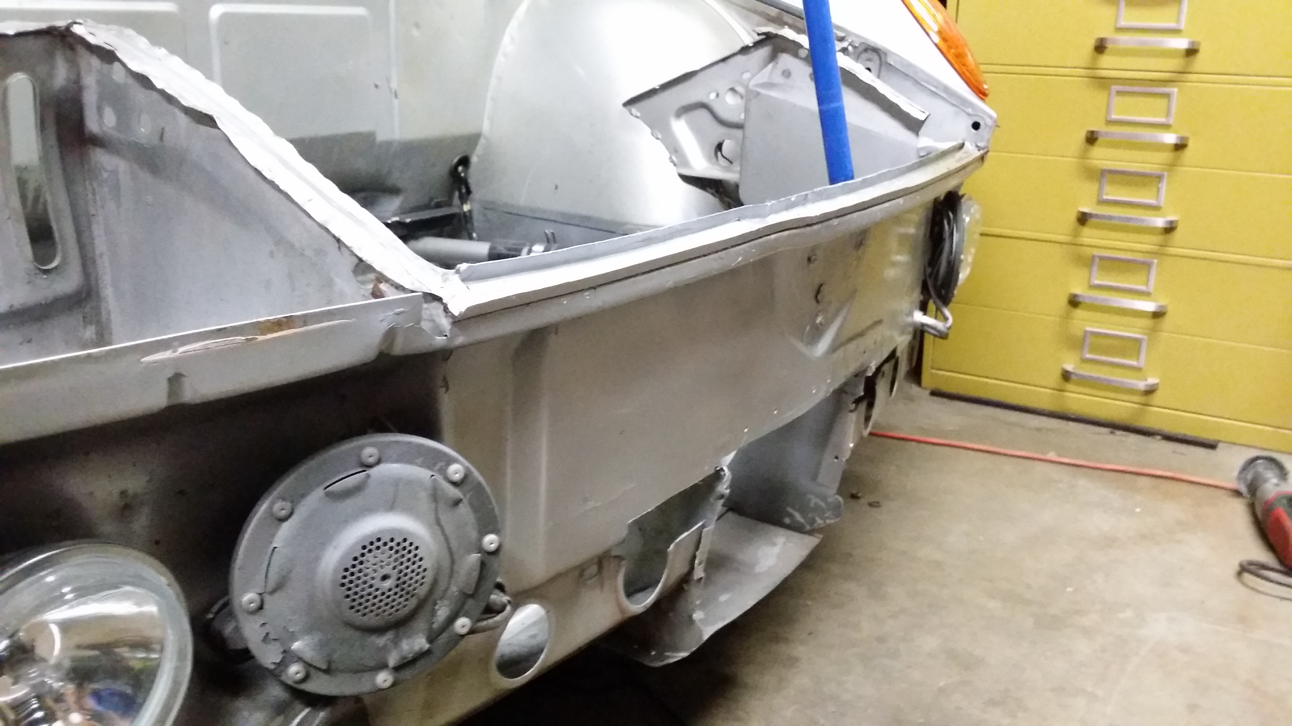

That's a good look! Did you get your small amount of body work completed on Apollo?

I did! Just about good as new!

Looks great! I always wanted to see what your radiator opening looked like. Do you have a shot of it straight on?
