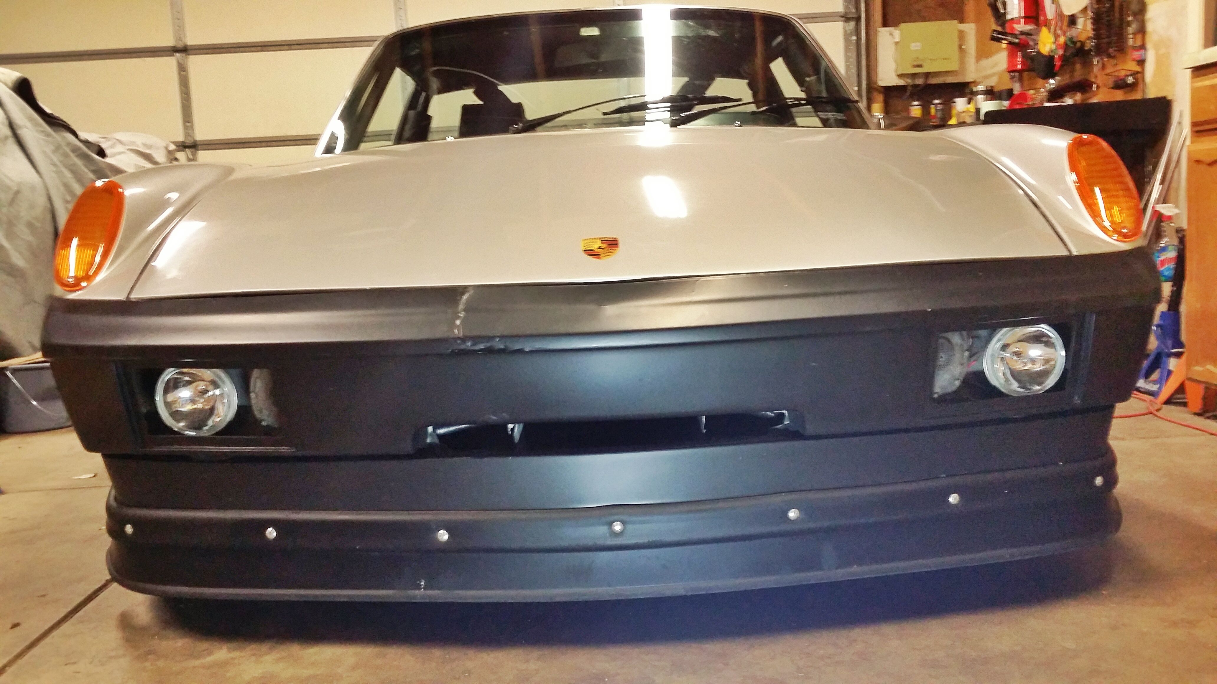

Looks great! I always wanted to see what your radiator opening looked like. Do you have a shot of it straight on?
I haven't settled on the final cut yet, but this works fine for in town and highway. Steep passes and track days I have to be careful on my temps, but I'm hoping to solve that by moving from a junkyard volvo radiator to a thicker dual pass aluminum unit.

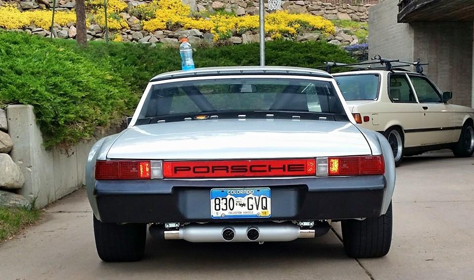

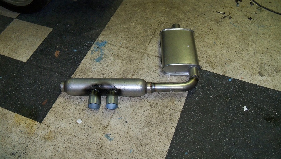

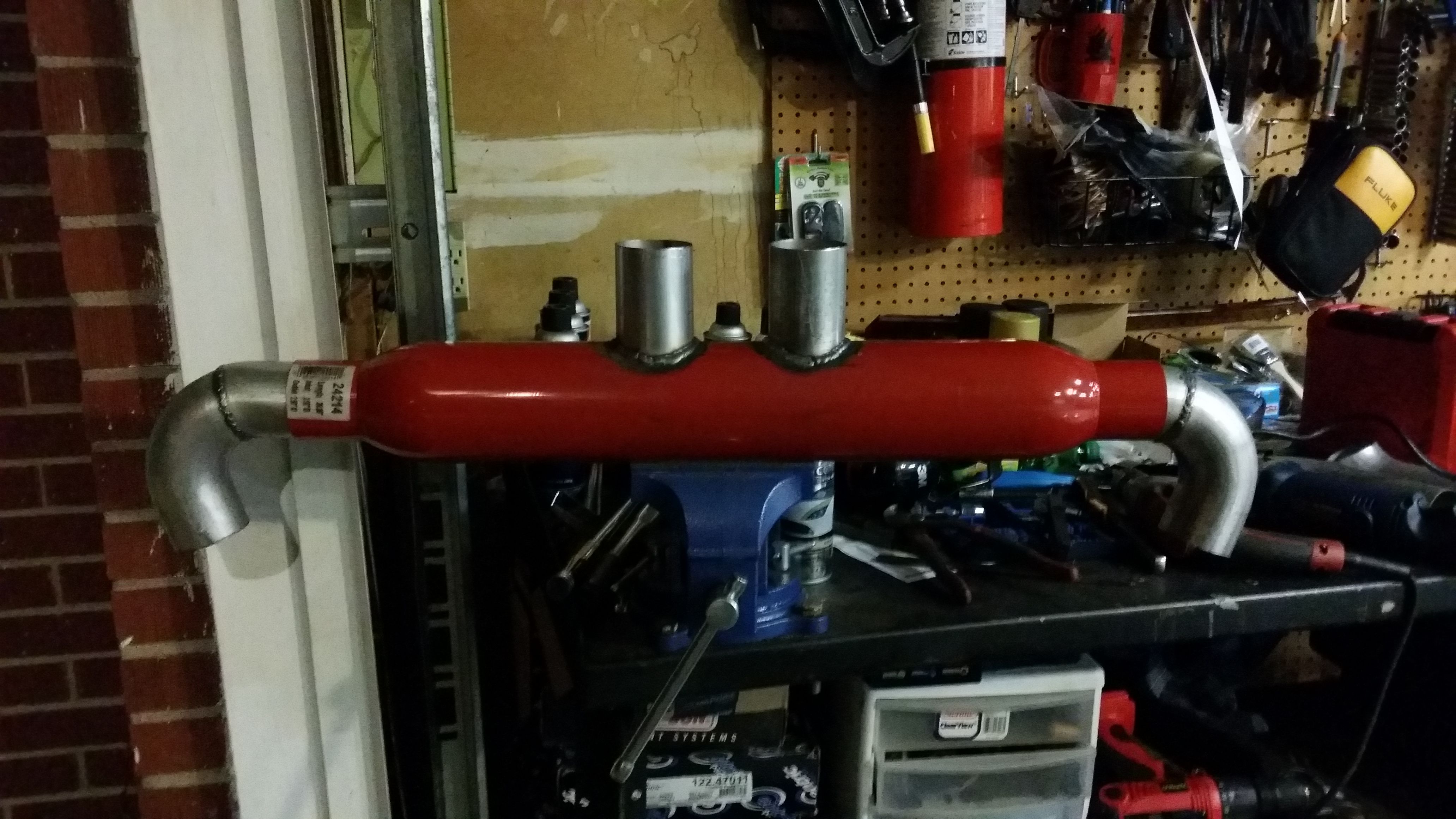

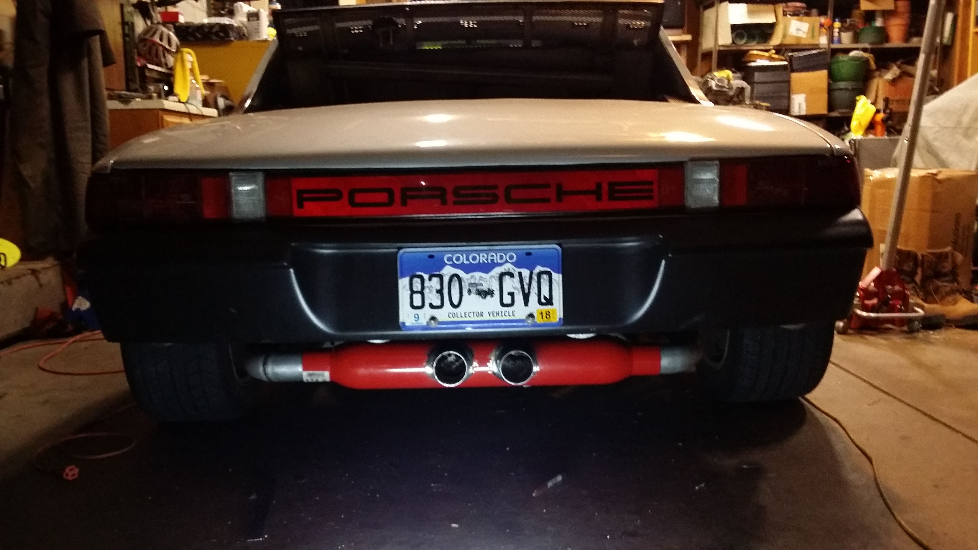

I was getting tired of how loud my exhaust was so I added in another muffler/crossover tonight. Much better!
Marty at MSDS was kind enough to supply the mandrel bends (super easy to work with, and inexpensive too!) And the center muffler is just a cherry bomb muffler from the FLAPS. I HAVEN'T SEALED it all up yet, but so far it looks promising!
Please post a video of how that sounds, I have been playing with the idea of building an exhaust like that for a few moths!

You may want to consider adding flanges to your add-on silencer set up. It's going to be fairly restrictive just by design alone and if you make it a convertible design you can change it out for your A/X activities. I wish I had access to flow meters for a truly accurate reading of the flow but if you increase the pipe diameter up it should minimize your backpressure, also adding a deeper tone. We need SOUND on this! (IMG:style_emoticons/default/popcorn[1].gif)

Great job on the center muffler. It will help a lot. Looks similar to Bob's setup which made the exhaust note really nice.
Here is his (from his blog):
Nice welds BTW :beer2. Not easy to weld in a circle.

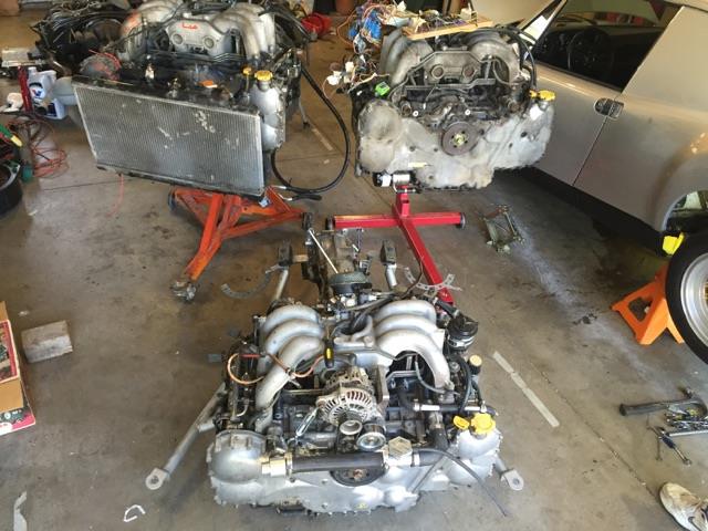

I painted the exhaust a less gaudy color, picked up a few spare EZ30's (trying to decide if I should resell or do a turbo build... (IMG:style_emoticons/default/idea.gif)), and put on some carefree miles.

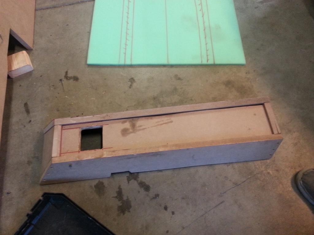

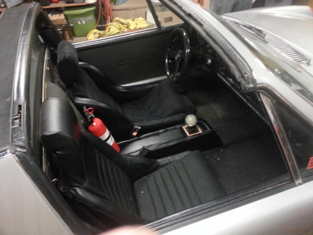

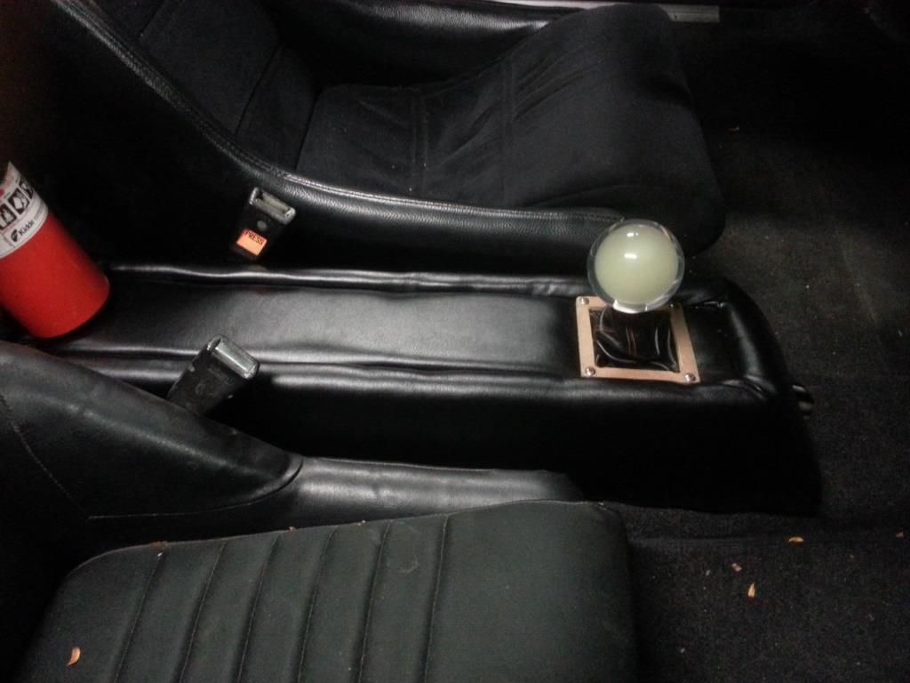

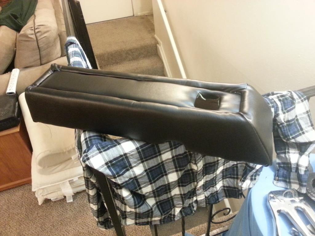

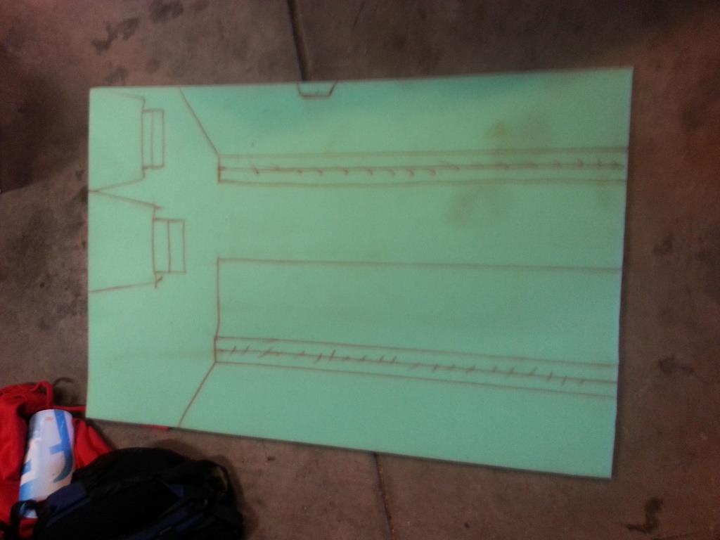

Just recently I decided to try my hand at making a center console and came up with the following. Built fron MDF, covered in 1/2" foam scrim and upholstered with vinyl. I'm hoping that a few heat cycles will allow the vinyl to stretch out and even out some of the sharper wrinkles. We'll see, but it is nice to have something to keep the dirt out of the shifter mechanicals!

Member No.: 17,743
That's the shortest shifter I've ever seen. Is that an AX thing, or just a preference for a really short throw? Nice console, btw.
Its the stock MR2 shifter length, and is incredibly short, but the tightness of the Subaru transmission \ cable shift makes it viable. I usually use a 3" lever extender to make the throw longer, but it is fun shifting with a 1" throw once in a while.

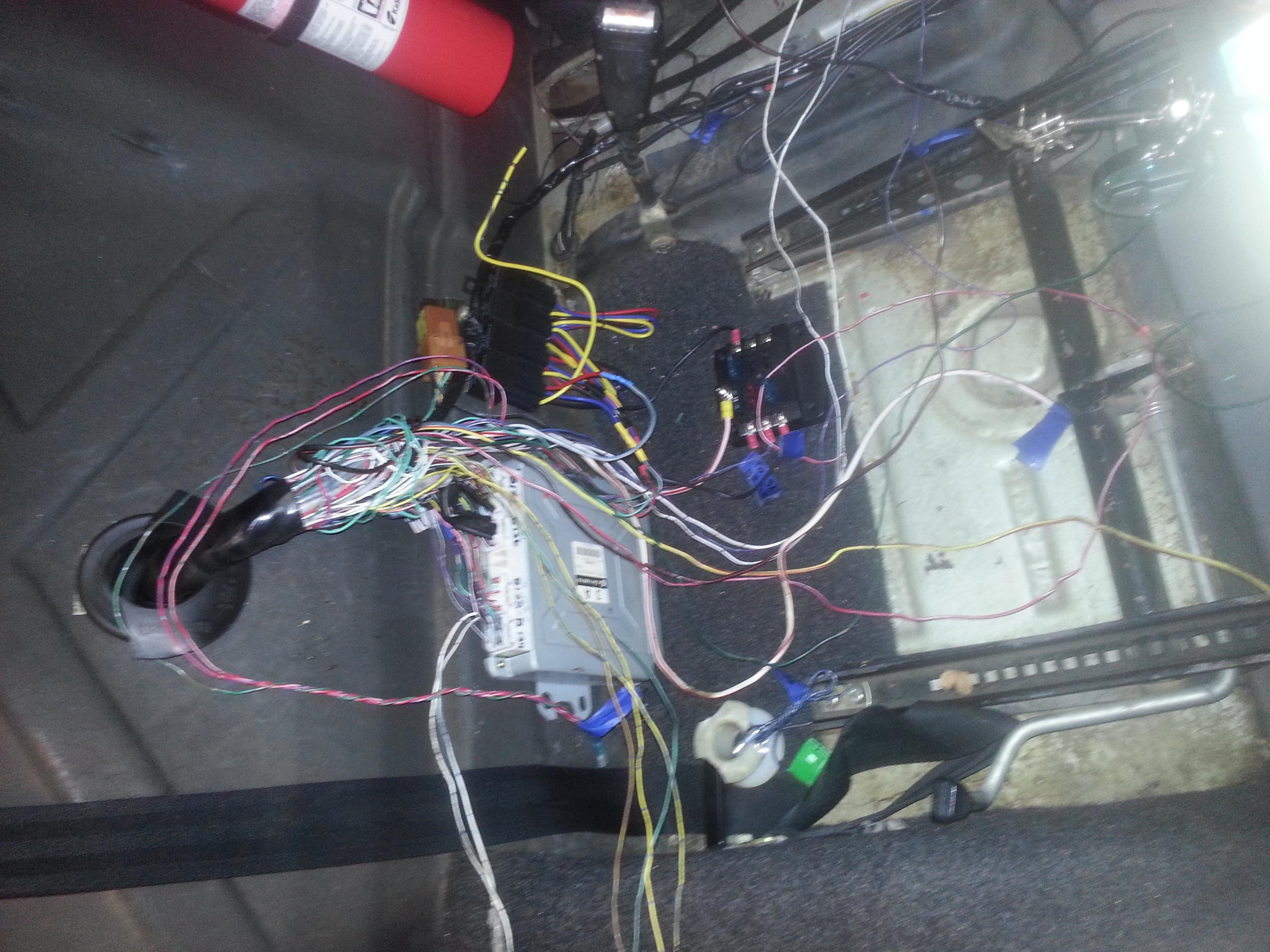

Ive been driving the car quite a bit since my last update. My plan with the car has always been to maximize driving time and minimize time on jackstands. With that in mind i did a lot of things "good enough" during the initial build. Now that its been two years without serious mishap im going to start refining things a bit.
Below is a list of pet peeves on my project im going to work out!
Cooling system barely adequate
Cable clutch gives poor pedal feel
No heat
Intake extends into the rear trunk
No flip up headlights
No trunk supports

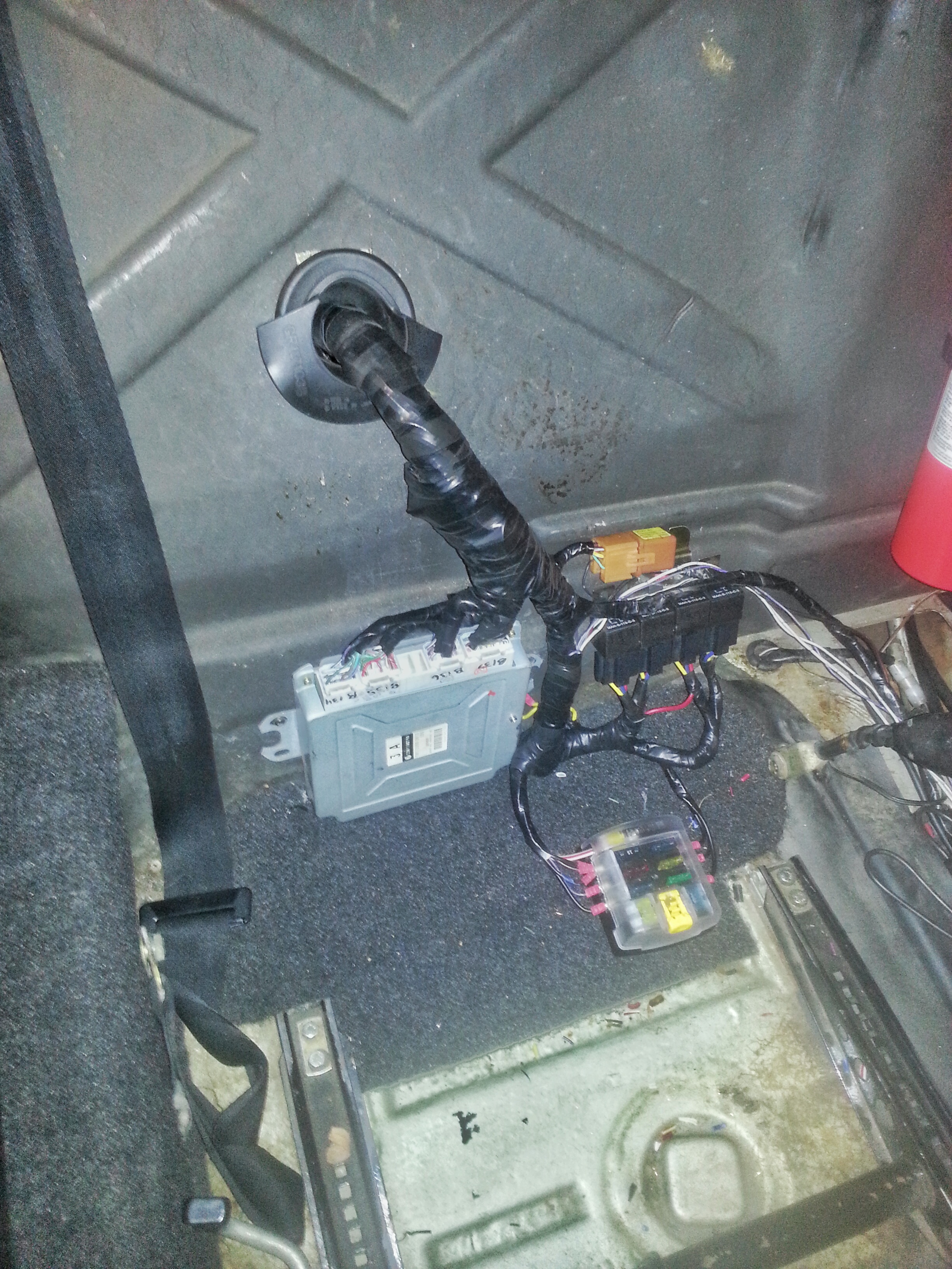

Sloppy ecu wiring (temporary wiring)

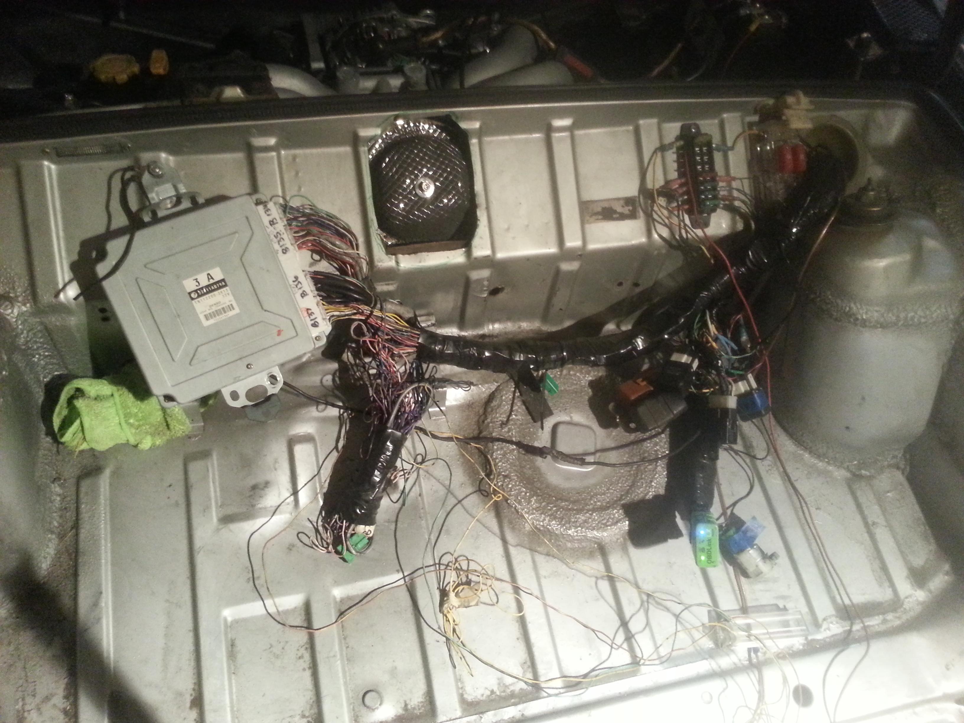

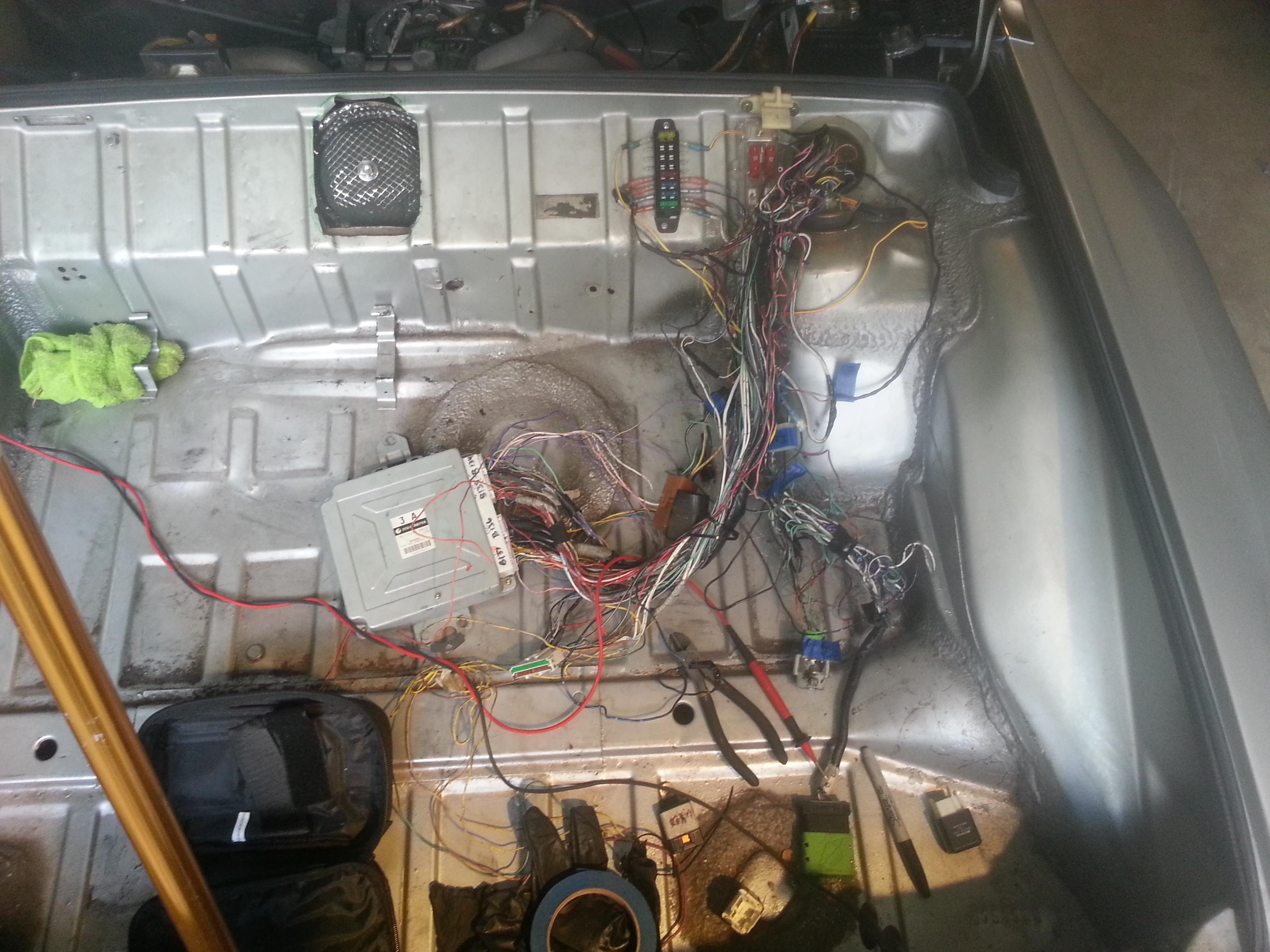

I started earlier this week rerouting and reorganizing the wiring harness to get it out of the trunk. It's till not quite done, but I dont want to finish it until i figure out where to hard mount the obdII port!

All finished up!
