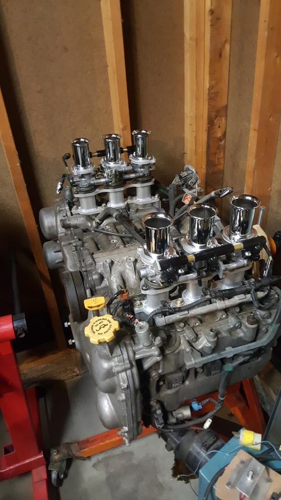

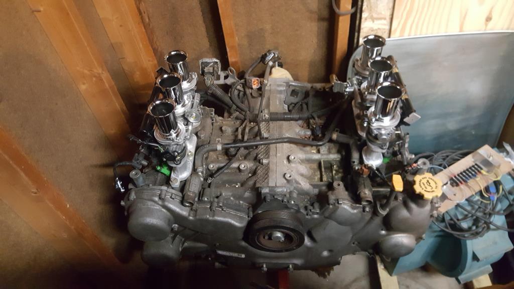

QUOTE(3d914 @ Dec 19 2016, 08:07 PM) *
Ross, that motor looks gorgeous with throttle-bodies. Any idea how it will sound with them?
No idea on how they will sound yet, but I sure hope it will be suitably raw!
I'm also planning on switching to a lightweight flywheel to help even more with throttle response. My understanding (I believe it was from DBcooper) is that our small cars really don't need all the flywheel mass required by a much heavier Subaru!
QUOTE(Chris H. @ Dec 21 2016, 07:51 AM) *
I'm starting to REALLY like those. What version of MS do you run them with?
I'm planning on building up an MS3 system, but that is by far going to be the most trouble I'm sure (Particularly running the variable cams).
Eventually I would like to run dual injectors as well (one set of injectors in the head, one set in the throttle bodies), and modulate the duty cyle on each to maximize response at low engine speeds (injectors in head, closer to valves) and maximize power at high engine speeds (injectors in throttle bodies, better fuel mixture before entering cylinder)
I'm buying the system this week, so hopefully I can sink my teeth into learning it as the new year comes!
-Ross

Another advantage for the short six engines from Subaru the Speed Triple TBs line up better with the intake ports. Looks like they where thinking of doing that al along. on the EG33 your intakes are of an unequal length. Or you have to separate the TBs build new linkage pieces and new fuel rails.
One nice thing with the Speed Triples is each one has a vacuum port so, you can dump them to a manifold, stick a Mig nozzle in the tube going to the MAP and you will have a nice steady signal.
Love the look (IMG:style_emoticons/default/aktion035.gif)
Are you planning on using a motorcycle cable splitter or linkage for the throttle cable connections?
rnellums
post Dec 21 2016, 11:11 PM
Post #375
Professional Enthusiast
Posts: 1,673
Joined: 26-November 09
From: Littleton, CO
Member No.: 11,072
QUOTE(914forme @ Dec 21 2016, 01:52 PM) *
I did actually space the throttle bodies (~20mm) and modified the linkage between them so the manifolds are perfectly vertical!
The throttle bodies I have actually have two-way pulleys, so it should be pretty straight forward to have the throttle cable run to one, and have it pull the other pulley!

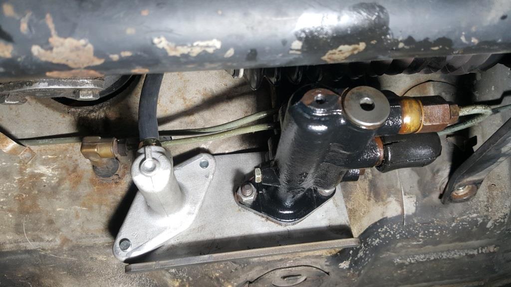

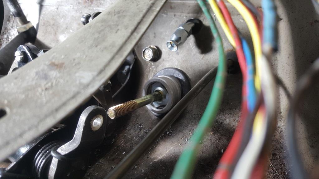

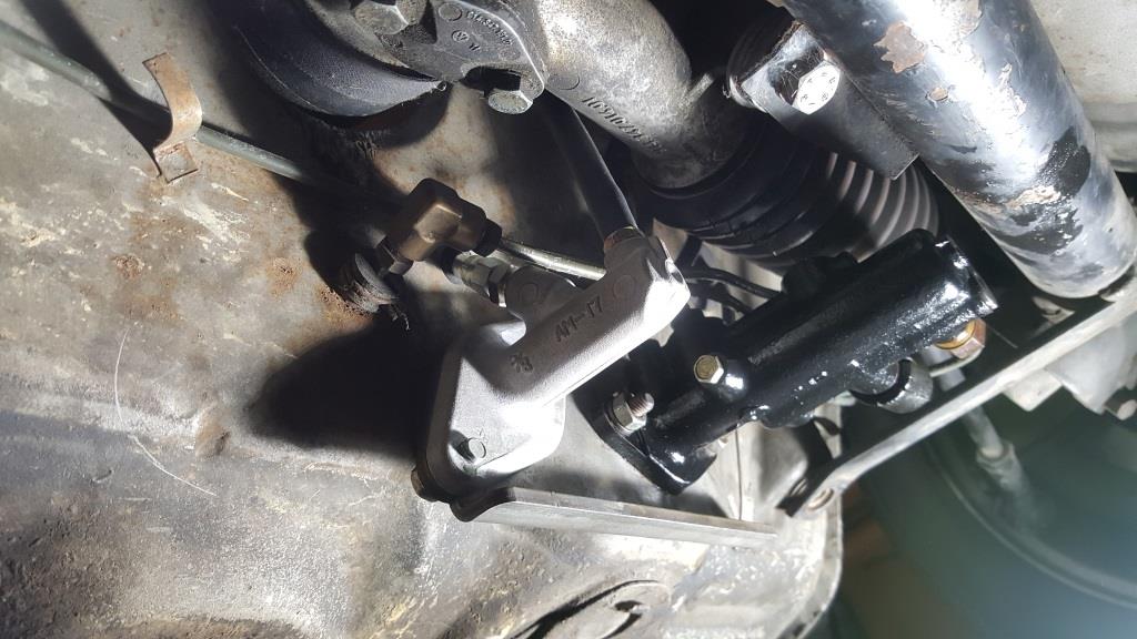

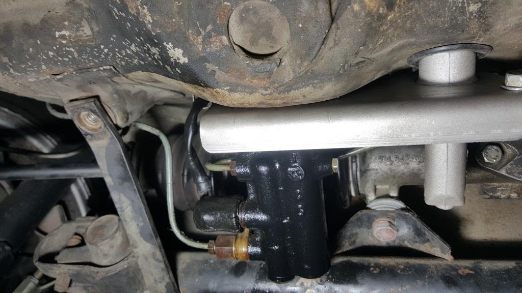

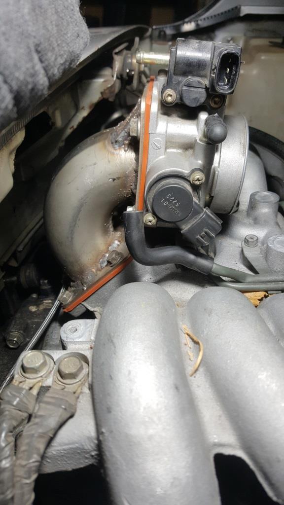

Well, I put the EZ36 on the back burner for a bit while I made some upgrades to my existing setup. First off was adding in a hydraulic clutch (instead of my cable bell crank method). TO do this I designed a 304 Stainless master bracket that bolts onto the brake pedal supports (credit to Chris and Kent for that idea) I added a flange on the bottom edge to get enough stiffness to eliminate flex without a supplemental bracket.
The remote reservoir is mounted right next to the brake reservoir up top and has a separate fluid feed line.
I drilled a 1.5" hole into the passenger compartment for the master and lined it with a grommet to seal on the master itself. I also had to add a small hole for the hydraulic line to pass through, but overall am really pleased with the result.

I had previously cut a small hole in the trunk firewall to allow clearance for small air filter. I have been trying to figure a way to clean it up since. This weekend I took a stab at making a manifold flip for the EZ30 using 1-R bend 2.5" tube. I wish I had used regular steel vs. Stainless because the welds came out so poorly. I may be making another one of these in the near future. Not sure if it will help or hurt performance, but I can run a proper air filter and can finally close my trunk back off.
