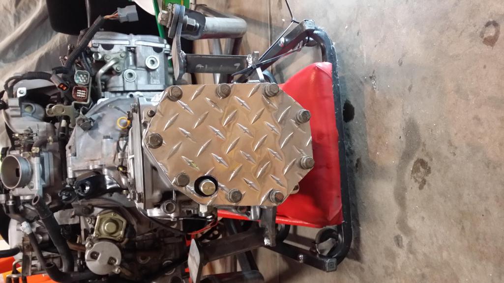

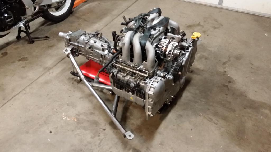

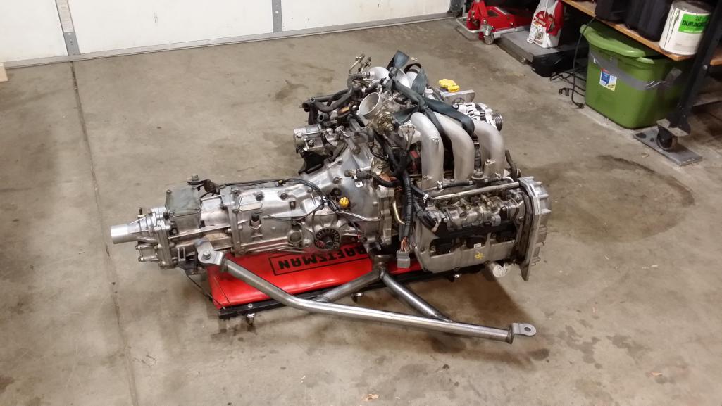

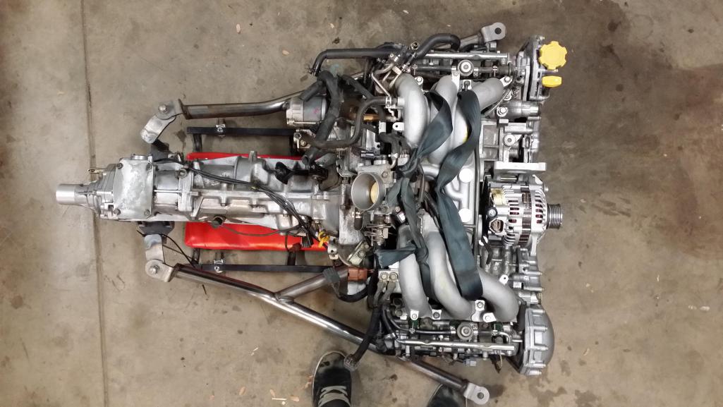

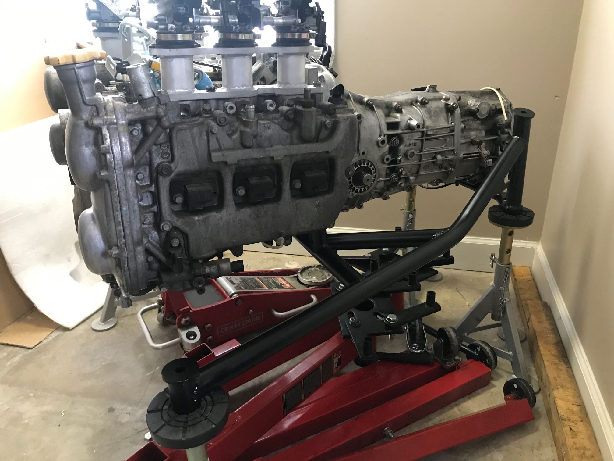

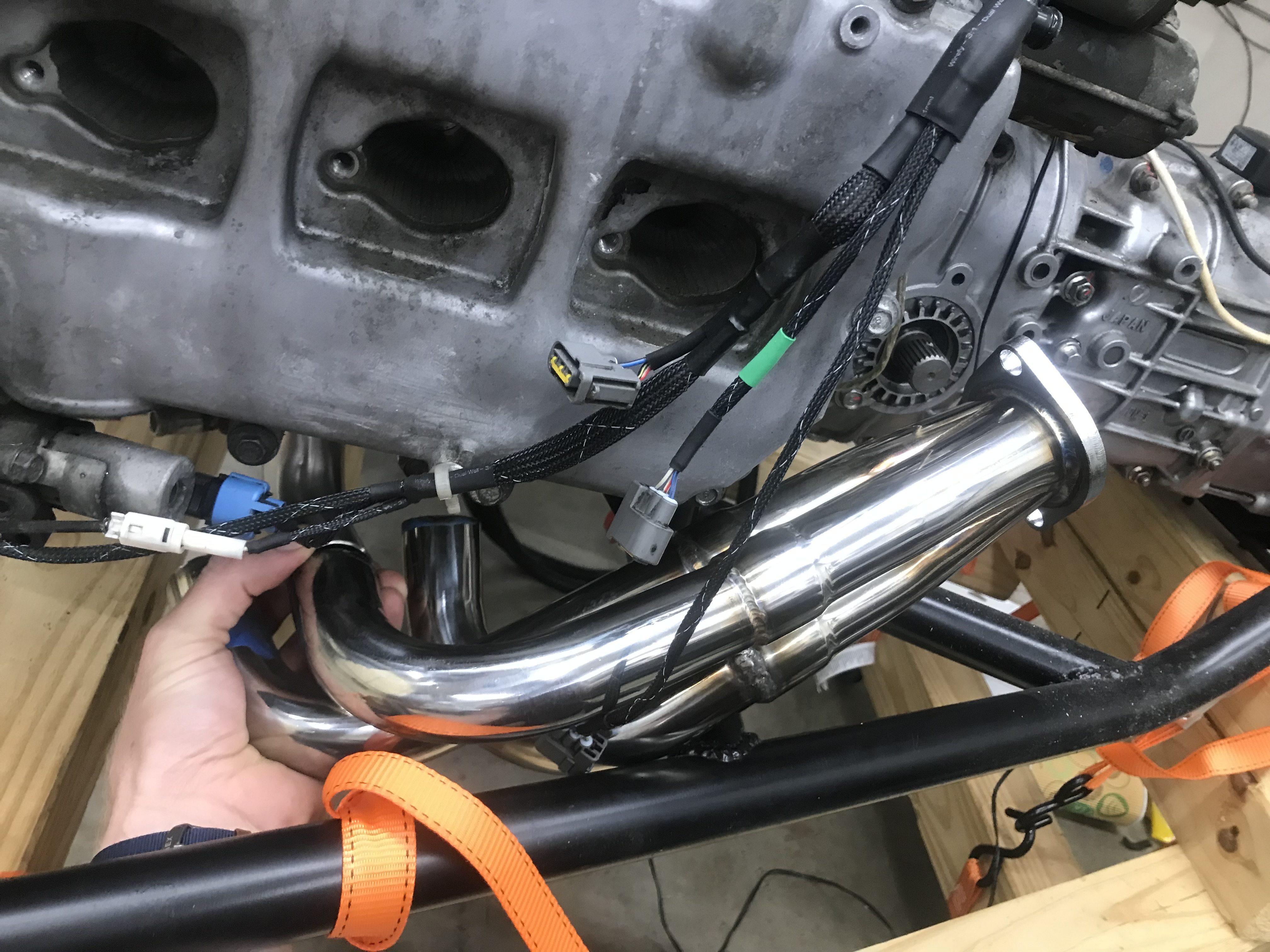

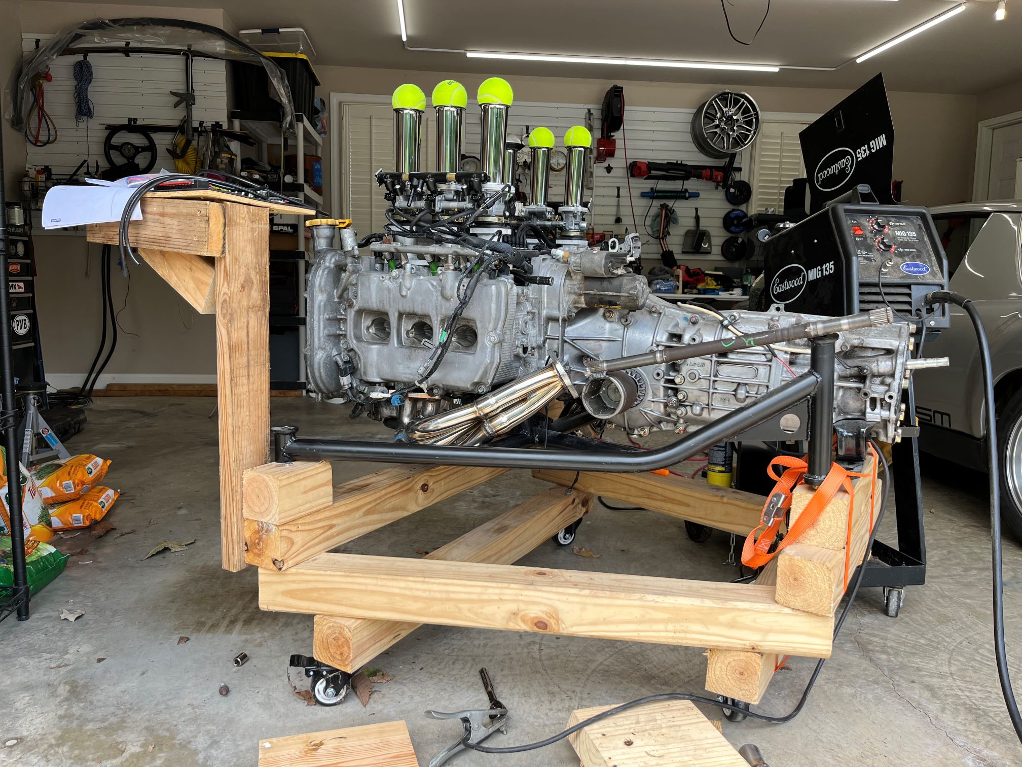

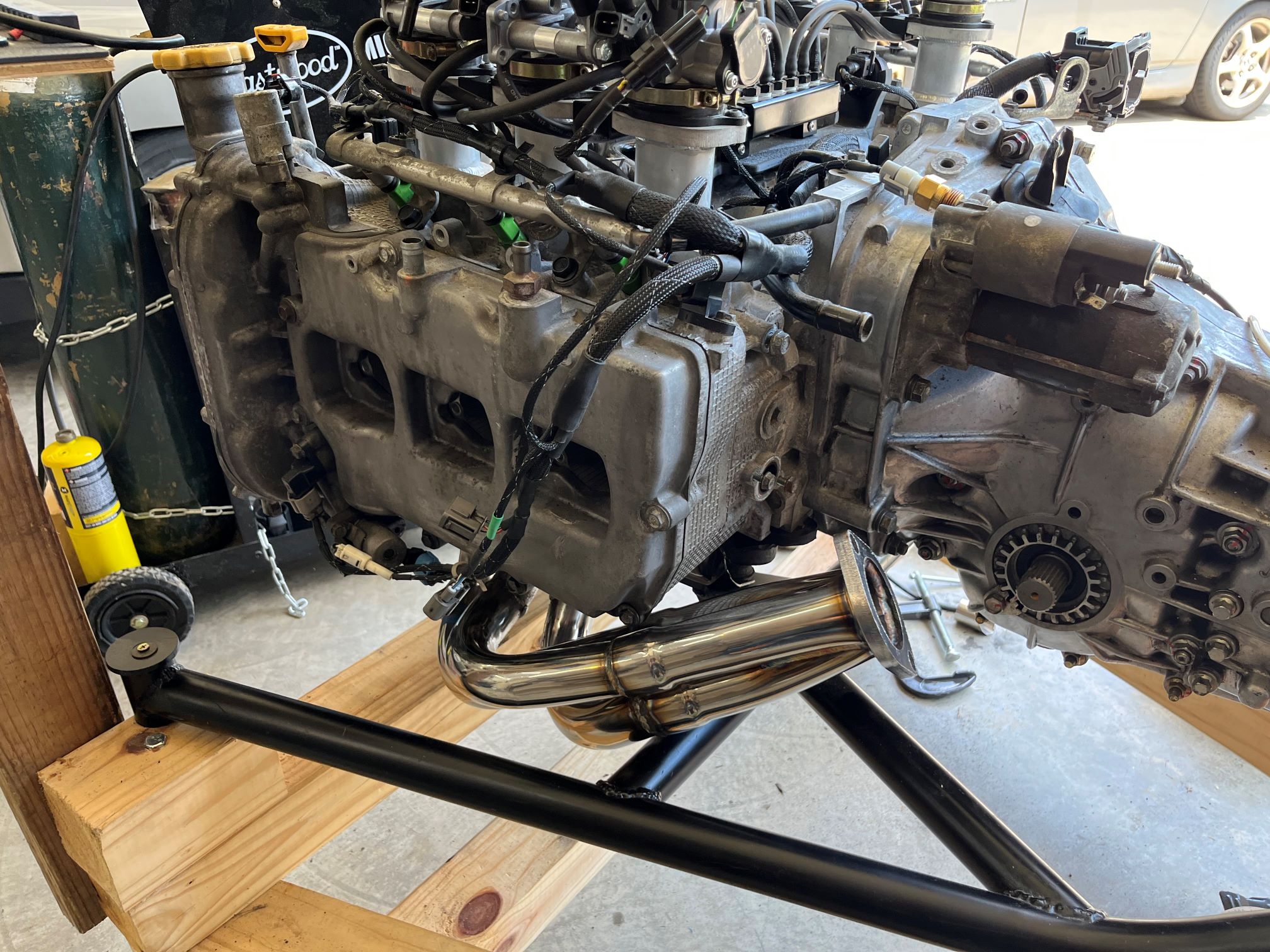

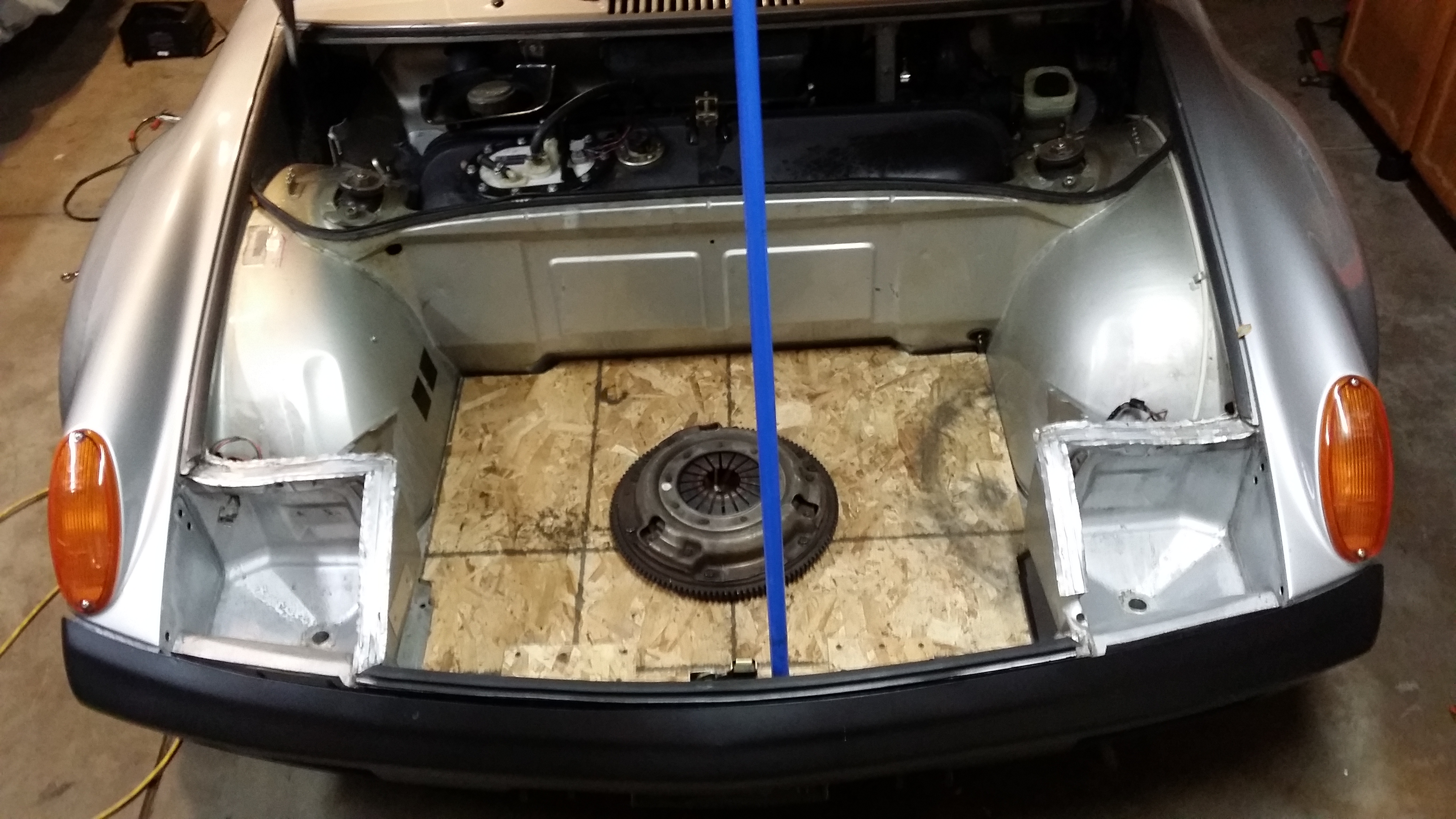

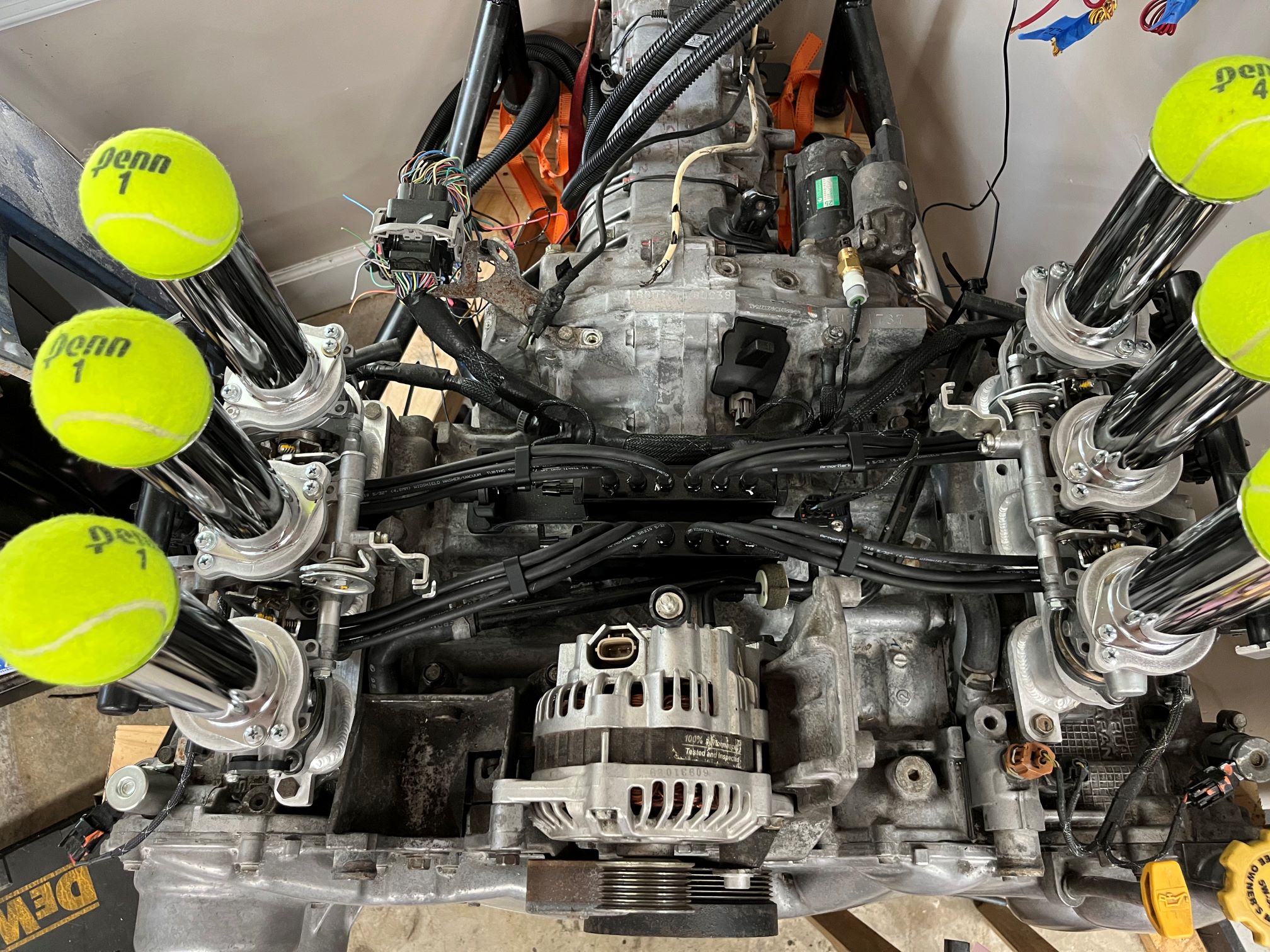

rnellums   Wow! It has been a while since I have updated...   Feb 19 2014, 04:40 PM
rnellums   It's coming together!   Feb 19 2014, 04:43 PM
Chris H.   Sweeeeet! Looks like a nice clean engine to s...   Feb 19 2014, 05:26 PM
rnellums   Sweeeeet! Looks like a nice clean engine to ...   Feb 19 2014, 06:01 PM
brant   fun.... I want a ride when its finished   Feb 19 2014, 06:12 PM
rnellums   fun.... I want a ride when its finished I...   Feb 19 2014, 06:20 PM

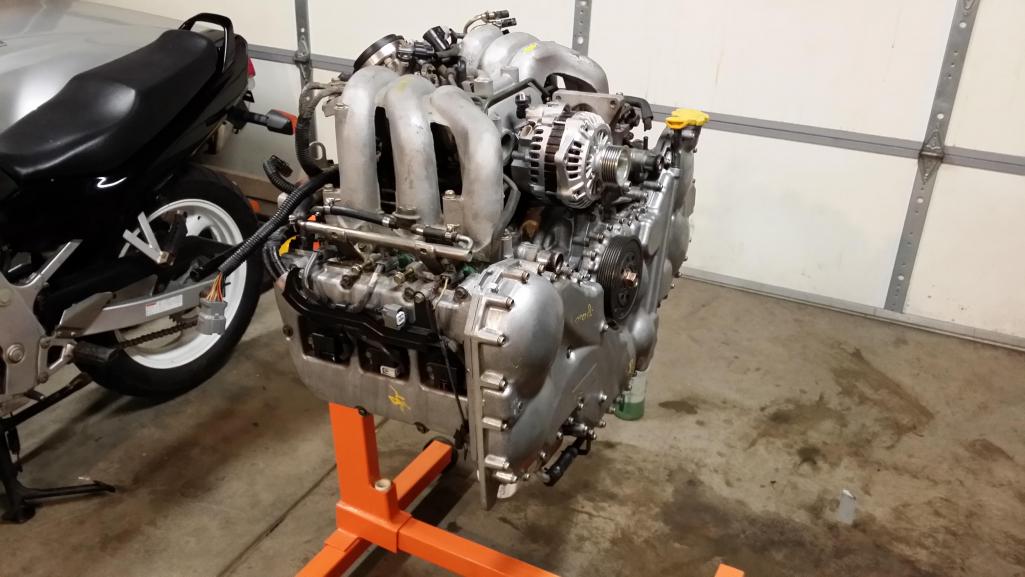

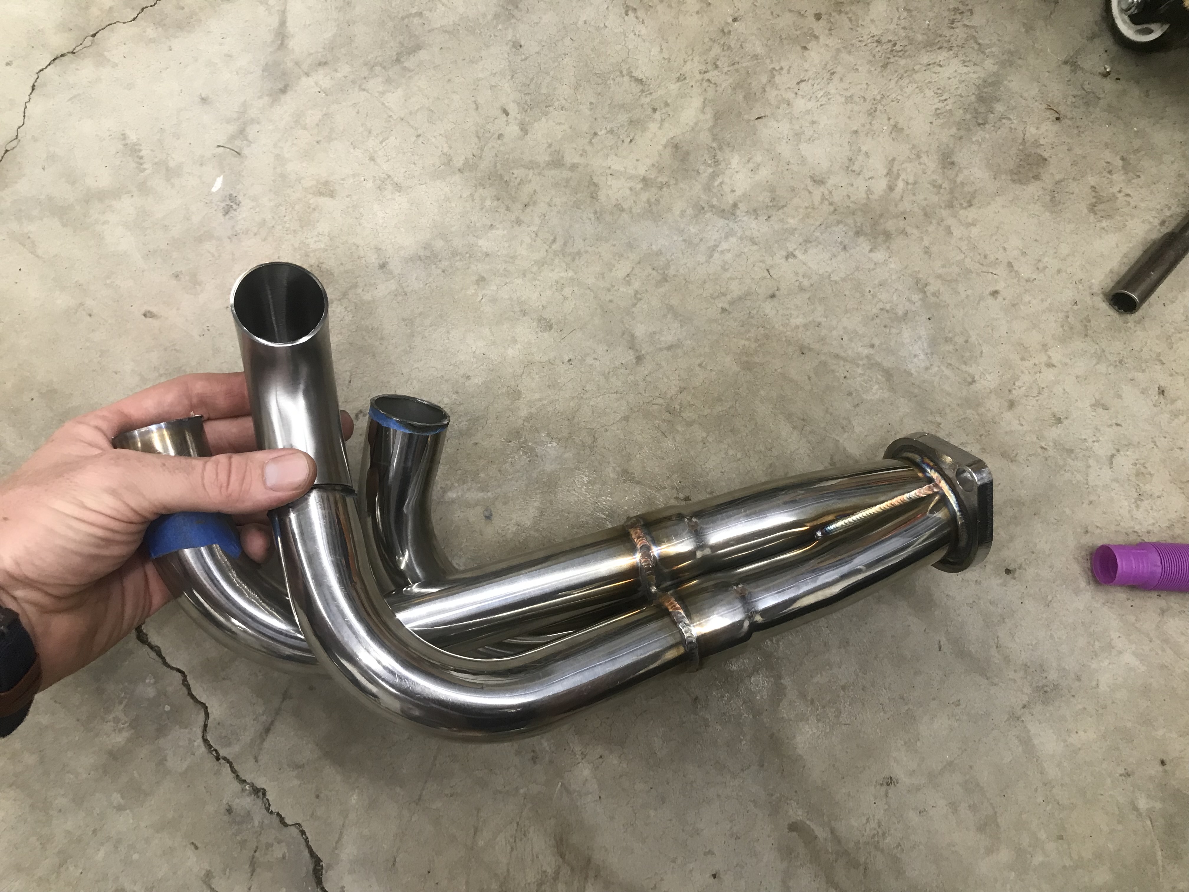

rnellums   I spent some time tonight working on the 2nd subar...   Feb 19 2014, 10:04 PM
1stworks   :Qarl: Sweet!!!!!!...   Feb 20 2014, 08:23 AM

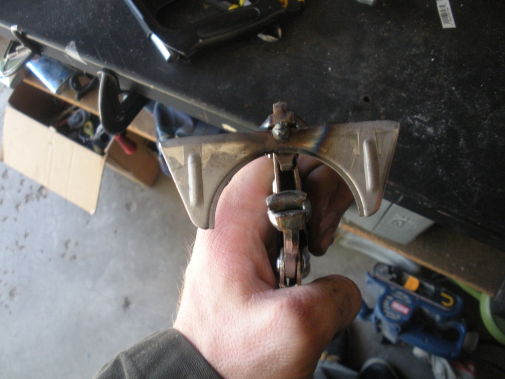

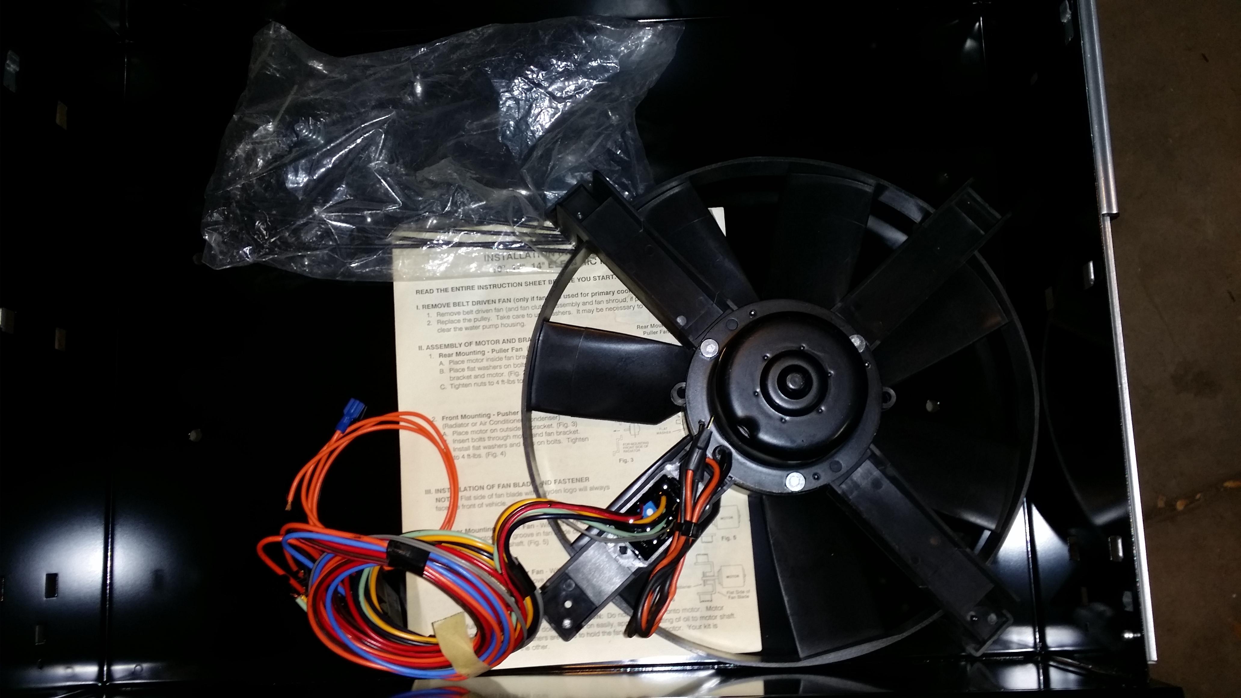

rnellums   Today my neighbor stopped by and dropped off an ol...   Feb 20 2014, 07:55 PM
76-914   Nice welds! Maybe you can flip that fan around...   Feb 21 2014, 06:40 PM
rnellums   Nice welds! Maybe you can flip that fan aroun...   Feb 22 2014, 12:05 AM

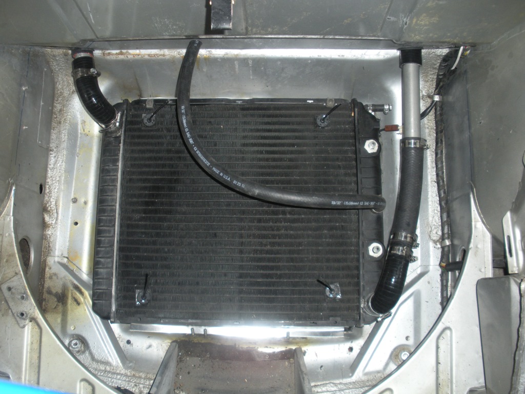

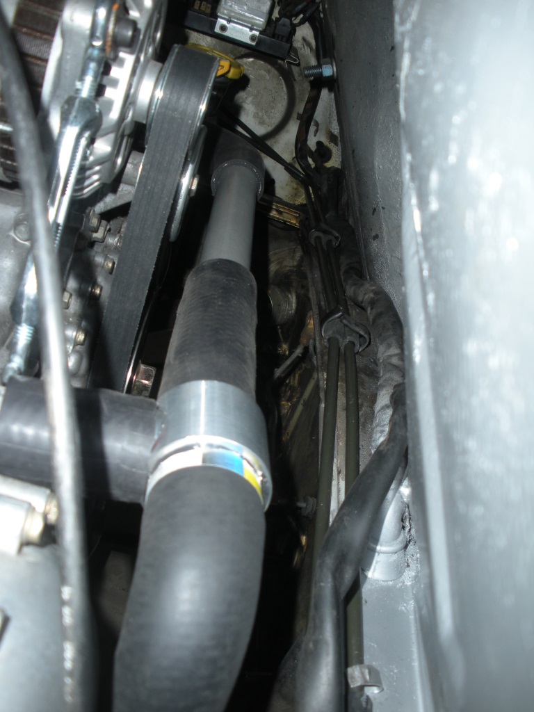

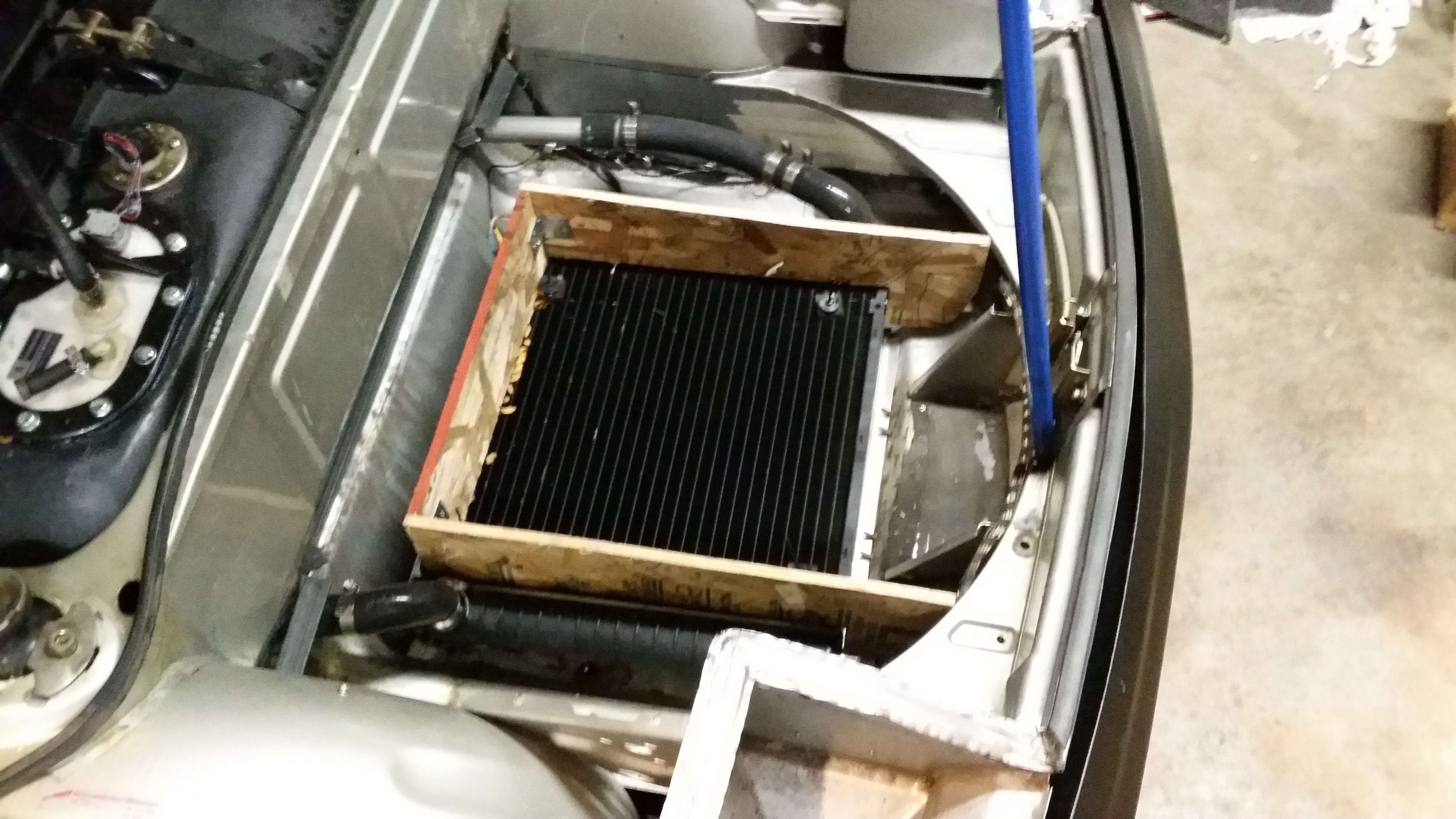

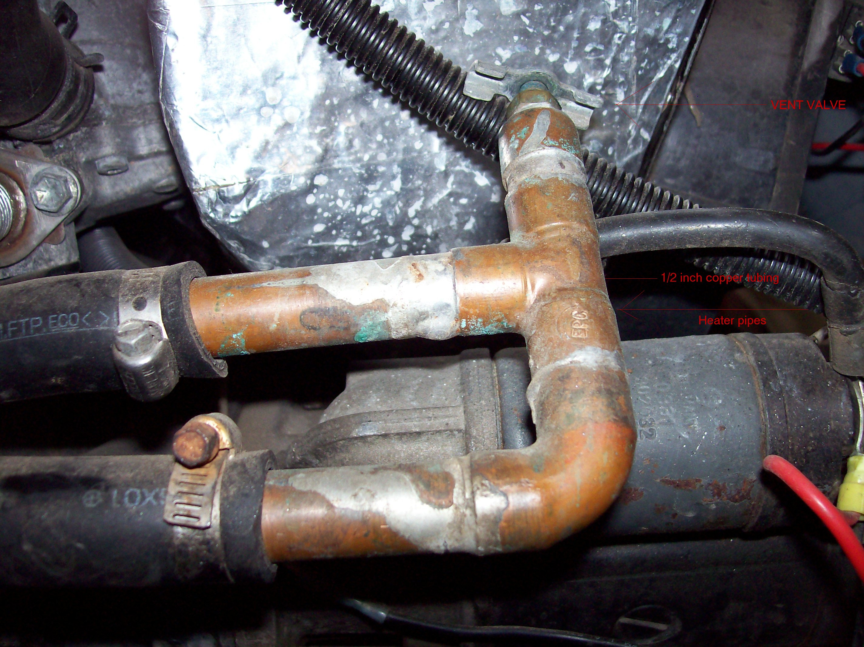

rnellums   I picked up a radiator from the Junkyard today for...   Feb 22 2014, 07:11 PM
914forme   Fans work better pulling air than pushing. I am a...   Feb 23 2014, 04:32 PM
rnellums   Fans work better pulling air than pushing. I am ...   Feb 23 2014, 04:49 PM

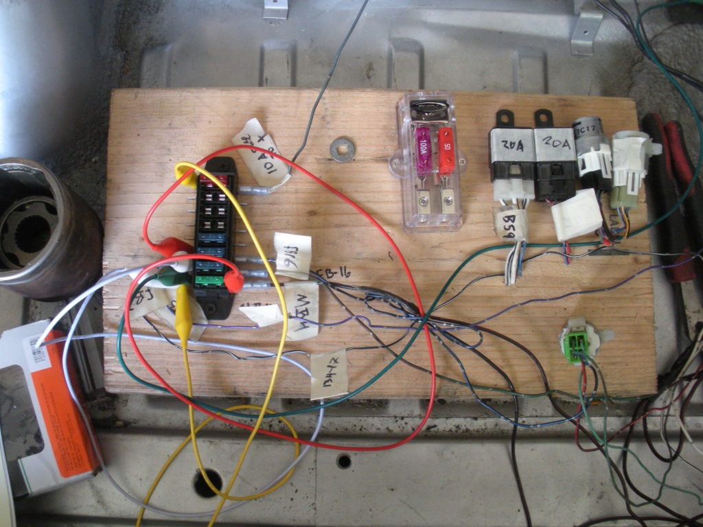

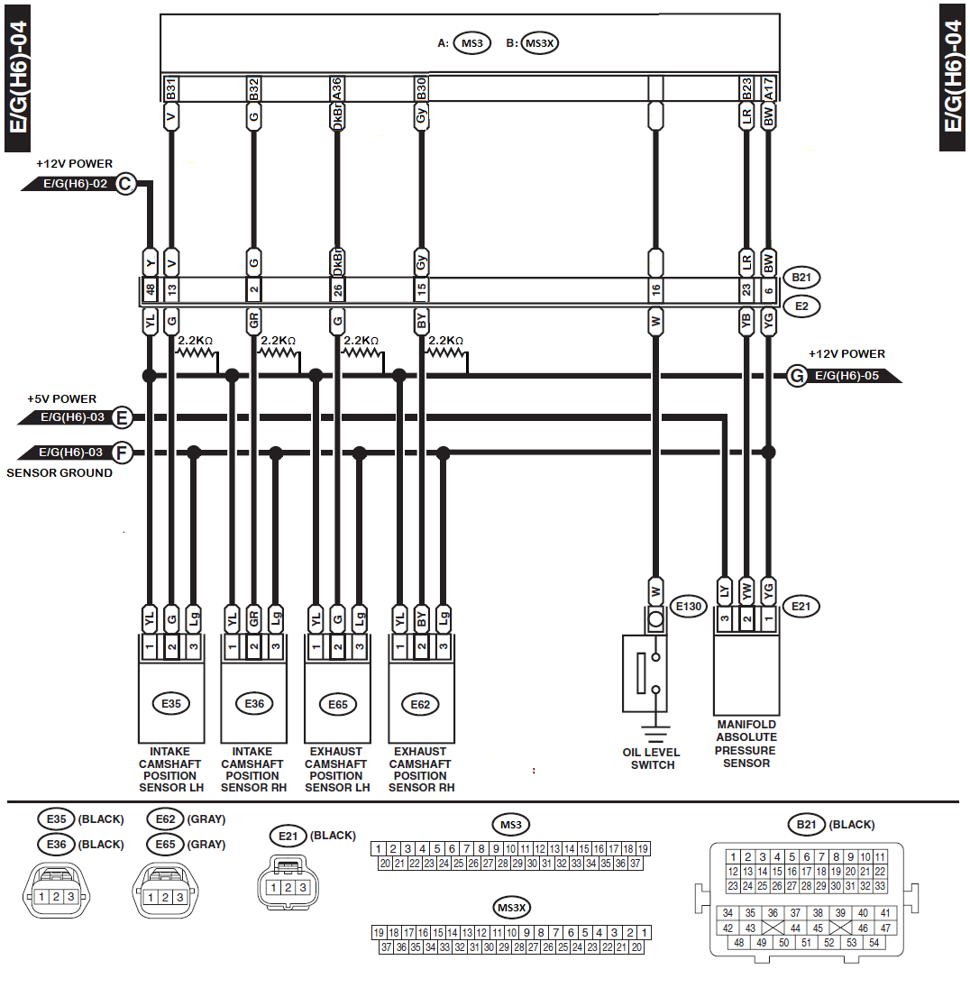

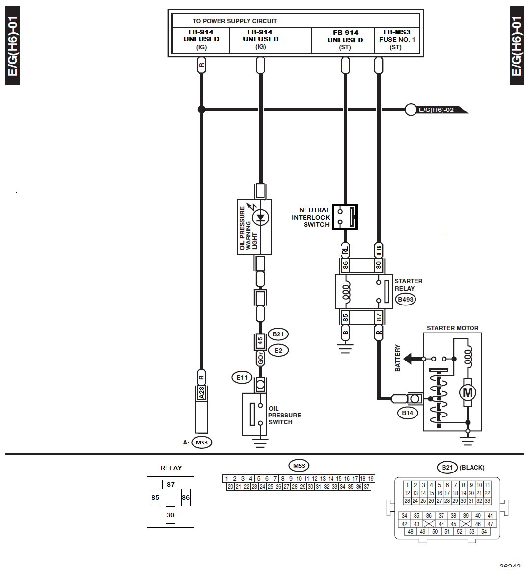

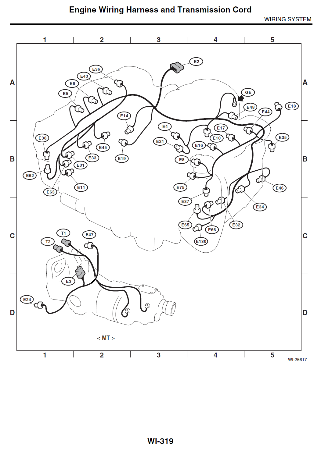

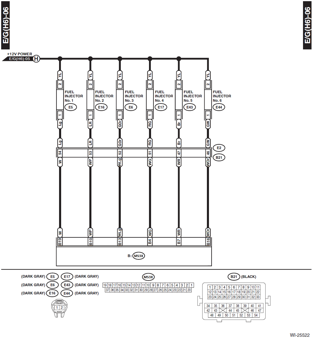

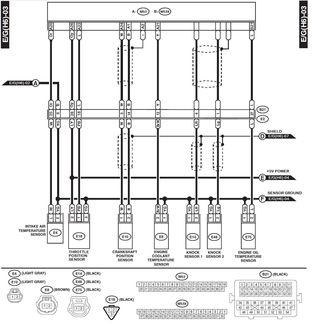

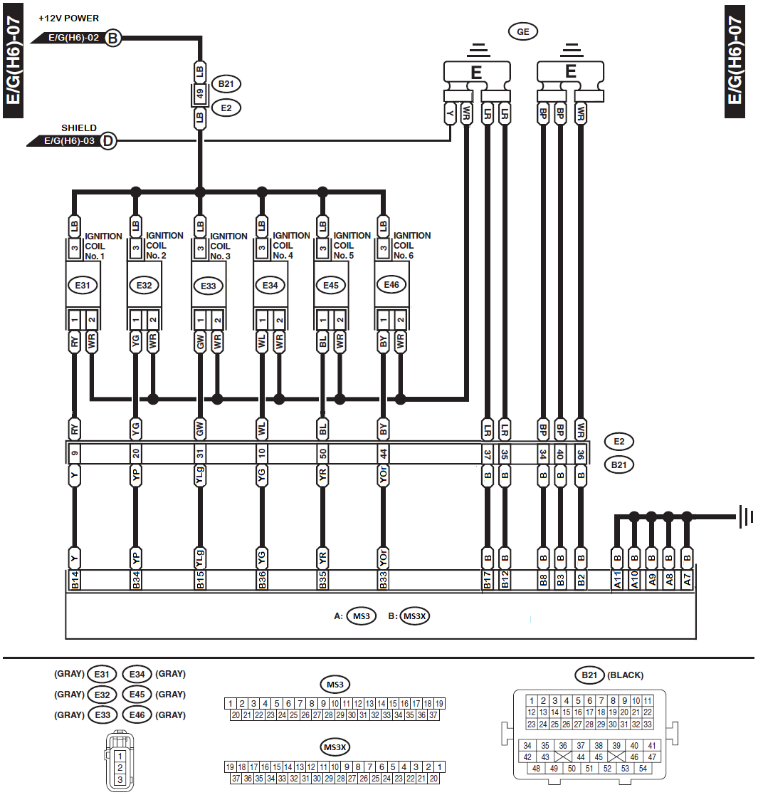

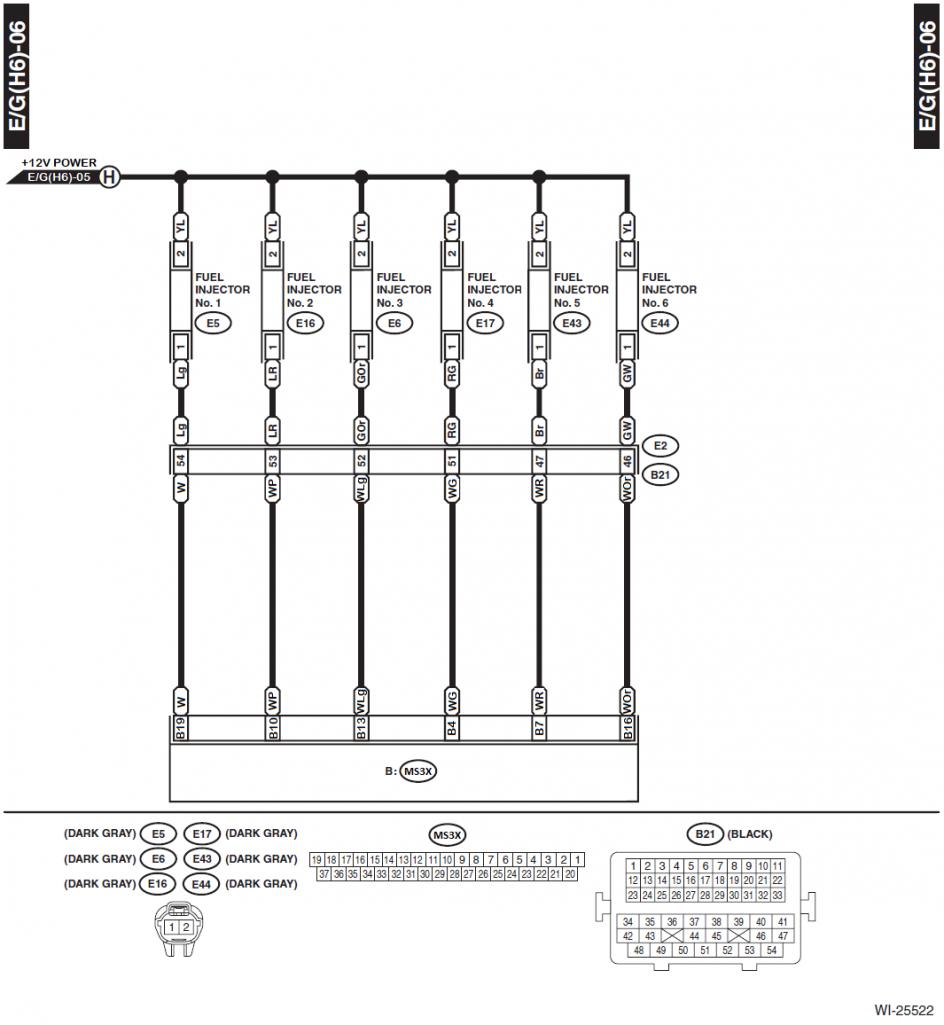

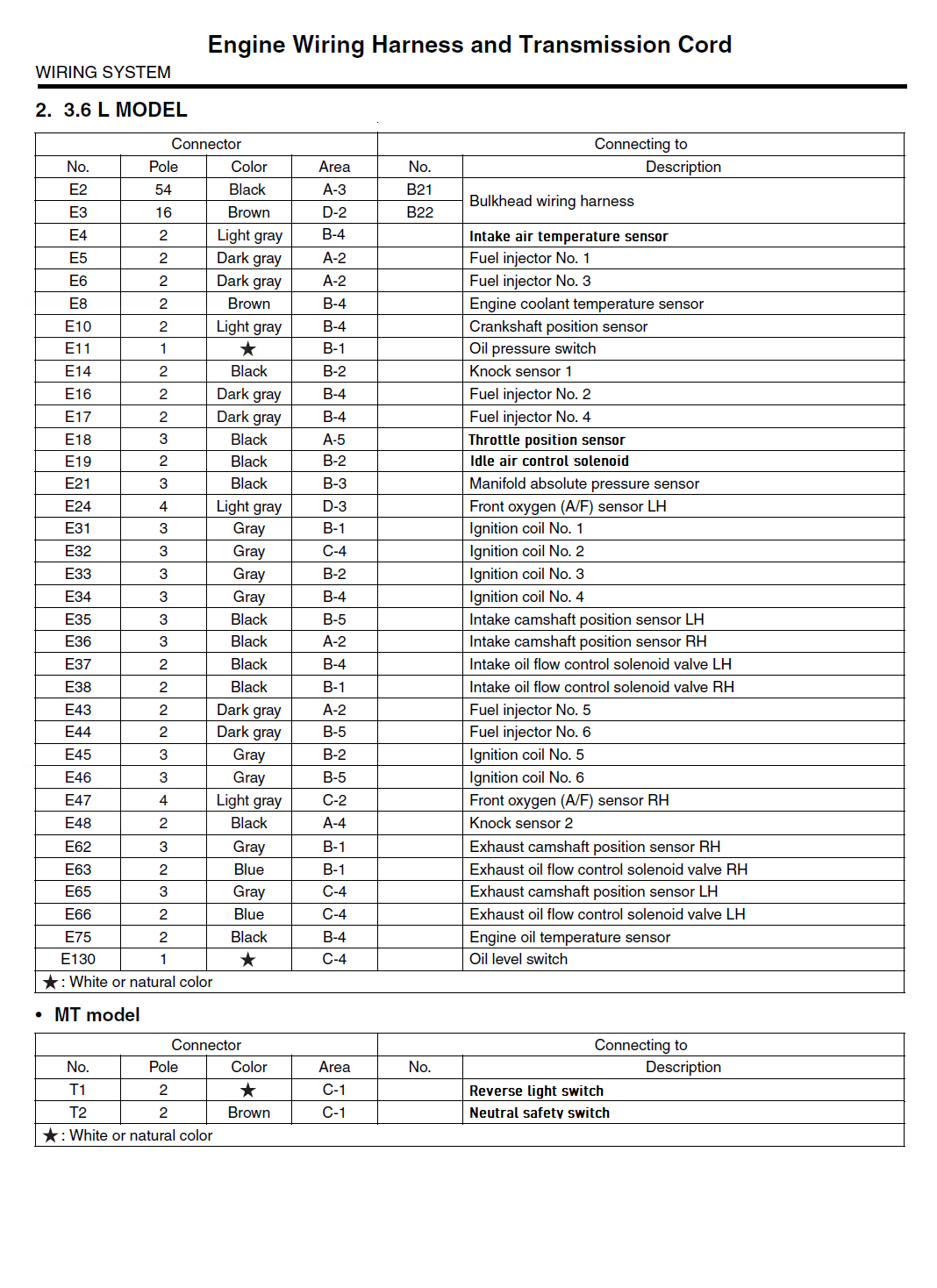

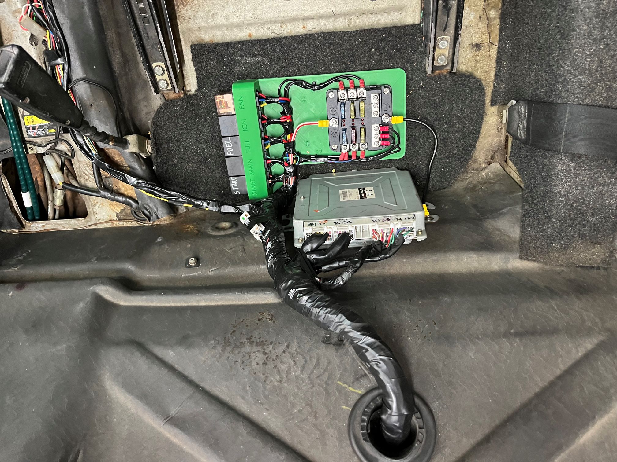

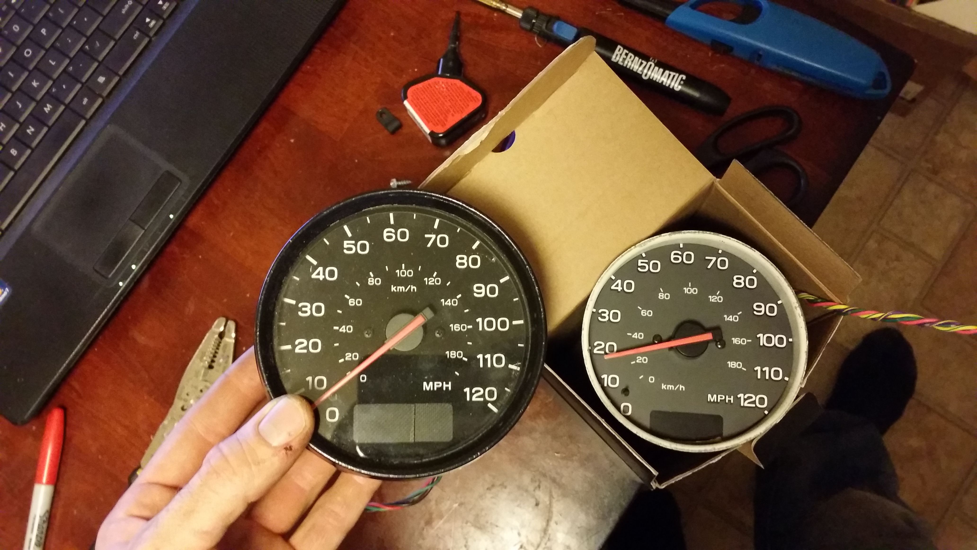

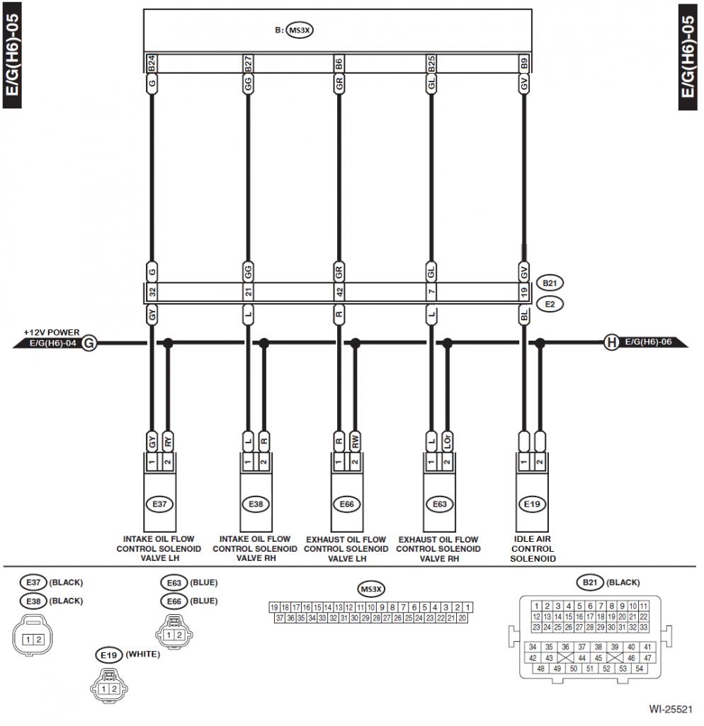

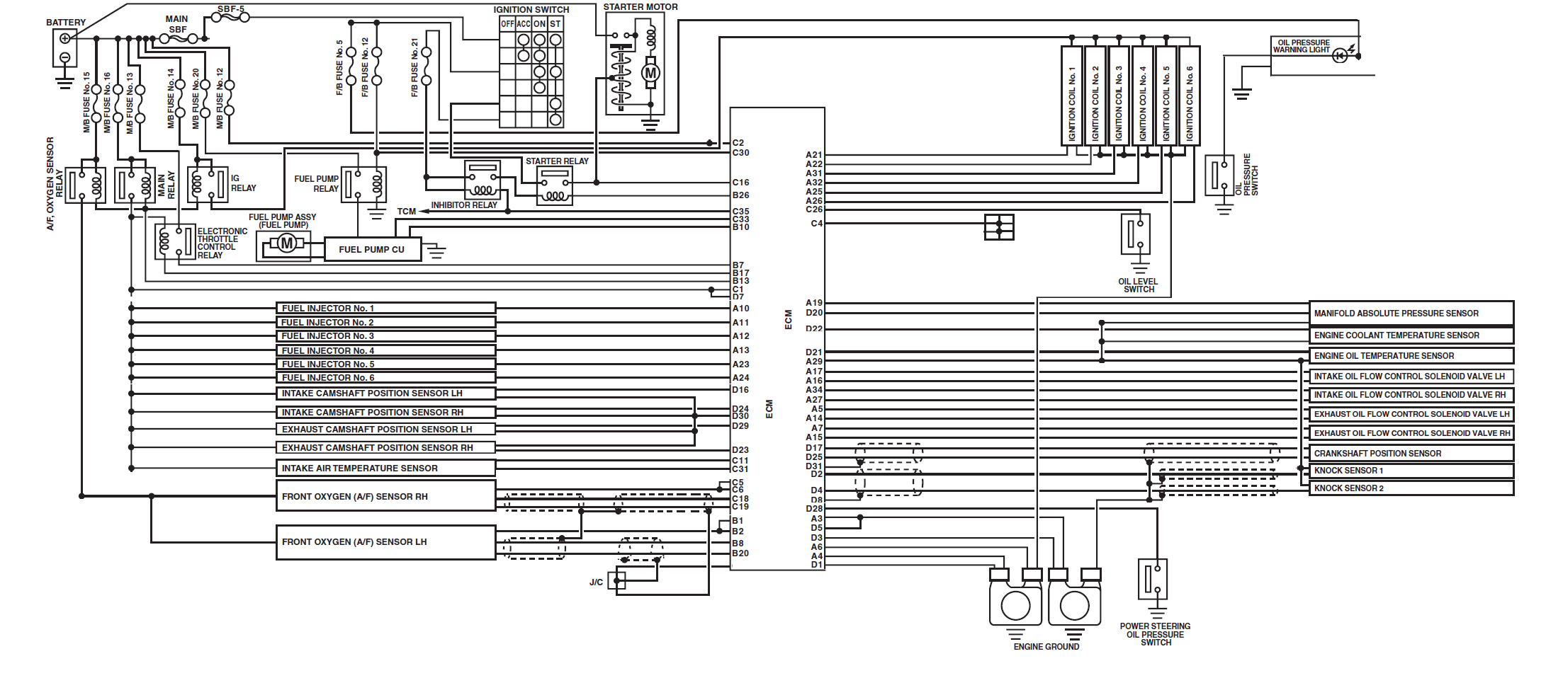

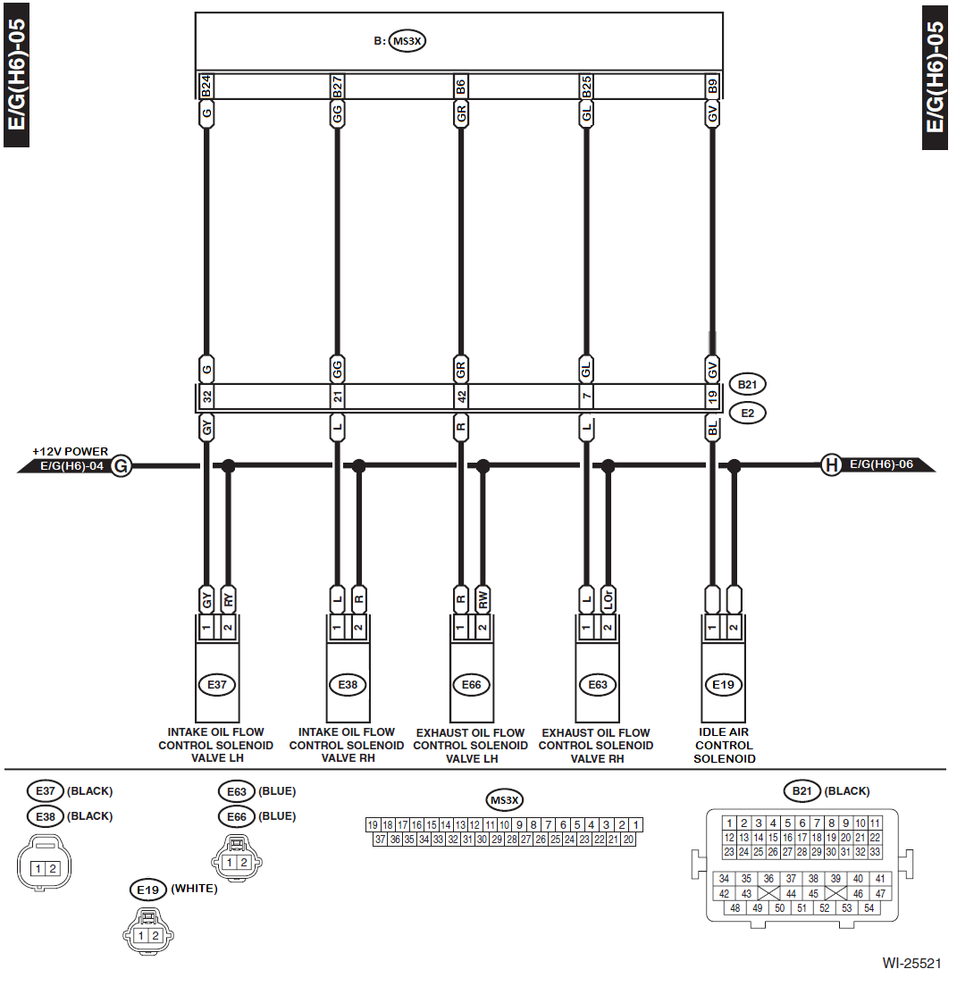

rnellums   I got a bit distracted last week while hanging out...   Mar 3 2014, 09:04 AM
76-914   I don't envy you sorting that maze out! Yo...   Mar 3 2014, 09:25 AM
rnellums   I finally got every connector flagged according to...   Mar 3 2014, 10:50 PM
76-914   Ross, is the pump controller in there? Shit, I jus...   Mar 3 2014, 11:37 PM
rnellums   Where would it have been in the car? I pulled the ...   Mar 3 2014, 11:38 PM
904svo   The fuel pump controller is located in the trunk, ...   Mar 4 2014, 08:18 AM
rnellums   The fuel pump controller is located in the trunk,...   Mar 4 2014, 08:47 AM
scotty b   Also if it helps you or anyone else, I have factor...   Mar 4 2014, 09:13 AM
76-914   That looks like the sch from an Outback. If so it ...   Mar 4 2014, 09:47 AM
rnellums   That looks like the sch from an Outback. If so it...   Mar 4 2014, 11:47 AM
76-914   That looks like the sch from an Outback. If so i...   Mar 4 2014, 05:19 PM
rnellums   My mistake. I saw the hatchback lid and.....duh. ...   Mar 4 2014, 10:43 PM
76-914   My mistake. I saw the hatchback lid and.....duh....   Mar 5 2014, 05:32 PM
Chris H.   On the radiator setup, you might want to look at P...   Mar 4 2014, 04:52 PM
scotty b   On the radiator setup, you might want to look at ...   Mar 4 2014, 07:48 PM
rnellums   On the radiator setup, you might want to look at ...   Mar 4 2014, 10:48 PM
Andyrew   On the radiator setup, you might want to look at ...   Mar 4 2014, 11:02 PM
