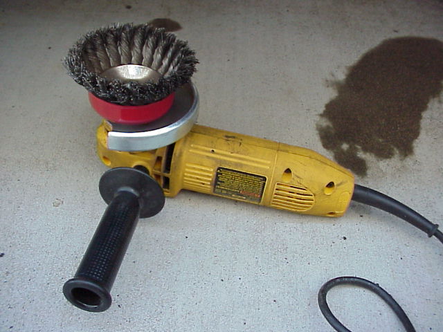

What else am I going to need? I figure I'll need an air wrench and I want whatever kind of tool that Gint was using (pic attached) is that a grinder with a wire-cup brush? Looks like an electric actually... can I just run out and get one of those?

I just bought a DeWalt 4.5 in grinder that looks like that at Lowe's for $79.
As far as air tools goes, I don't think you'll get the grunt out of an air powered grinder. Keep that one electric.

That pic is a 4" electric grinder with a HEAVY 4" cup brush on it instead of a grinding disk. Both are readily available and it will have sufficient torque (much better than a die grinder for example) for serious wire wheel work.

What's the longevity of the brush?

Hey gint, how much pressure do you use?
Uh..., fer what exactly? 4" grinder? Works awesome for removing seam sealer. Push a tad to moderate will get the job done. That 4" HEAVY cup brush is bullet proof. It's made of some extremely heavy gauge wire.

You guys are great! Thanks for all the information. I have some thinking to do now. I think i'll get the electric grinder do remove the undercoating and such, then the 3M pads for the paint/ small rust.
