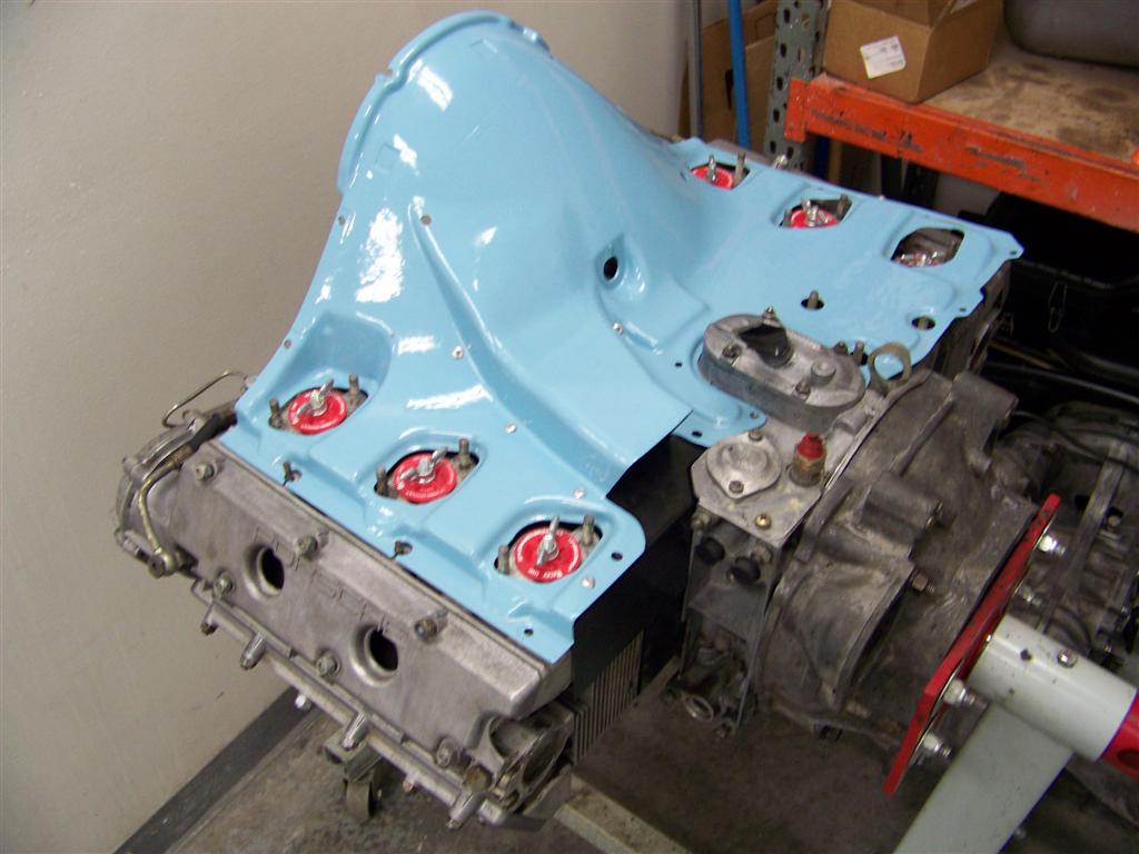

Anyone out there care to watch me take apart (and hopefully put
back together) a 3.0? I can't start at the beginning because I picked
it up from a shop in this condition. Well actually it was alot uglier.
Years of oil leaks had baked on to nearly every inch.

PanelBilly   Pulled off the covers today. Not sure where to...   Oct 9 2011, 09:45 PM
PanelBilly   These came off easy enough and the glides that t...   Oct 9 2011, 09:47 PM
PanelBilly   I'm going to try to keep track of what part ...   Oct 9 2011, 09:49 PM

PanelBilly   I'd post more pictures, but I don't even k...   Oct 9 2011, 09:51 PM
