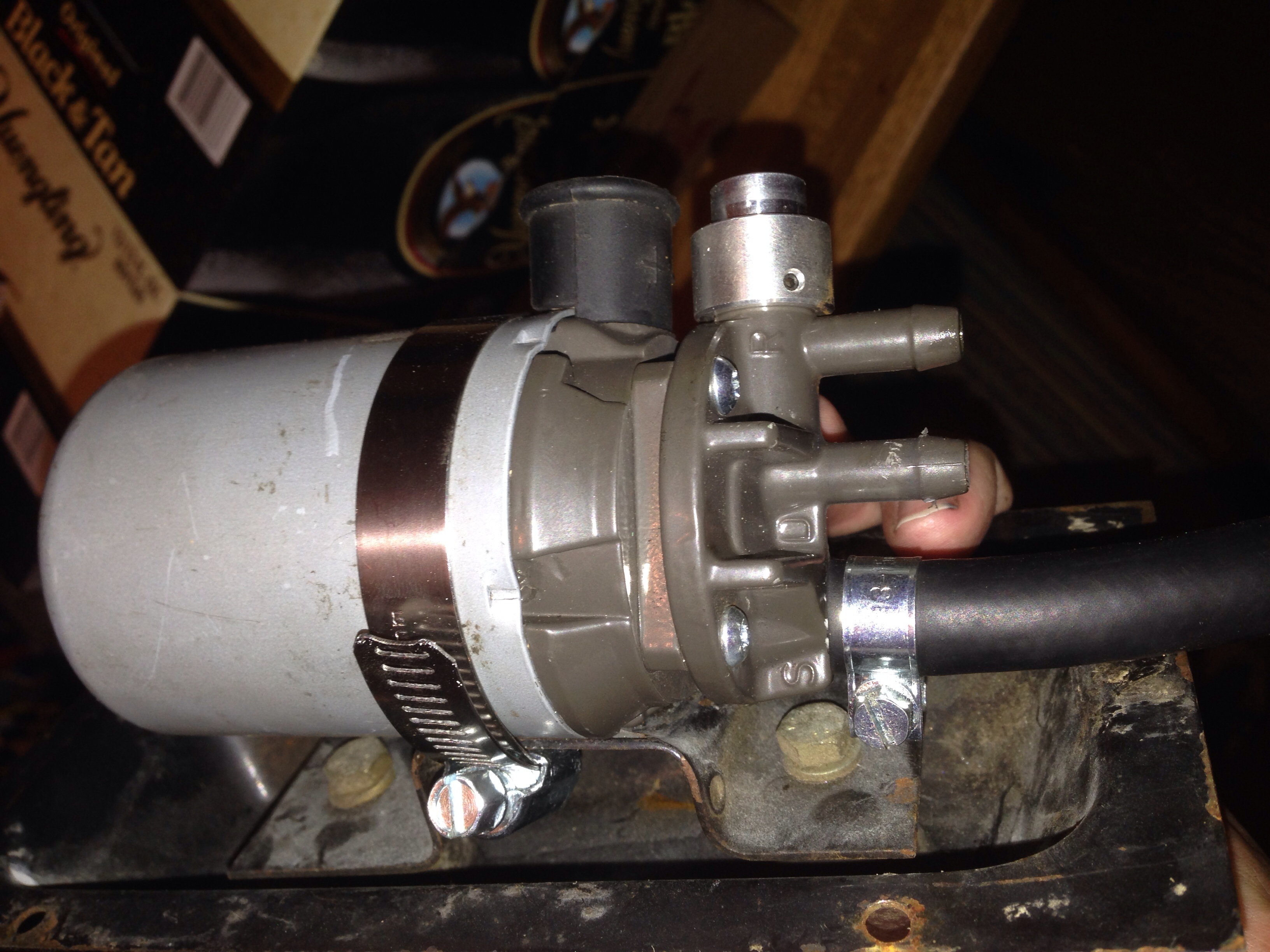

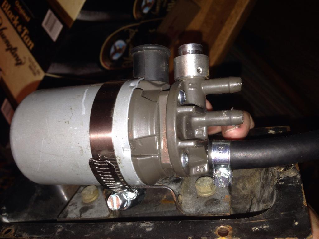

So, fuel pump question. Bob and Mark puzzled over this for an hour with my Haynes and a tablet online.
So the line from the tank is clear (has a hose and filter on it). Do we run the return line back to the pump? Or should that go direct to the gas tank? This pump is in the front of the car, not in the engine bay.
Zach
ChrisFoley
post Feb 22 2014, 06:05 PM
Post #179
I am Tangerine Racing
Posts: 8,032
Joined: 29-January 03
From: Bolton, CT
Member No.: 209
S connects to the filter
D connects to the tunnel
R connects to the wye
McMark
post Feb 22 2014, 06:08 PM
Post #180
914 Freak!
Posts: 20,180
Joined: 13-March 03
From: Grand Rapids, MI
Member No.: 419
(IMG:style_emoticons/default/agree.gif) with Chris.
S - Suction/Supply from the tank.
D - Druck(Pressure) goes to the engine.
R - Return: this is a bleed off in case the D port is over pressurized. Connect this with the return line from the engine and the return port in the tank. You need a Tee or 'Y' connection to hook the three lines together.
