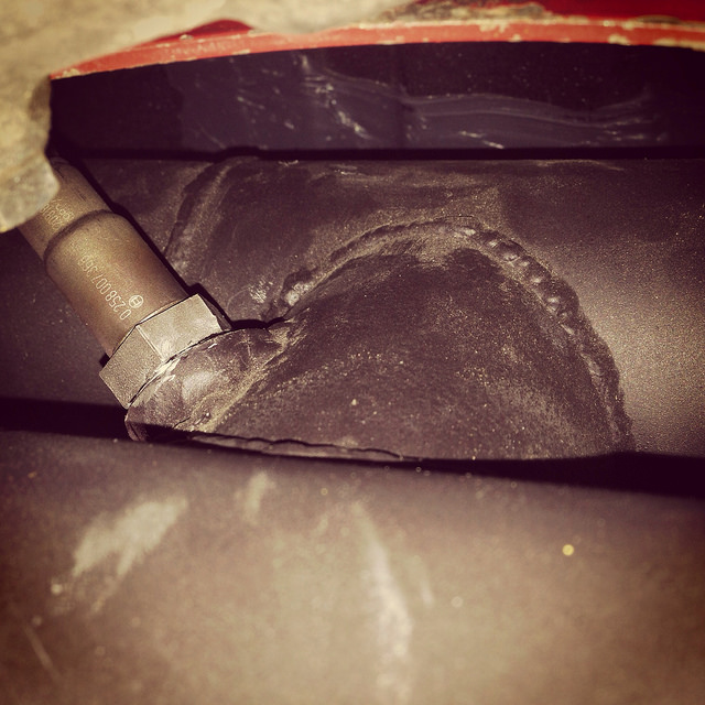

VaccaRabite
post Apr 9 2014, 06:58 PM
Post #197
En Garde!
Posts: 13,915
Joined: 15-December 03
From: Dallastown, PA
Member No.: 1,435
Had a really productive afternoon. Almost felt like I was back at the University again.
I got cut loose from work at 2:15 today by surprise when a training class ended early, and the one meeting I promised my boss I'd call into got rescheduled! Got home with 2 hours before the kids/wife would get home.

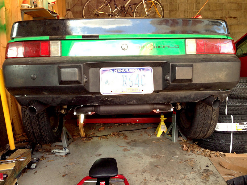

I made use of my time by getting the exhaust on my 914.
First I checked the torque on the CVs and then safety wired them.
Then the SS exchangers and TRIAD went up. Lots of fiddling to get it even, and no way to check for leaks right now but I think I have it pretty good. And the Triad looks awesome.
(IMG:http://www.914world.com/bbs2/uploads_offsite/farm4.staticflickr.com-1435-1397091511.1.jpg)
And got the o2 sniffer in (was kinda a bitch to get a wrench on it...)
(IMG:http://www.914world.com/bbs2/uploads_offsite/farm8.staticflickr.com-1435-1397091512.2.jpg)
I was getting the starter wired back up when wife and children came up the driveway and I had to stop. All I need to do before dropping the car back to the pavement (so I can raise the front end...) is tighten the leads on the starter, and check nuts and bolts. Maybe another 30 minutes of work (including lowering the car back down.)
Zach
