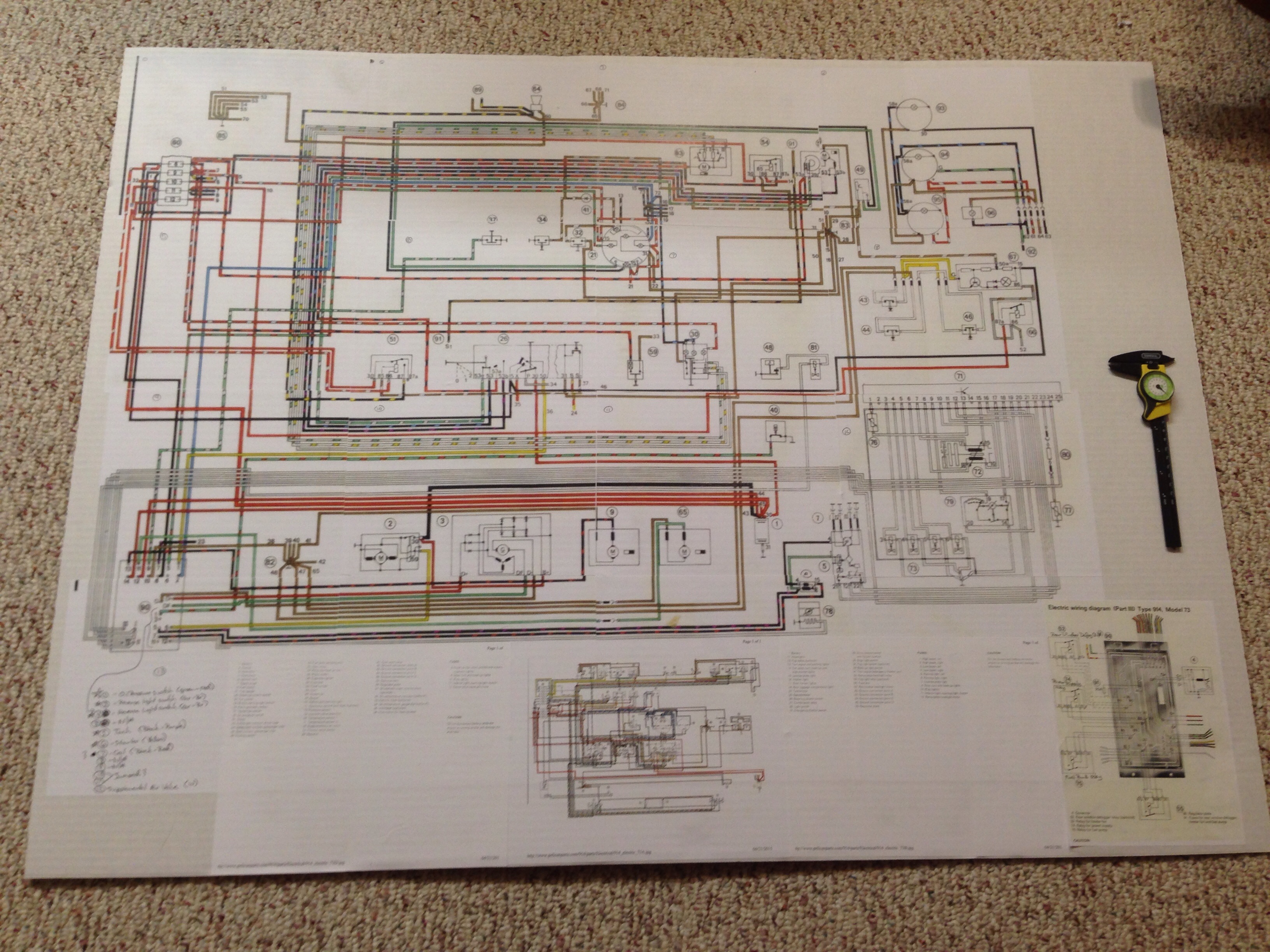

Since I will be doing some rewiring, I made something big.
All the 914 wire diagrams in one wall poster.
Big one is the engine side, since that will be my main target.
Little copy of the firewall forward.
Detail of the relay board - my likely nemesis.
And the ledgend for all three charts.
Calipers are in there for scale reference. It's 48x36 inches.
That should help a bit.
Zach
