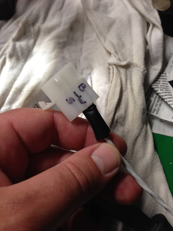

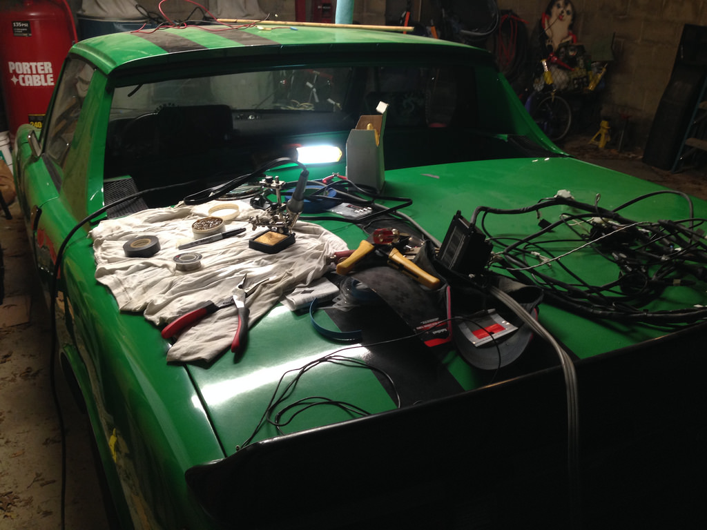

Work complete.
(IMG:http://www.914world.com/bbs2/uploads_offsite/farm6.staticflickr.com-1435-1431143487.1.jpg)
(IMG:http://www.914world.com/bbs2/uploads_offsite/farm9.staticflickr.com-1435-1431143488.2.jpg)
(IMG:http://www.914world.com/bbs2/uploads_offsite/farm6.staticflickr.com-1435-1431143489.3.jpg)
Got a lot done today, in my own slow way. Both Molex plug ends are in and the crankfire wires are connected again. So tired I can barely see straight. Goodnight.

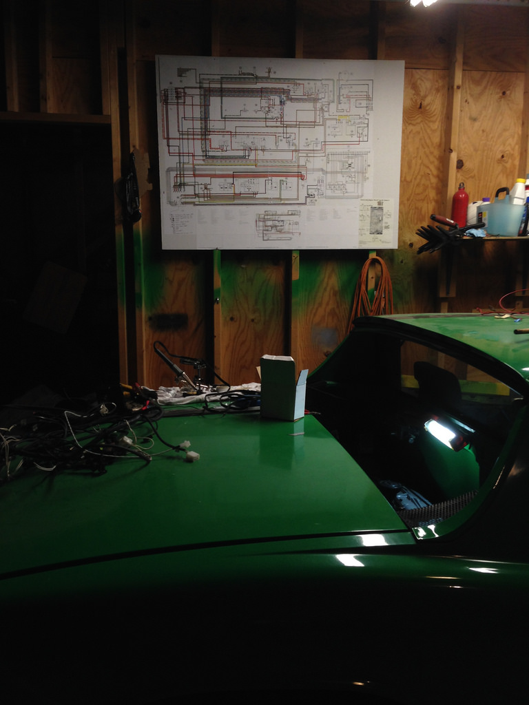

I love your poster board! My schematic pages are all taped together and rolled up like the Dead Sea Scrolls. Good luck on this (IMG:style_emoticons/default/smile.gif)
