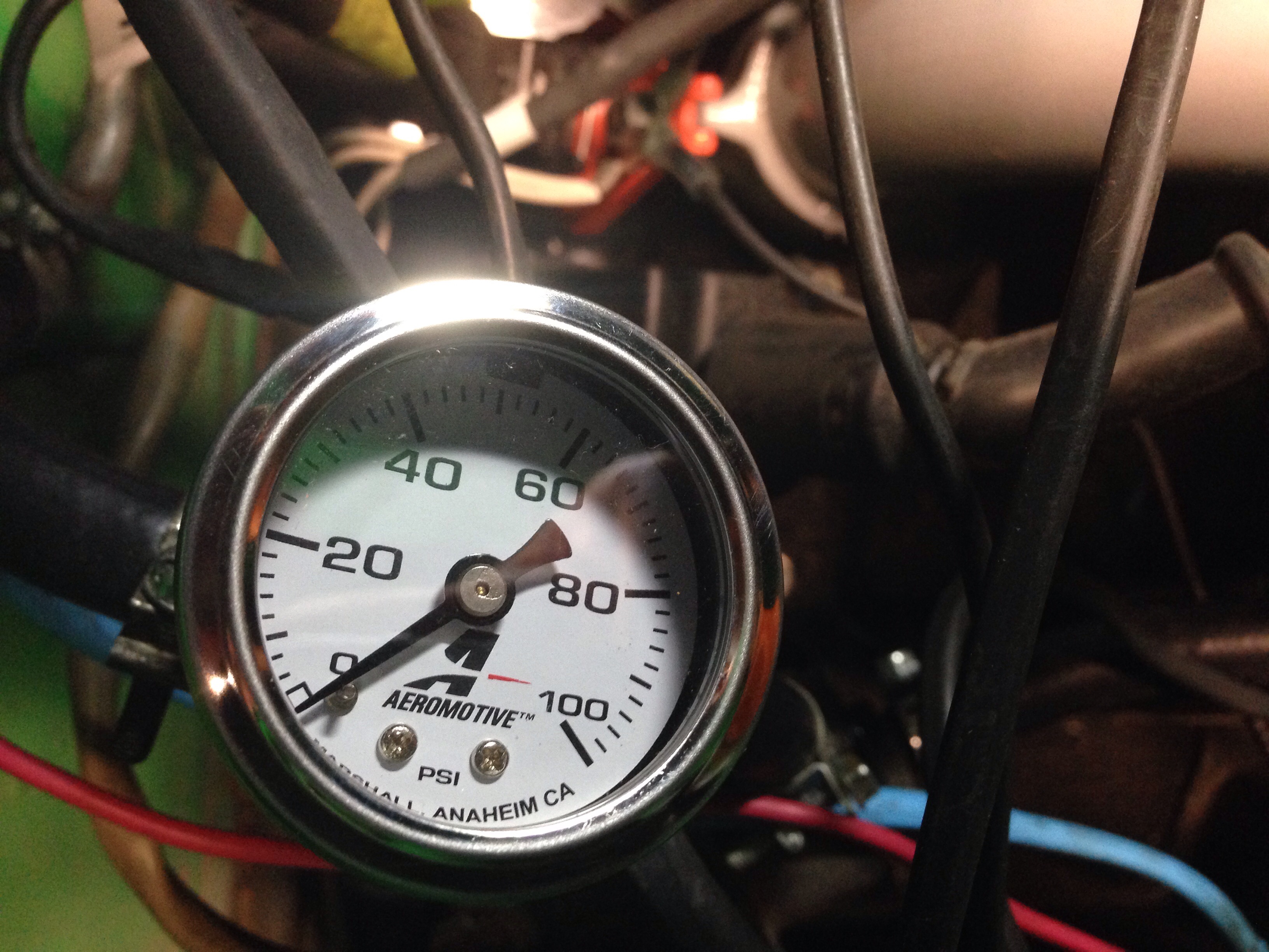

We'll one mystery solved. Won't fire if it's not getting any fuel.
Guessing a kinked line under the gas tank somewhere.
Glad I finally plumbed in a pressure gauge.

It. Ran. Today.
Doug came over today. We fixed some kinks under the gas tank.
Found some leaks. Fixed them.
Found that the fuel lines in the engine bay were plumbed backwards at the pressure regulator. Fixed that.
Primed it a few times (well, Doug primed it while I watched the fuel pressure gauge at the fuel rail).
And it fired up.
So.
Fuel pressure is low. Only 20 pounds. I need to adjust the pressure regulator.
I need to seriously do something about the rats nest of wires in the engine bay.
I need to get a new throttle cable and hook it up so I can start the car from inside the car, and not stand by the engine with my hand on the throttle.
And then I need to actually tune it.
But it is getting CLOSE!
