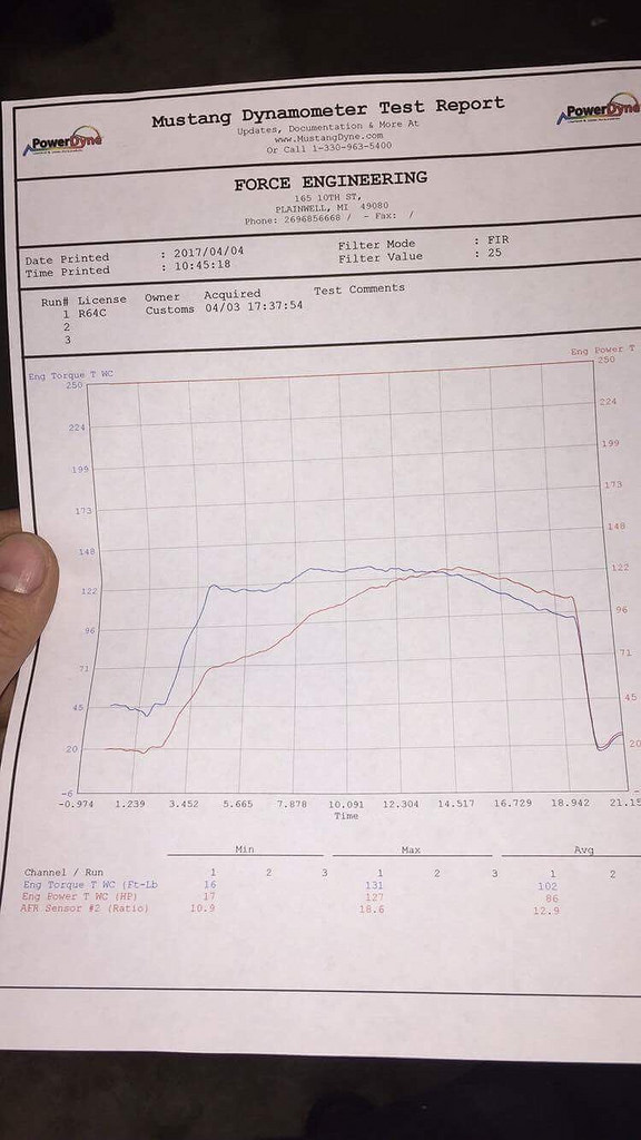

(IMG:http://www.914world.com/bbs2/uploads_offsite/c2.staticflickr.com-1435-1491329172.1.jpg)
Got this from Mark this morning.
Assuming 18% drive train loss, engine is making 149HP at the crank. Not bad for a 2056, and a lot more then I expected.
I don't have an RPM plot yet. Still the torque goes up FAST and then gets flat. I like it.
Still some weirdness to be sorted. It's loosing fuel pressure at WOT (probably a kink somewhere) and there is an electric issue that may be the engine relay board failing. But, man, this is progress. I'm pleased.

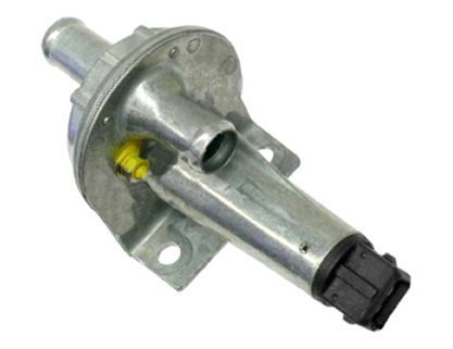

I'm pretty sure the feedback/run-on issue is a failing alternator. But I changed the wiring to an alternate, but still correct setup.
The car also needs a warmup idle air bypass. The 1.8 style should work well. It's a little hard to start and warmup right now, but I tested it was a controlled air leak (a long hose from the intake manifold to my hand!) and was able to make it idle really nicely from cold.
(IMG:http://www.914world.com/bbs2/uploads_offsite/www.autohausaz.com-419-1492093874.1.jpg)
Also, the fuel lines need to be more comfortably routed.

I've got one of those in my parts stash. How will it need to be wired in?

Switched power. That's the beauty of both styles of factory AAR, they're dumb. There's an internal opening, that simply closes more and more the longer power is applied. So you just have to have the power turn on when the car's on and it'll do the rest.
Confirm that yours is operational before installing it. Look down the port, see the hole, hook the wires to power and ground (either way, AFAIK) and wait and watch. If the hole starts closing off, it's good to go. I usually spray a bit of lubrication in both sides of the port to combat sticking.
For final installation plumb one side of the port to the plenum, and the other side to the air cleaner. Run the ground to the engine case somewhere, and run the power to the new fuse panel (piggyback on fuse #6, which is also the O2 sensor).
