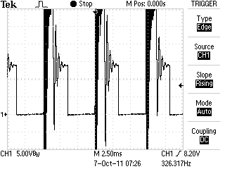

Valy   Just for reference, this is what your bad points/c...   Oct 15 2011, 02:07 AM
914Bryan   Awesome info guys! Thanks!   Oct 15 2011, 05:42 PM
Tom   Valy, That is some bad switch bounce! The...   Oct 15 2011, 07:40 PM

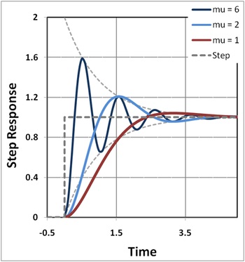

Spoke   There's 2 basic reasons the tach bounces: 1) ...   Oct 16 2011, 10:20 AM
Valy   My dear friend, you solved a symptom, not the...   Oct 16 2011, 10:34 PM
Spoke   My dear friend, you solved a symptom, not th...   Oct 17 2011, 07:02 AM
Valy   [quote name='Valy' post='1556077' date='Oct 17 20...   Oct 18 2011, 07:26 PM
Spoke   The problem is that the bouncing fools the tach t...   Oct 19 2011, 04:40 AM

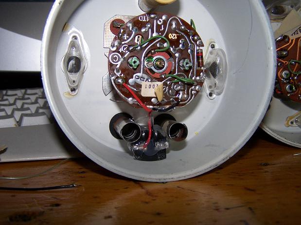

Spoke   My Tach jumps also. I don't remember which c...   Oct 16 2011, 07:05 PM
Spoke   I don't suppose you could point out the cap t...   Oct 16 2011, 07:01 PM
